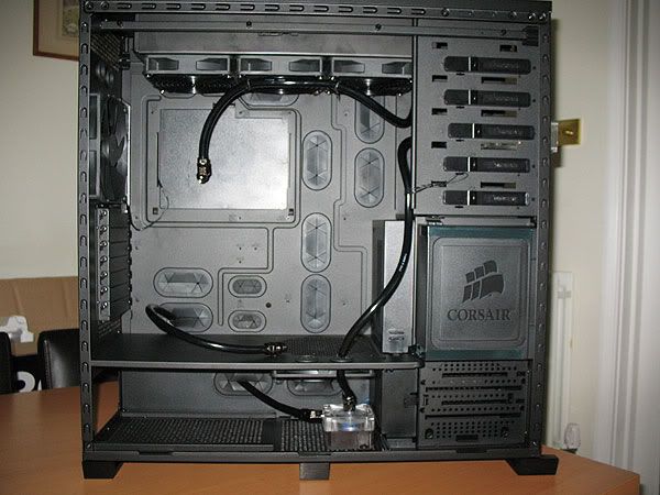

But looking to build a PC for a mate to run 3 monitors @ regular HD resolutions for gaming modern and future tiitles.
We already have a case with Custom watercooling, so will be utilize that, we may or may not put GPU under water but certainly the CPU.

No that's mine ... this is for a mate to replace his aging system.
I can't recall off the top of my head, but its got plenty of room :)
Do you know what fittings the cooling uses? i.e socket 1150/55/56/51 as they all the same fitting.
Its an old AMD system so I will likely need adaptors at least. We will likely get a new WB for the CPU anyways ;)
The case is a Corsair something !
