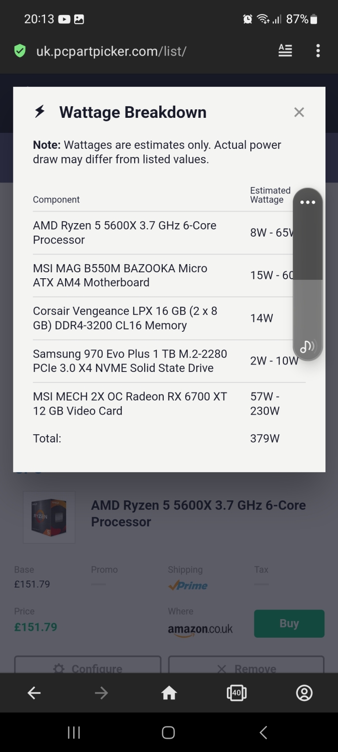

Łukaszu, it looks like your PSU is the problem. It's rated as 750W but in reality it produces no more than 350W and your setup require 392 Watts.

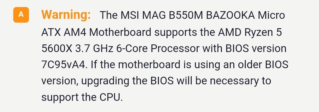

5600X is supported from bios 7C95vA7, there is a chance you are on a earlier version. (your board has a bios flash button so you don't need another CPU)

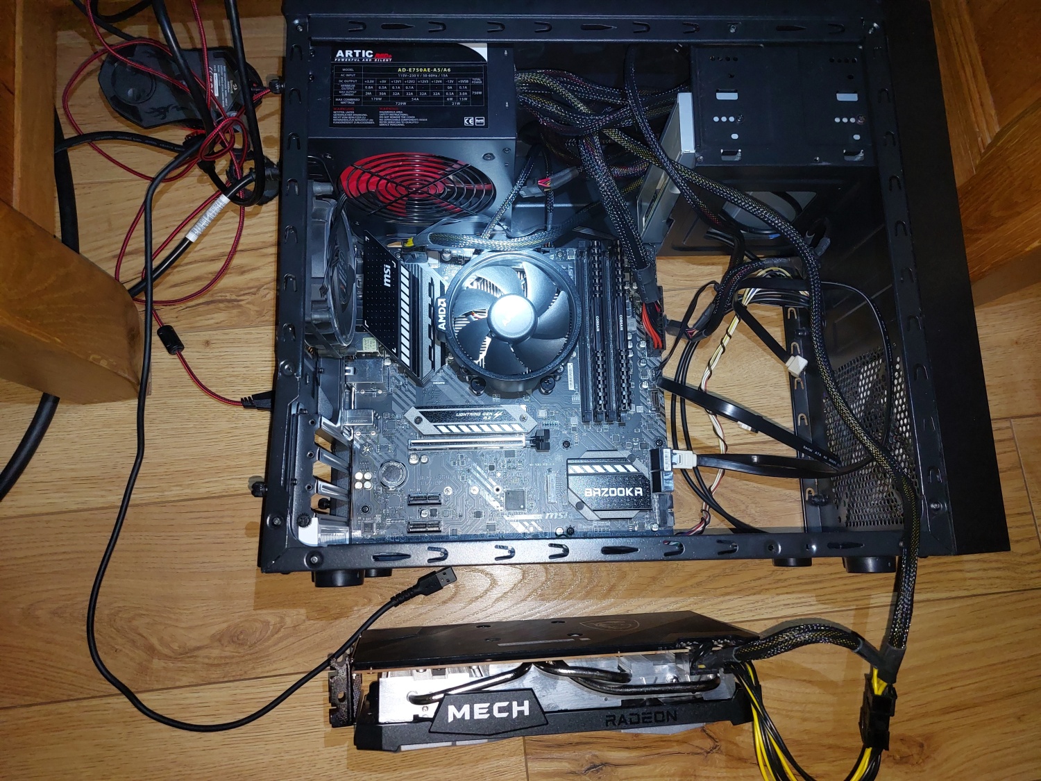

Regarding the photo of your setup, you are plugging the GPU into the motherboard and not trying to run it outside of the case? ;)
Not to be taking the **** but that pic clearly shows the card NOT plugged into the mobo
You ARE plugging the card into the mobo when testing it right?
EDIT Beaten by freddie64 like a ginger stepkid :cry:
