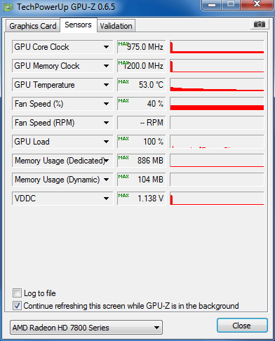

http://gpuz.techpowerup.com/12/10/31/7bq.png
EDIT- Ok found it and linked it, so i dunno if this is a bad score for my card but ive seen people with over double with better cards lol

So the voltage is 1.138 at load so up it to 1.143?
