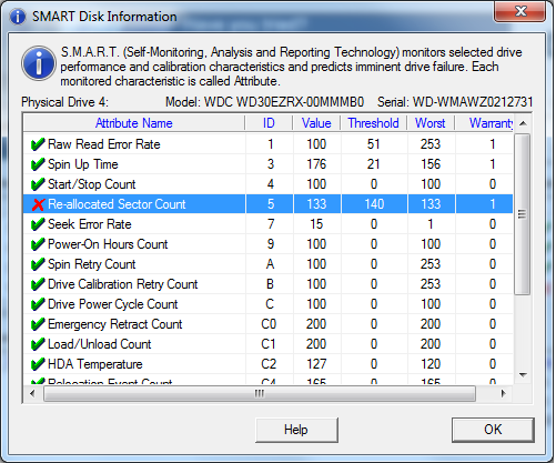

Also run a program like Crystal Disk info or HD tune and look at the smart info.
Also just to see if it will take any formating try to make a small partition say 100 GB. If that works maybe more additional partitions 500 GB a time. If it works up to a certain position it will be pretty conclusively a faulty drive.
It failed the SMART test, does this mean this is an ex-HDD?
