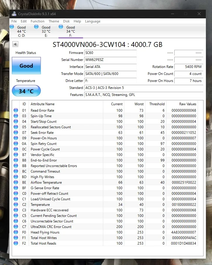

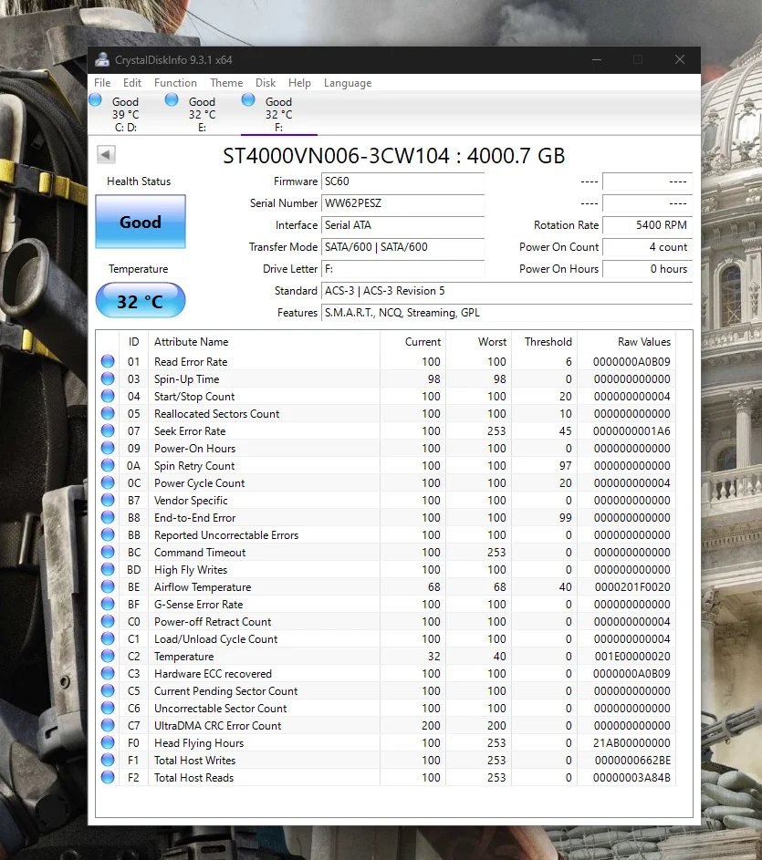

Right, HDD connected and powered on without any issues.
Current stats are, does this look ok?

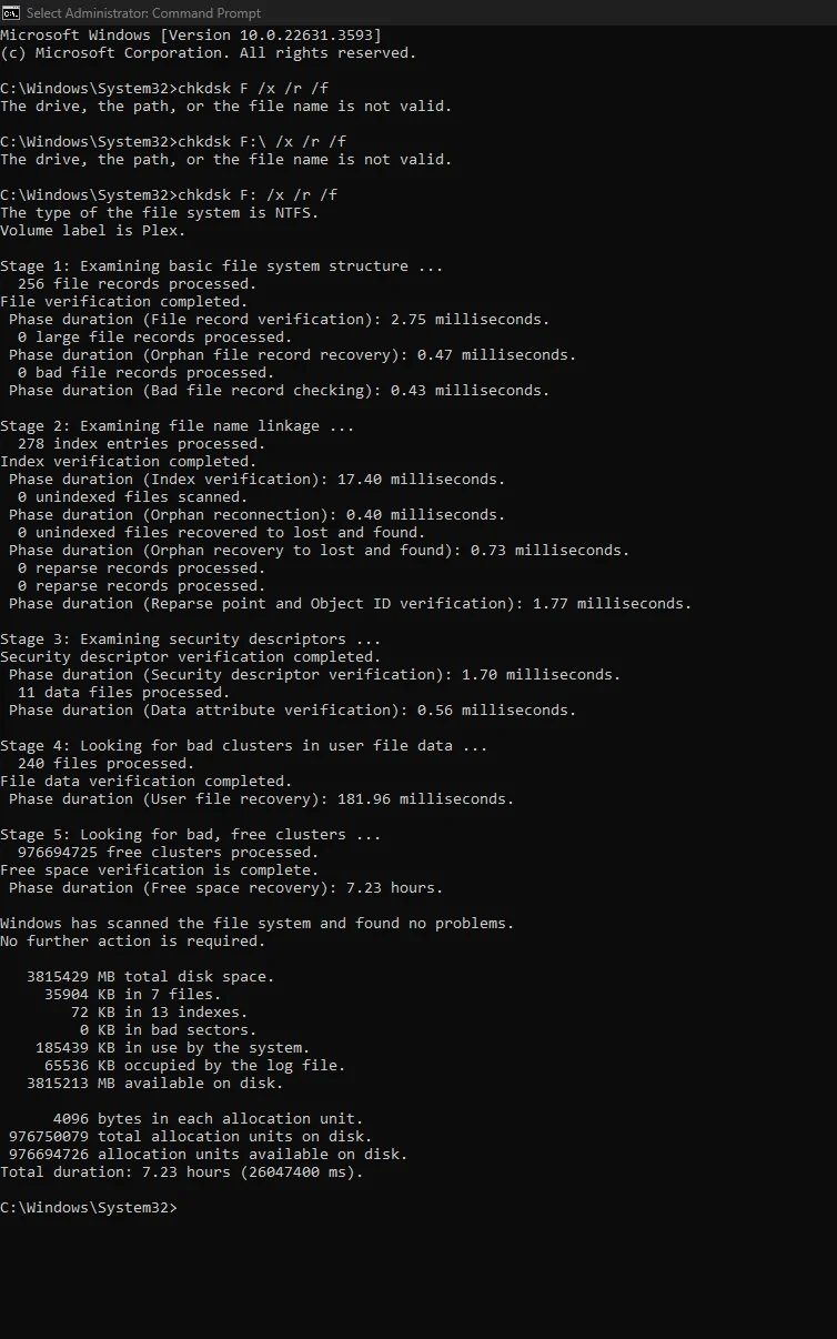

Now running the chkdsk /x /r /f command on it, ETA 5h 41 mins
