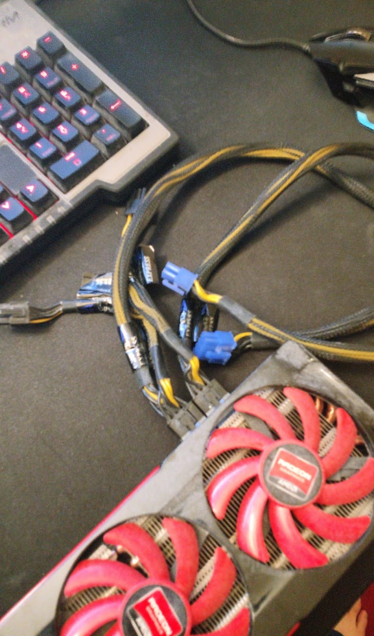

https://~ibb.co~/1JW5pJw
https://~ibb.co~/WnDqcSX
https://~ibb.co~/2yLCz89
https://~ibb.co~/Ycm9prN
https://~ibb.co~/5jZ4ffB
https://~ibb.co~/KNdZy2y
https://~ibb.co~/DL24QsH
https://~ibb.co~/Vj9THmM
Hope that helps, ran prime for a few hours with no issues, 1 error in memtest which I’ve uploaded a pic of, yet furmark is a no go
