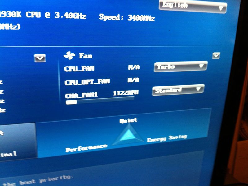

The only options I have for the fans is normal, manual or turbo but the CPU fan isn't detected at all so it just says N/A
You can press the front of the H100 unit which is supposed to increase the fan RPM but this doesn't appear to do anything?

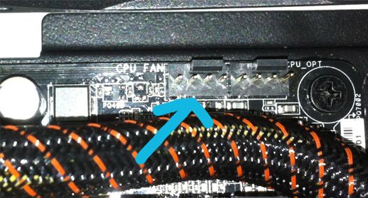

Ok just to show the current setup, just incase I'm missing something glaringly obvious which is entirely possible :)

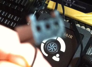

This is the first cable that is coming out of the main H100 block.
This is plugged into here:

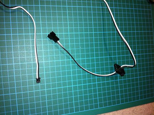

The second cable coming from the H100 is this:

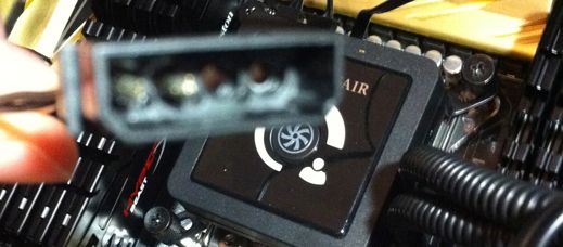

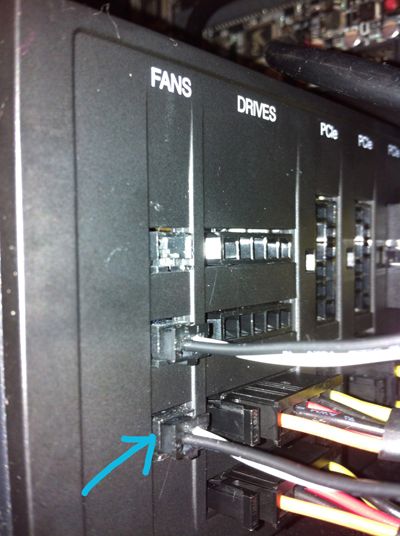

Which i have connected to the power supply
Using this adapter cable

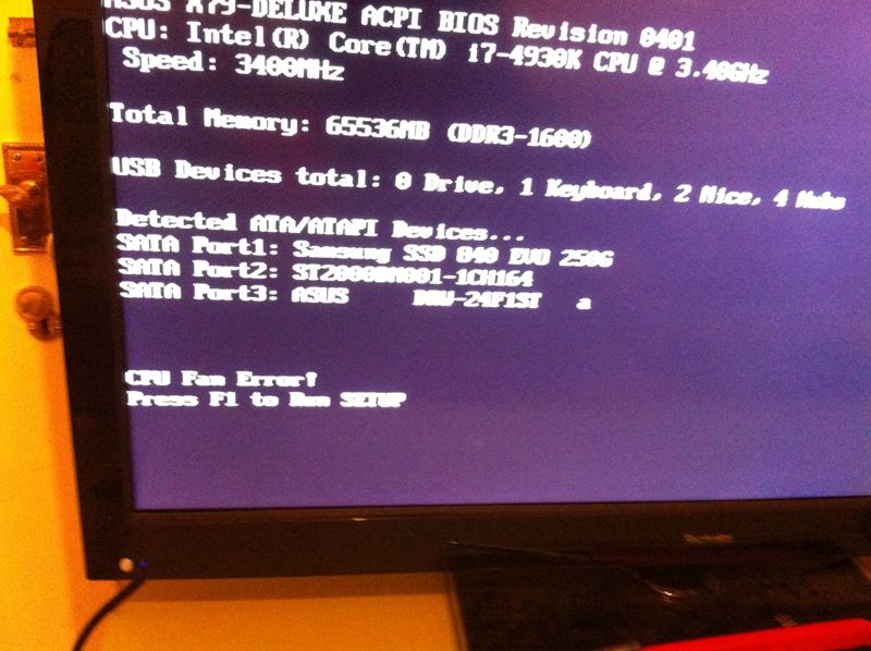

On boot....
BIOS
