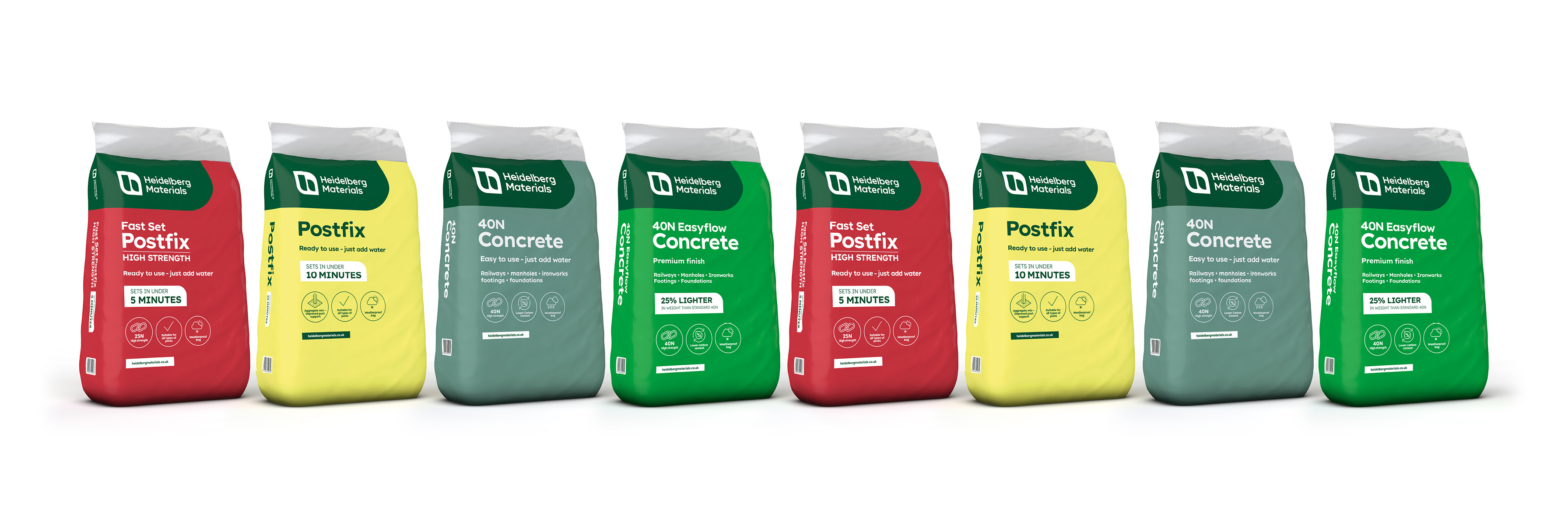

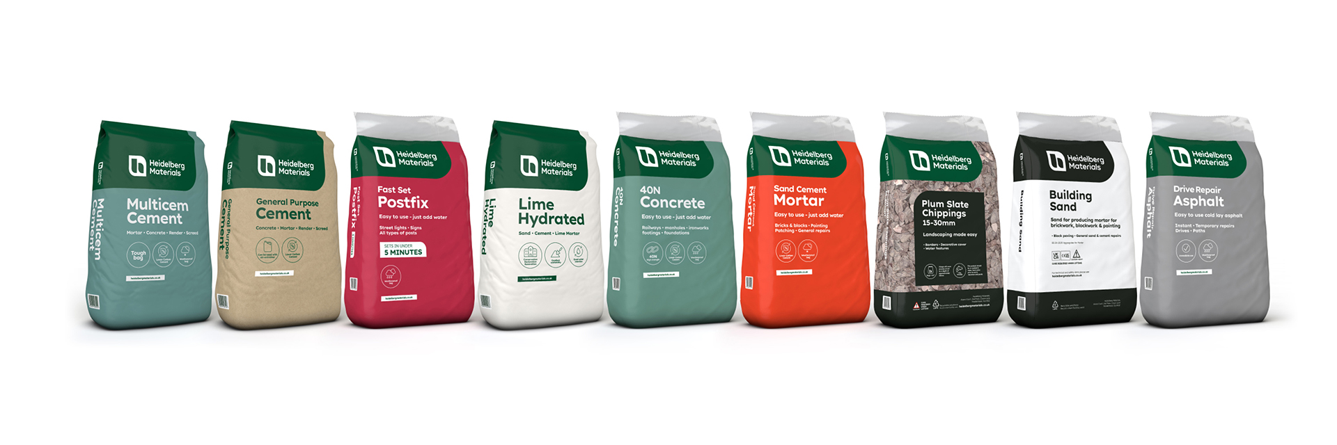

Re the postcrete stuff, the Hanson datasheet says
Hanson PostFix is a simple to use fast-setting concrete mix for fixing posts in the ground.
It requires no pre-mixing before use. Hanson Postfix contains Portland cement and special additives together with sharp sand and 10mm gavel.
TLDR your builder seems to be being a bit lazy and using the wrong product. It will hopefully turn out to be ok but the manufacturer (Hanson) really needs to confirm it complies with the requirements of 2E2.b.i) in the building regulations (assuming the ground there is not aggressive or needing special enhanced properties).
what the concrete needs to do:
Approved Document A (AD-A) of the building regs (structure) says:
2E2 The following design provisions relate to foundations:
a. the foundations should be situated centrally under the wall;
b. for foundations in chemically aggressive soil conditions guidance in BS 8500-1 and BRE Special Digest 1 should be followed.
In non-aggressive soils, concrete should be composed of Portland cement to BS EN 197-1 and -2 and fine and coarse aggregate conforming to BS EN 12620 and the mix should comply with one of the following recommendations:
i. in proportion of 50kg of Portland cement to not more than 200kg (0.1m3) of fine aggregate and 400kg (0.2m3) of coarse aggregate; or​
ii. grade ST2 or grade GEN I concrete to BS 8500-2;​
Hanson's bagged product for bi) seems to be their Multipurpose concrete, and for bii) their 40N concrete though this far exceeds a GEN1 and might even comply with less severe cases of aggressive ground. I wouldn't be surprised if their Multipurpose would also achieve bii) in many cases, though they don't declare this directly.
So how does this compare to what they have actually used?
The data sheet states Postfix is intended for fences etc so the builder is using it contrary to manufacturer's guidance. Naughty unless they've advised him otherwise.
The data sheet refers to
Hanson Postfix contains Portland cement and special additives together with sharp sand and 10mm gavel [sic].
This mix may be enough to tick the requirement of item 2E2.b.i) provided the ratios comply (the mix proportions are not listed in the data sheet).
There is no statement on designated or prescribed concrete classes. (GEN1/ST2 respectively) so it presumably does not meet 2E2.b.ii
The data sheet does list a >10N/mm2 compressive 28day strength which would be similar to a GEN1 strength so that's encouraging.
Only Hanson can confirm it complies with the regs I'm afraid as they don't publish enough information on it online.

Tbh for the level of building required, I'd prefer postcrete. At least you know exactly where you stand w.r.t mix and quality!
Which pre-bagged concrete often has aggregate in it? I guess the simple answer is postcrete.
They've presumably used postcrete because it's cheaper and sets quicker but it's not what they should use.
All concrete has aggregate in it.
I think some people are confusing cement and concrete here.
If postmix complied with building regs then they’d be publishing as such and charging accordingly.
