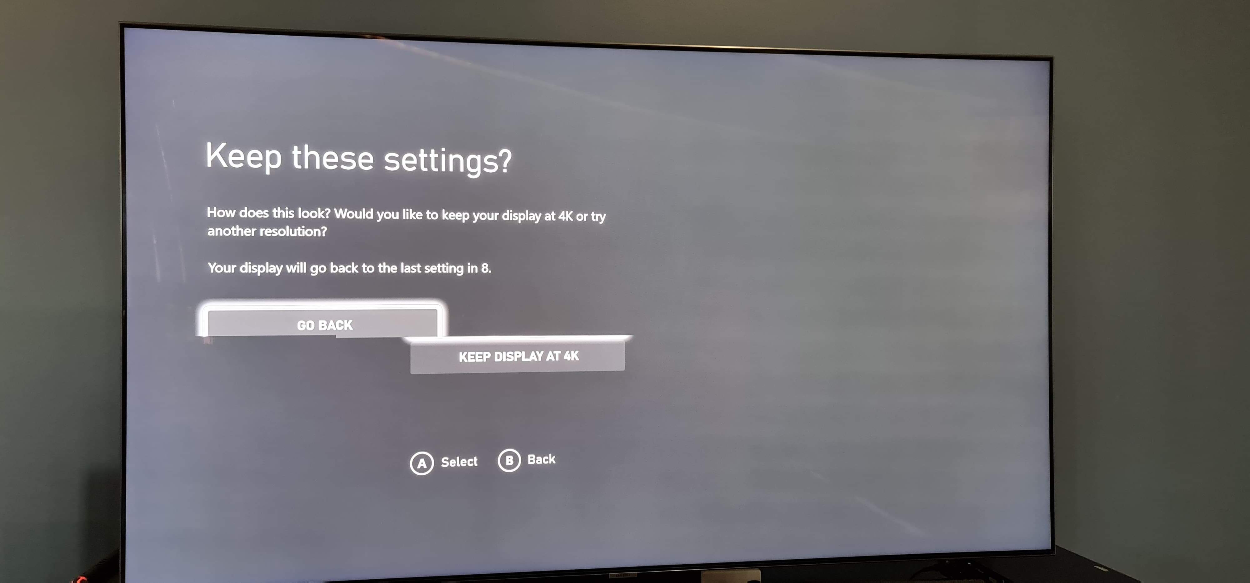

There's likely to be issues with the new consoles and TVs with this latest gen and I thought perhaps a dedicated thread on the topic might be a good idea to get issues communally looked at.
First up: 120FPS / VRR support
It seems that there's possible issues with the Samsung Q90T / Q95T sets and the net gen consoles. These pics aren't mine, but belongs to a fella I've chatted to about the TV in question.
I get my X soon and have the 95T, and will add my findings to this too.
Both SX and PS5 seeminly have bandwidth related issues on the HDMI 2.1 port.
EDIT: Solution
Firmware fix: https://www.samsung.com/au/support/model/QA55Q95TAWXXY/
Symptoms: Ori and the will of the whisps running in HDR, 4k, 120FPS

The fella sent me some more pics, and there are pics of his blacks being completely crushed too on the Q95T

Edit: Edited the OP with a solution. Turns out its a VRR related issue on the series X
