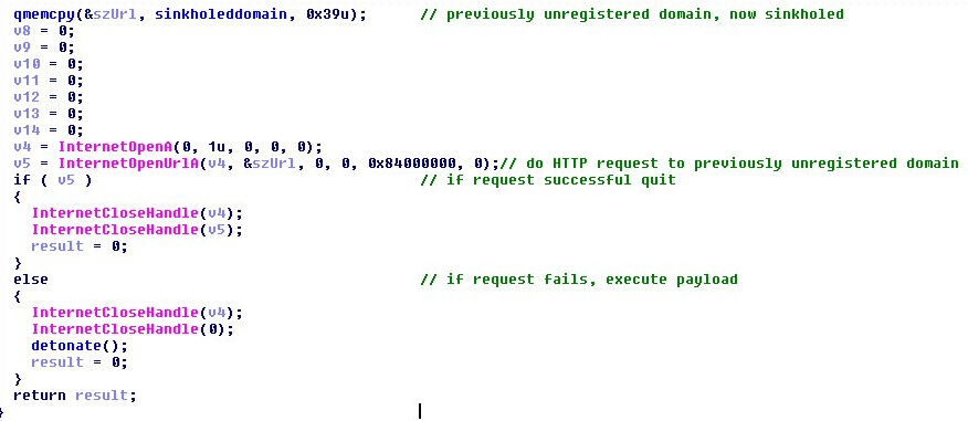

I'm curious as to the use of that domain as a killswitch - probably completely science fiction but I wonder if there could be any ulterior motive for getting people to utilise that domain either internally or registering it, etc. but I can't see one.
Not that I can think of. If they created the domain internally by just creating an entry in their DNS servers, they would just point it at some dummy content of their own if any. I think it's just a last-resort kill switch for if they lose control of it. The original creators might have put it there in case their work was stolen and re-purposed. If you're unleashing a deadly virus, it's nice to know you have the cure. ;) (Though now someone can remove it).
The reason which was suggested is that the domain is a “kill switch” in case something goes wrong, but I now believe it to be a badly thought out anti-analysis.
In certain sandbox environments traffic is intercepted by replying to all URL lookups with an IP address belonging to the sandbox rather than the real IP address the URL points to, a side effect of this is if an unregistered domain is queried it will respond as it it were registered (which should never happen).
I believe they were trying to query an intentionally unregistered domain which would appear registered in certain sandbox environments, then once they see the domain responding, they know they’re in a sandbox the malware exits to prevent further analysis. This technique isn’t unprecedented and is actually used by the Necurs trojan (they will query 5 totally random domains and if they all return the same IP, it will exit); however, because WannaCrypt used a single hardcoded domain, my registartion of it caused all infections globally to believe they were inside a sandbox and exit…thus we initially unintentionally prevented the spread and and further ransoming of computers infected with this malware. Of course now that we are aware of this, we will continue to host the domain to prevent any further infections from this sample.
Seems to be the reasoning - but anyone analysing it in a sandbox would quickly discover that and deactivate so seems more like just a way for them to run it for testing but kind of elaborate compared to a simple if statement.
EDIT: These kind of killswitches and controller domains aren't unusual in themselves but this implementation seems a bit odd - not sure if its just amateur work from script kiddies packaging it up or whether there is something more behind it.
Wonder what all the zero'd variables are for - plus would it have hurt them to name their variables after their functionality rather than just number them heh :s (EDIT: didn't check actually might just be that way due to being reverse engineered).
