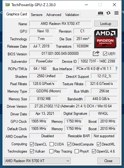

I tried ddu and install only driver in devices manager. Some drivers are better than new one but none perfect. Same with chain. I tried teo connectors going out from one chain and two separate ( I have 2 cables x 2 connectors in my PSU).
i use only metal pcie number 10. Two lower pcie are blocked by case ssd cage. I can't insert such big GPU there.
