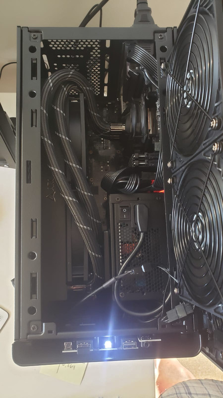

Hey all! New member here, finally worked up the nerve to join and show my Nr200. Came from a CM Q300L, loving the NR case! Please excuse my lack of cable management. Awaiting parts for custom cables.
Jeez, what a mess...

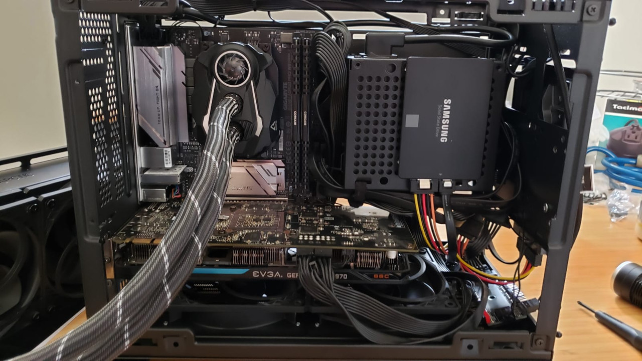

Having a 3d printer means I was able to print a few bits for putting 2.5" SSD's in the slot covers and 2x 3.5's on the side brace, wondering if anyone else has more drives in there than originally designed for and if might be able to pick up some ideas or other POV's for mods..

I agree, dont bother with 3.5", but the two 2.5" mounts are fine with nice SATA cables and nice PSU cables
