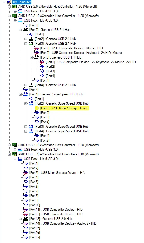

Here's the Quest plugged into my front USB3 sockets, a rear MB USB3 socket, and even a USB3 hub off a rear MB USB socket.
Note: The socket the Quest reports USB2 on is a USB 3.2 header/socket.

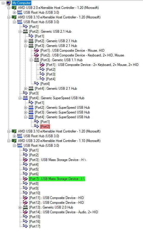

Front USB socket
Note: There is also a USB 3 hard drive enclosure plugged into that front USB socket too for testing ("Mass storage device H").
The Quest reports USB 2.

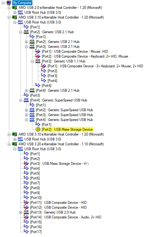

Rear USB socket
The Quest reports USB3.
Hub in Rear USB Socket
