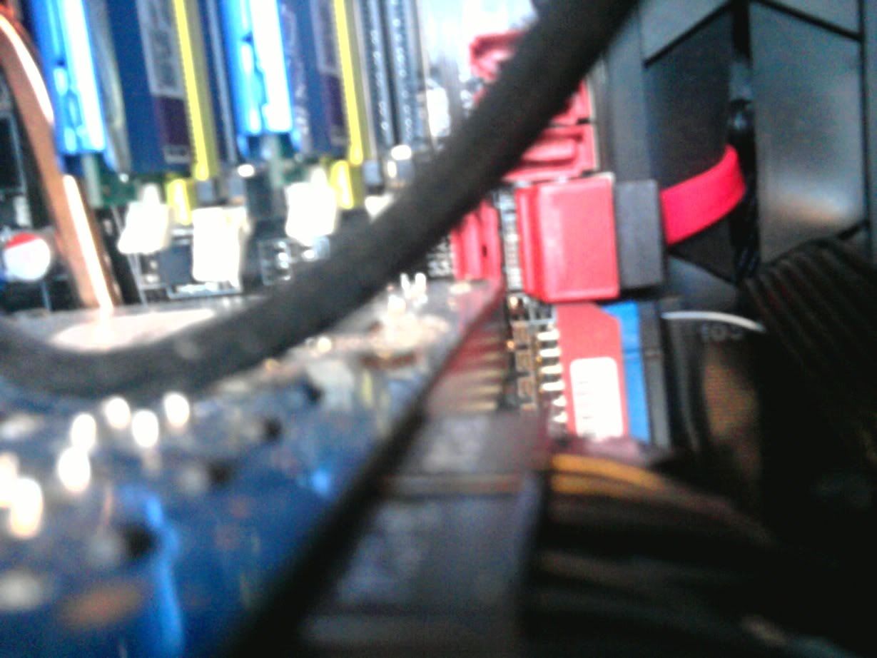

I'll take a pic of the cable I've got and put it up here. Just to make sure it's the right power cable I'm using. I got a corsair 650W (blue sticker) new so hopefully it will have a lead I can use. If not can someone post up the link to the cable on the OCUK website that I'd need to buy to get this working?
Remember it's an older gen motherboard I have - P5Q Deluxe
thanks in advance

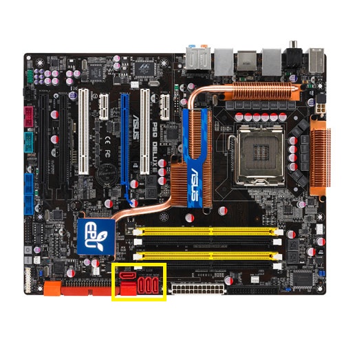

You'll need one like this to connect it to the motherboard:
Connected to one of these red SATA ports:

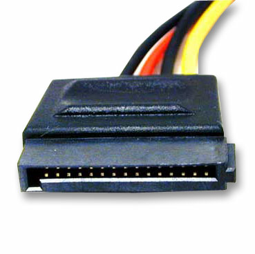

And one of these from your power supply:
Hope that helps
