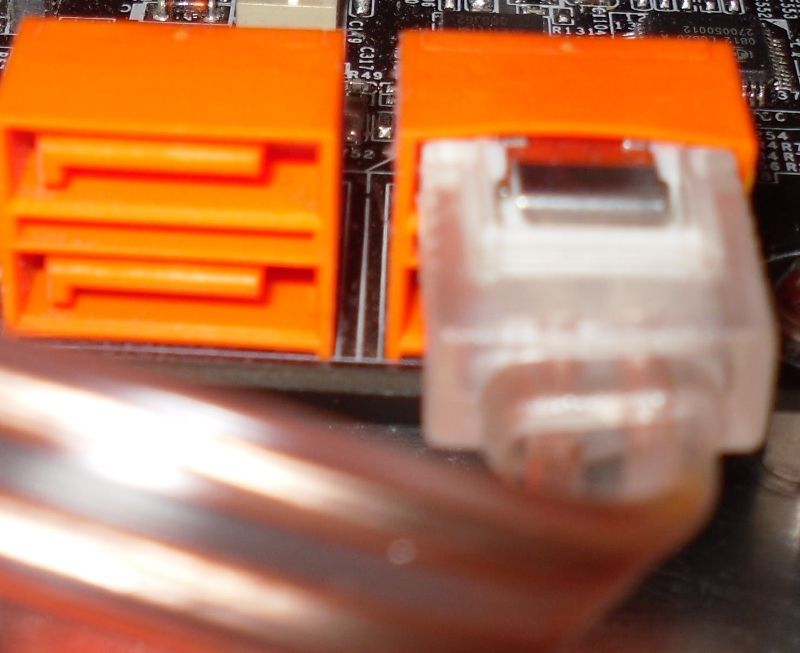

I had a similar issue that kept reoccurring around 6 monthly intervals until I replaced motherboard supplied S-ATA cable with a branded one that included latch. Even though motherboard ports didn't support latched cables.
