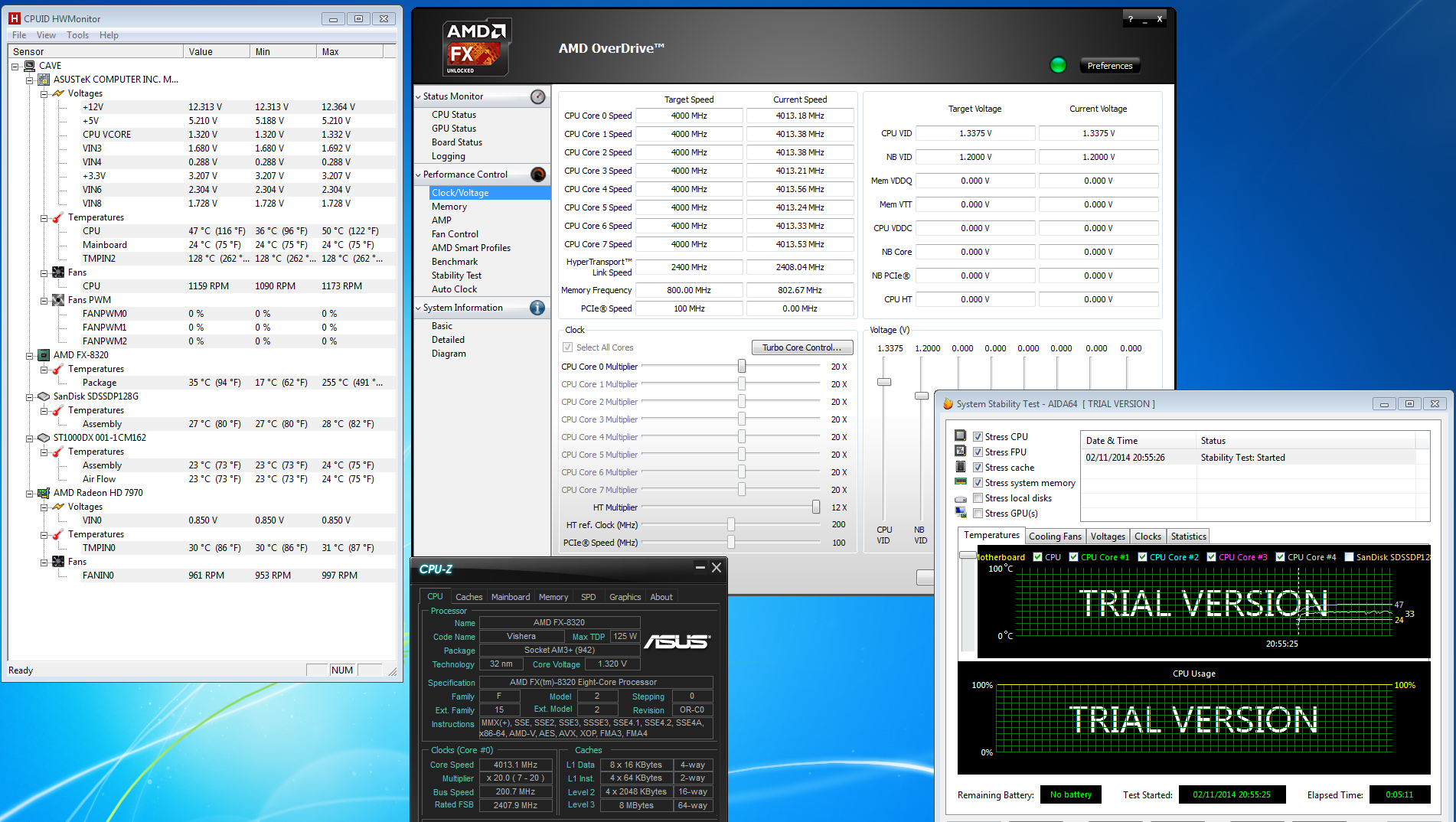

Ah OK thanks. Just got to 4.4 stable with 61 being max cpu temp, where are you getting the socket temp reading from?
I've just adjusted my fan profiles to see if I can get it to go lower as the chasis fans were running at 900 rpm whilst the cpu fan was running 1500 rpm :( I don't mind the cpu fan hitting this as it's pretty quiet anyway!

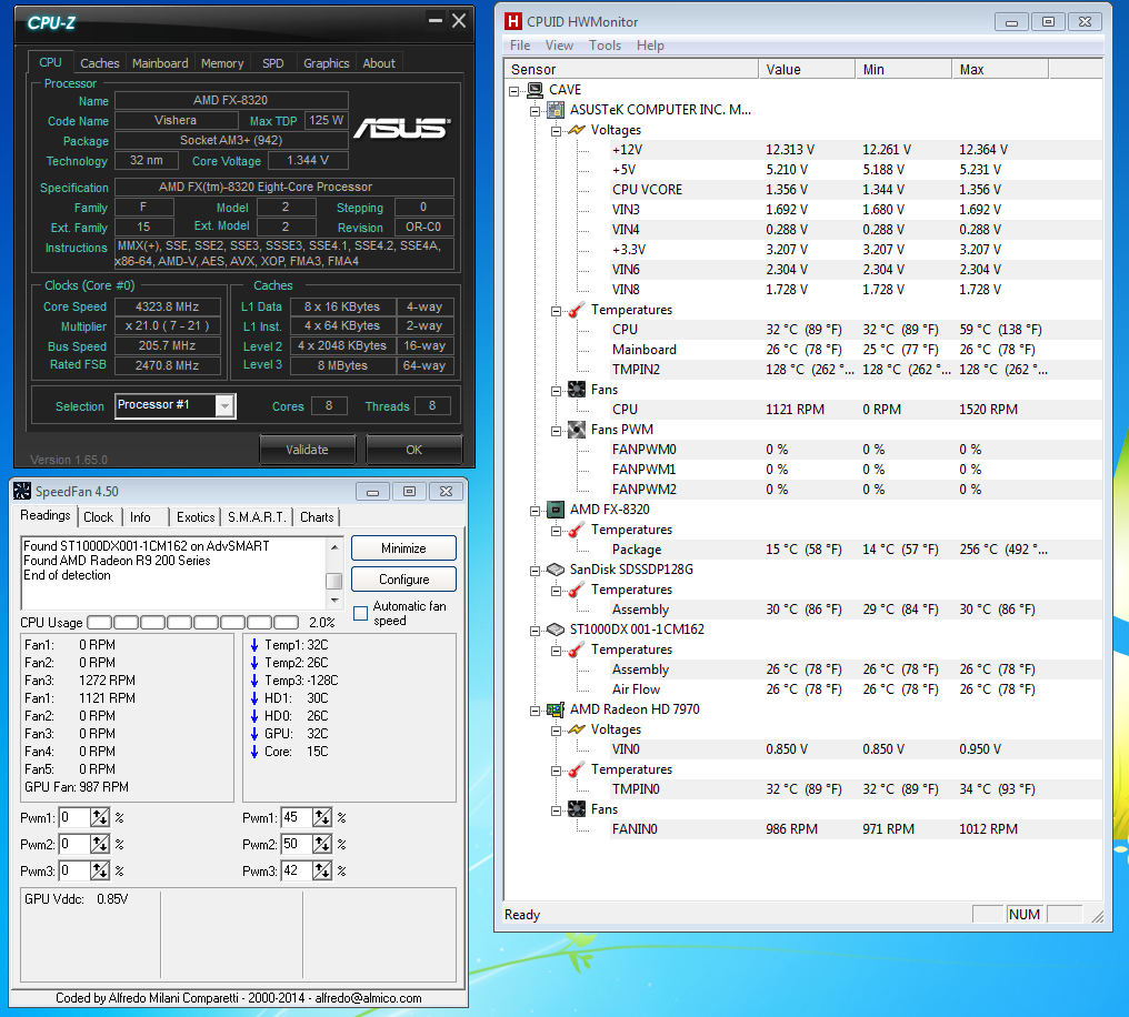

Settled with below for now. I'm finding messing with the bus on this Mobo is causing stability problems and I found greater success with just using the multiplier to OC.
The CPU temp is the socket temp. That's roughly inline with what I was getting so I'd try and push for 4.5, volts permitting.
EDIT: Also I'd suggest not using Speedfan and only using the ASUS AI Suite as I found it wouldn't let me control my fan speeds correctly, and would tend to randomly crash my PC.
Dazzo, using the bus method changes ram speeds too. Make sure that you set the ram speed close to the xmp setting as this can cause some of the instability.
I was having weird crashes and it turned out that it was because I was trying to run my 2133MHz at over 3000Mhz!

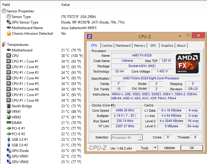

Here are my temps after a few hours of folding:
This is a sensible overclock of just 4.5Ghz on an 8320. This is cooled using a corsair AIO H100.
