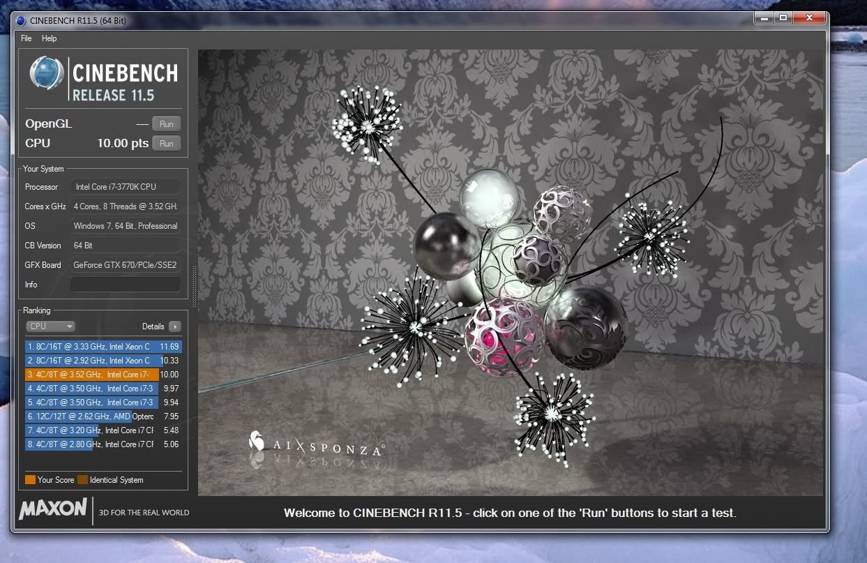

Posted in cinebench thread, but thought would throw it here too - finally got to 10 pts. Don't know why I wanted to hit that, but finally did :D
And it looks like it took as far as I can push my chip while keeping under 100C, which is 4.925GHz with 1.29V/1.3V. Looks like will be peaking around 95C on small FFT's.
Can post some temp/cpu-z/prime screenies some other time, for now -
