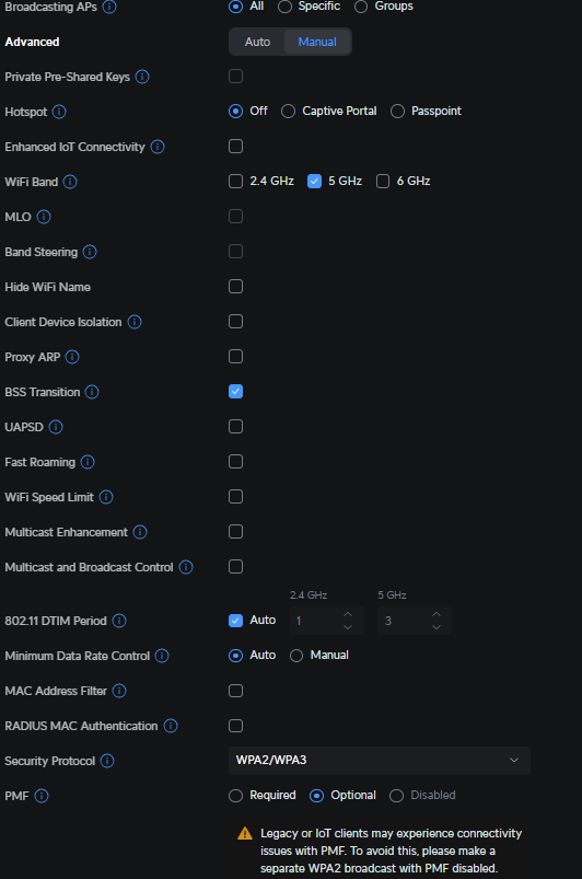

I have a query that appears to be re-occuring although not very often.
I have my WiFi split into 2.4Ghz, 5Ghz and 6 Ghz bands.
My work laptop will randomly refuse to work i.e. no internet when connected to the 5Ghz band but will still work correctly on the 2.4Ghz band. Every other device on the 5Ghz band will work correctly.
I'm at a loss, I thought I resolved this when swapping out to my UDMP and a U7 Pro around 6 months ago. All has been running fine on the CGF and same U7 Pro until this morning. Below is how the two channels are setup. I'm really confused, The Laptop is getting an IP address but just no throughput.
Edit: I have no idea whats going on, It has just decided to start working again. It hasn't worked since 6am this morning and now has decided to come to life. The only thing I can think of is something happening in the background with the laptop?
It's something I've pretty much done since back when 5Ghz came out, a lot of things were a bit funky when using a mixed band. It's just stuck since then really.
It's a bad idea particularly with the newer standards (i.e. Wifi 7), as the frequencies are combined to give greater throughput. Roaming and band steering is also much better these days, so there should be less issues.
Be worth trying a main SSID that has all bands turned on, and use that for modern devices, and set up a 2.4Ghz only SSID for any older/problematic devices, or IoT devices that you want more control over (and you can use older authentication etc).
Good idea! I shall do that just shortly. Could well be due to a newer device. It was mainly streaming items I've had issues with in the past but since splitting them, never an issue until I got this laptop.

Eh, I don't necessarily agree here. When given the choice, many client devices will simply choose to connect to 2.4 GHz because of stronger RSSI without regard to channel utilization and congestion. It also leads to poorer roaming behaviour because the client tends to hold onto the original AP longer as you move away from it, even when there is an AP that is now closer with better signal. What I instead do is make sure there are simply enough APs to give consistent coverage of 5GHz across the house so I don't need to worry about needing to fall back. That method will work great when WiFi 8 allows for clients to connect to multiple APs at the same time and eliminate the VOIP issues with roaming.
I do have a second AP going up but it will be in the soffit outside to aid WiFi extending to the garden and garage area.
I'm still a bit baffled as to why my laptop does this. I would assume that if I have the channel with combined frequency and my laptop had a wobbler with 5Ghz channels, It would fail back to a channel on the 2.4Ghz band?
Which is fine - individual installations will always be different. What works in one house with modern devices, might not work somewhere else with a mix of older and newer devices. There is no one size fits all - however one of the big changes with Wifi 7 is the use of Multi-Link Operation (MLO), aggregating multiple bands to increase bandwidth - If the bands aren't all on the same SSID, this isn't possible.
Which is why to properly set up any wifi network you need to walk around, do a site survey and then adjust transmission power and minimum signal strengths for each AP and band individually.
Which again is fine - turn off 2.4Ghz on your whole SSID, or on the individual APs that don't need it (e.g. maybe turn it off indoors, but leave it on an Outdoor AP for better coverage)
Wifi 8 builds on Wifi 7, so yes as you mention it should be able to connect to multiple APs at the same time, but it will still benefit from MLO.
Windows isn't smart enough to change between SSIDs just because there is no internet (in some cases that might be intended - direct connection to another device etc) - it just sees "connected" and stays there
It depends what the underlying issue is, but it will certainly be more likely as it will see traffic on both frequencies on that SSID, and the wifi driver can make the decision to roam between.
