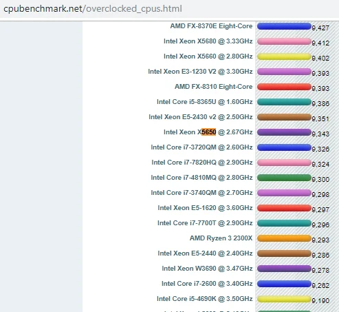

£15 for an X5650 and should overclock to 4.4ghz (maybe more maybe less) and it's 6 cores and 12 threads. No brainer for x58 owners and whilst it wont have the single core strength of modern CPU's, it will certainly play pretty much everything with decent FPS when paired with a good GPU. I was using one before I upgraded to an AMD 2700x and average FPS wasn't far behind.

X5650 £9 these days! No brainer :)
Overclocked it will achieve over 9000 :D passmark
Buy a Xeon X5675 or X5650 as others have suggested they overclock to 4.2-4.4 and for £10-£15 you would be crazy not to try this first.
