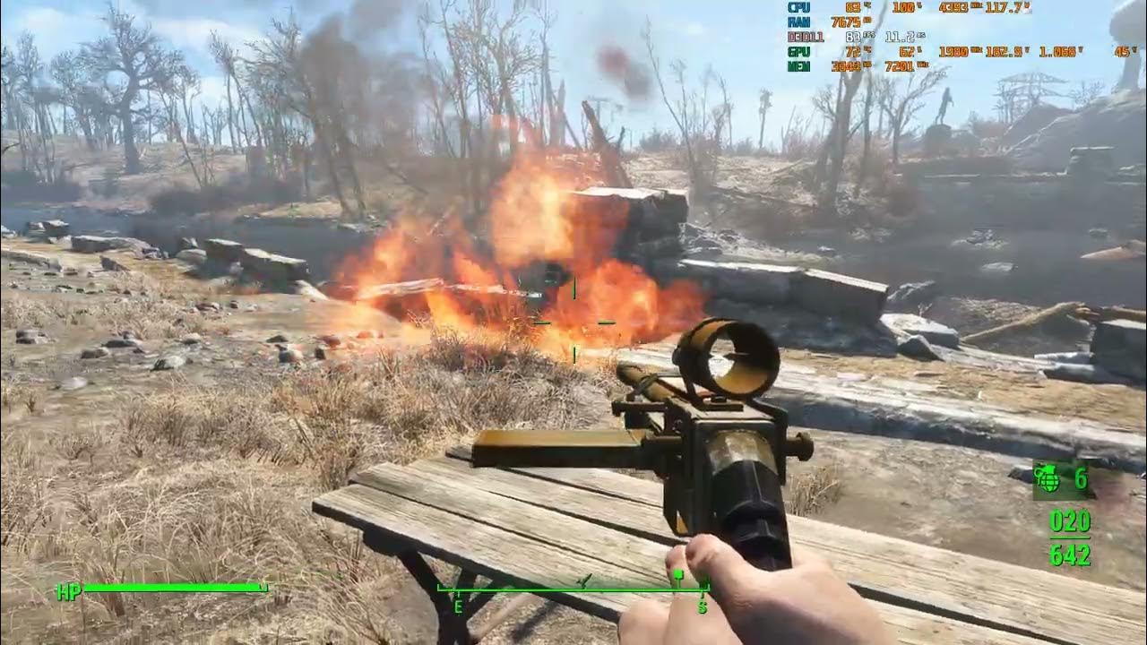

This is with a 3060 Ti and appears to be frame capped (I think that's normal for Fallout 4?) and it seems to do fine:
