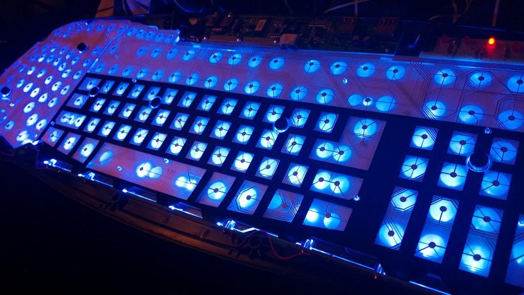

Hey guys, my friend had an accident with my steelseries merc stealth that involved an entire pint of strongbow drowning it. I instantly unplugged it and turned it upside down but I believe the damage had already been done. I let it dry out for a few hours, upside down over a low heat source. I plugged it in and it was dead, no lights, no recognition on pc, nothing.
I left it for a few days as I have been away on business and plugged it in an hour ago, it responds, lights come on, all seems to work except one problem.
The S+X and V+G keys seem to be paired. so when you press either, both characters are inputted. I've disassembled it, gave the plastic fascia a shower and am left with the rest, (pics uploaded). It's down to the bare minimum but the keys still seem to be bonded and input both characters, does anyone know a way to fix this? My mate has offered to buy a new keyboard but obviously I'd rather not have him have to pay for a new one if this is fixable. Pics below.

There does seem to be a small amount of residue on the clear plastic sheets that have the connections running through them, i don't see how it has linked certain keys together though :(
thats due to the way the keys are set up, look up ghosting etc for detailed explaination as to why, but it means thatit might not just be residue on the v and x, but over a few others and thats how it is detected. Just get some Isopropyl (tim cleaner if you already have that) and use that with a lint free cloth and wipe the plastic down.
