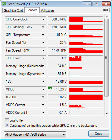

Sorry to butt in but I still cant seem to up the voltage on my card using any programm even msi afterburner. Kompbuster and GPU Z show the voltage as default nomatter what i set it too :/.
Doesnt anyone else have this problem?
You have gone into the settings of msi afterburner and checked the two boxes for monitoring and adjusting the voltage haven't you?

@ Stock that Temp seems very High. Your card has if not the best GPU cooling, My max temp on BF3 is 61C
Yes I agree, very high temps considering. I just assumed he must have poor case cooling or the cooler isnt seated that well.
