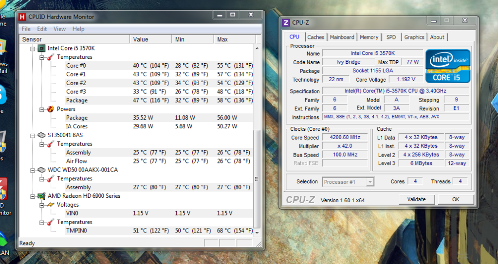

ok I changed the ratio to 43 so it reaches 4200.46mhz. should I change the Voltages or Bus speed? Bus Speed is at 100Mhz and volts 1.088 (Is the highest i've seen it go) =D

Oh yeah that was a typo. I meant to put 42 :D
Ahah I see. Just never touch the BCLK and you will be fine. Like I said make sure you're manually putting in the voltage as well auto usually goes pretty voltage heavy. I'd suggest trying 1.1V seeing if you BSOD at all and up by incriments of 0.05V doubt you would have to go past 1.2V for 4.2Ghz though.
the voltage keeps changing. shall I just knock 0.05 off a few times?
Or go into the bios and make it 1.2?
Edit. It only reaches 1.92 anyway. Shall I just leave it?
go into bios and make it 1.15V run a stress test and see what happens. The reason it changes in CPU-ID and the like is because the CPU does not always use 100% of the voltage available to it.
