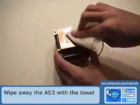

PIC (This is only t oshow you as you can see he is putting it on a block.)
As for over clocking leave it for about the time it takes you to put the side on and site down :)
