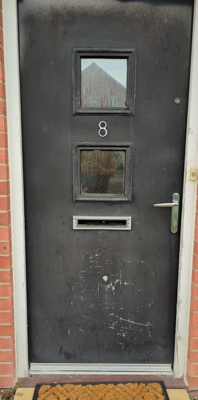

We are going on the market! But before i let them take photos I need to quickly sort this embarrassment out

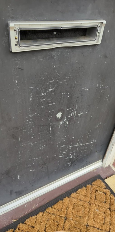

Not a task I've done before. Bought some sand paper and a sanding block. Doesn't really seem to remove the paint? Just makes it smoother no matter which grit I tried.
Is it just a case of going over the door to make it smooth and soften the cracked paint a bit/blend it in the just slap some new paint on top? Same for the frame too. It's metal skinned.
Just want to tidy it up.
Which brand paint would you recommend?

If it was mine and to do a half decent job I would.
Flat off as best as possible.
Apply two coats of Zinser 123 water based primer using a roller on large flat areas. This is recoatable after an hour.
Light sand off in between coats.
Choose a decent water based top coat applying at least two coats and again light sand off in between.
Good luck
Where paint is cracking or flaking, then flick it off using a suitable tool.
The sanding isn't to remove the paint, it's just to key the surface for paint adhesion. So, you won't see paint being removed.
