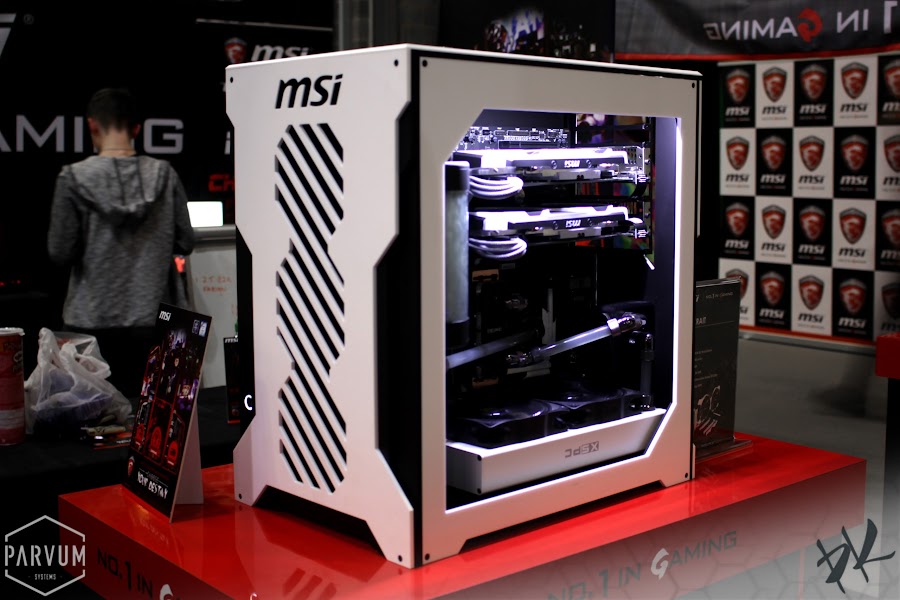

Separating the pump and reservoir in itself doesn't present any serious problems, the critical points are that the pump should never run dry (pump air). Both during use and when filling the loop, the pump is lubricated and cooled by the liquid. Generally the point of including a reservoir is to make the loop easy to fill, easy to top up and bleed out any air that may get trapped along the way.
While planning the loop, lining up all of the fittings so that it would be aesthetically pleasing and distinctive we may have over looked the order of the loop. As such the coolant flows from the: pump > memory > cpu > reservoir > rad > rad > pump. And that made a couple of things kinda difficult, the pump picks up coolant from beneath it and the resevoir flows upwards. Without any internal pipes that means that the reservoir must be completely full at all times, defeating it's purpose of trapping air.
Filling it was a long battle using extra pipes connected to the res and the pump but despite how hard we made it for ourselves the effect is amazing.

Well perhaps trying to spot our oversight was a little too hard on everyone, after all we didn't notice it for several days! The pump is positioned kind of backwards in the loop such that the coolant flows from the bottom to the top of the reservoir. This made filling the loop very challenging, but, we managed it! just...
Having the coolant flow backwards actually makes for an awesome effect in the reservoir with the Aurora quickly rising from the depths and undulating out of the top.

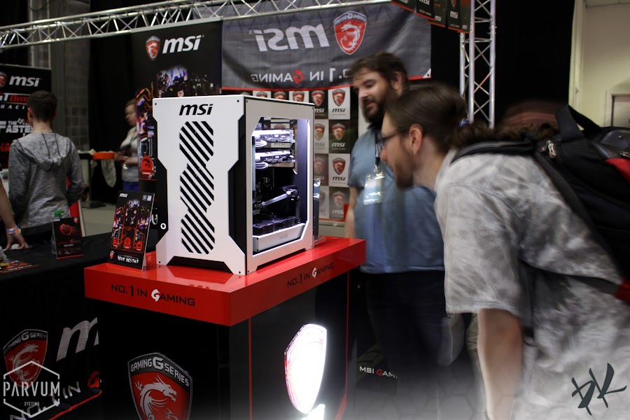

The time has come for final pictures of PARVUM KRAIT, although it has been completed for some time the Parvum team has been very busy with the L1.0 launch and the many other projects and commitments we each have going on. So before it's forgotten and the hectic preparation for another insomnia has passed we thought it appropriate to share some final photographs!
Parvum Systems Inverted M1.0
Intel Maxwell i5-4440
MSI Z97 KRAIT
MSI GTX 960 KRAIT x2
HyperX Savage 1600C9 2x4GB
HyperX 3k 120GB
Silverstone Strider 1500W
XSPC AX240 White
XSPC AX360 White
XSPC Photon 170 Reservoir
XSPC Acetal D5 Top
XSPC Raystorm CPU Block
XSPC Raystorm Memory Block
EK HD Adapter 10/12mm Black Nickel Fittings
EK PSC G1/4" Black Nickel Rotaries
Noiseblocker e-loop 120mm x10
Thank you to MSI, XSPC, HyperX, Mayhems, Silverstone, JR23 and all of the builds followers for your support throughout!
We look forward to hear what you guys think about the build itself and the case, it's something that we intend to make available in the future as a much more compact alternative to the L1.0. Probably in both inverted just like this one and un-inverted too. See you all again soon and thanks for looking.
