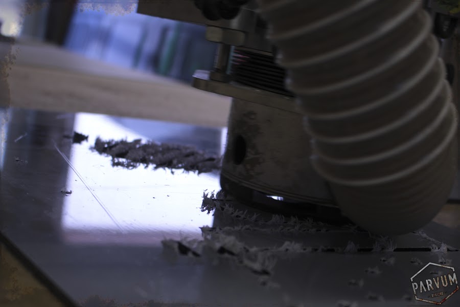

"acetal has proven to be a fantastic material to work with"
Acetal Parvum cases on sale soon.....calling it now :)
It could happen but the surface finish of Acetal is undoubtedly inferior to acrylic, such is that nature of an engineering grade plastic, this piece at least didn't turn up with any protective backing. It's also not readily available in 5mm sheets meaning we would have to adapt drawings a little to accommodate. The plate bought for SENESCENTIS was 12mm although it actually came as 13.3mm, perhaps in reality they were aiming for 1/2". It worked out great for this but that kind of thing could really mess with a production case. Finding acrylic in anything other than polished clear above 5mm is a real challenge hence why we gave acetal a shot.
