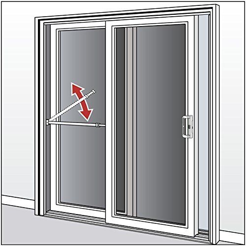

Or a door jammer/brace but it'll only work if your door slides open on he inside, unless you put it in against the handle.

Most of the recommendations made above will only work on patio doors. I think there was a thread on here not long ago with someone asking the same question, and someone had posted a link of this clamp that goes over the door handles (looks like the old steering wheel locks).
