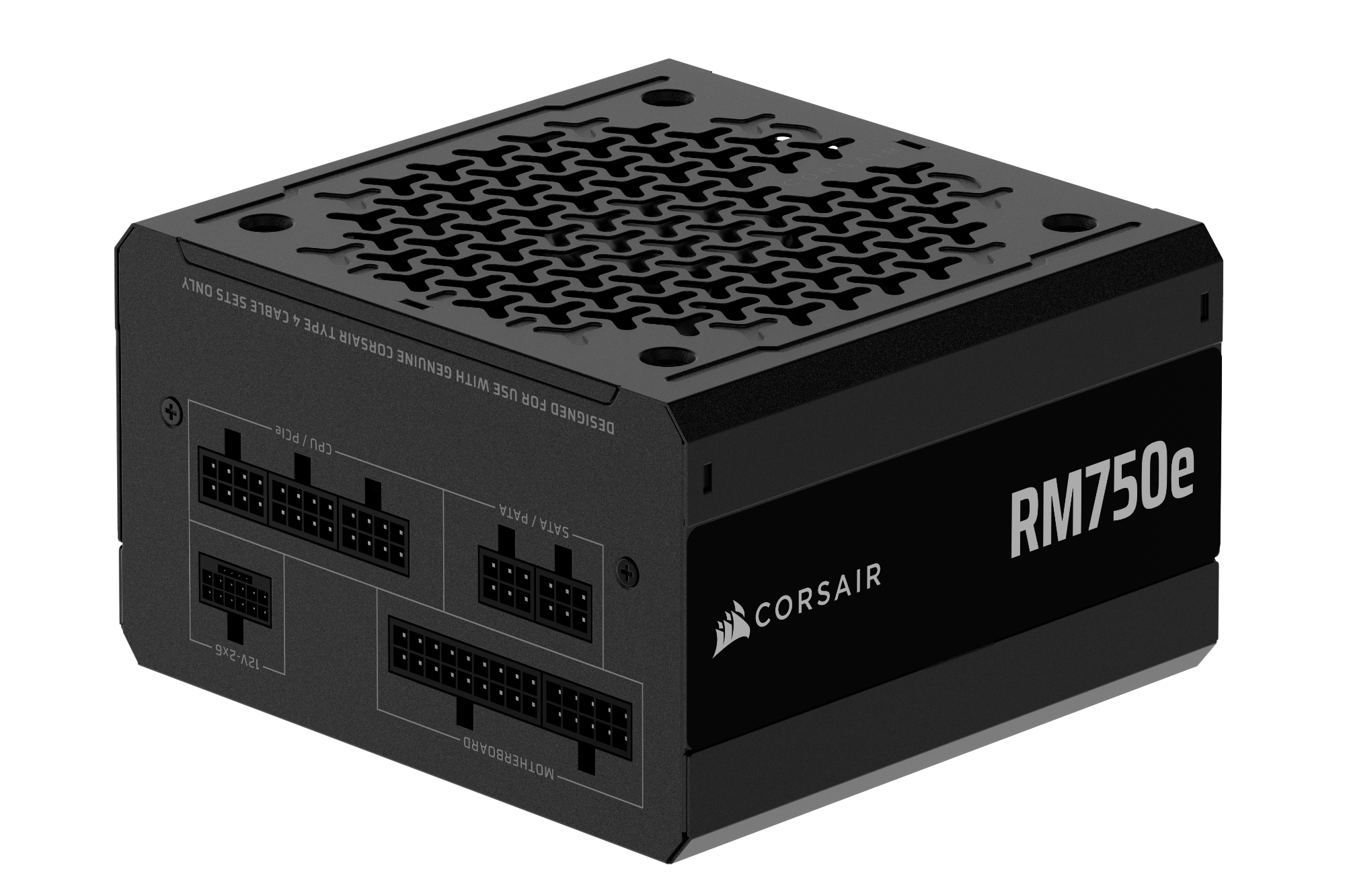

PSU - https://www.overclockers.co.uk/cors...power-supply-cp-9020295-uk-pow-crs-03874.html

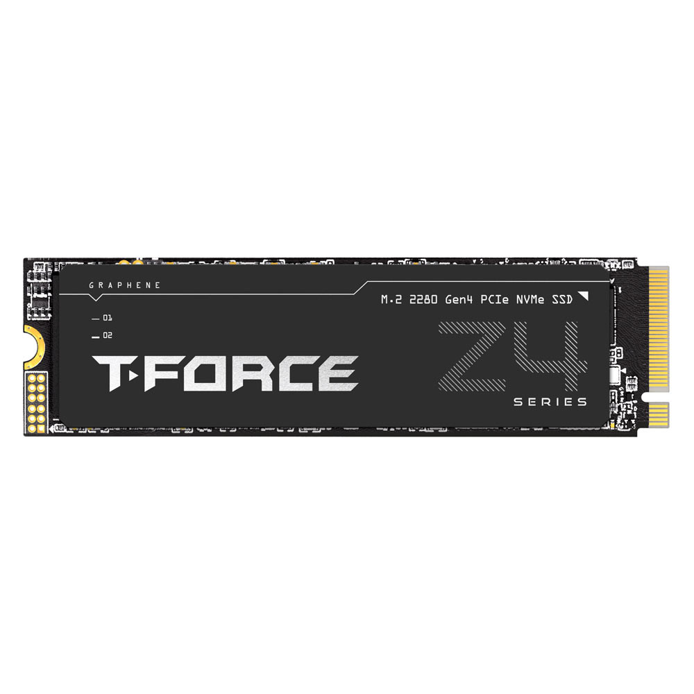

Hardisk - https://www.overclockers.co.uk/wd-b...0-solid-state-drive-wds100t3x0-hd-58f-wd.html

Will these parts work together, will all psu wires be long enough and provide power cable to my graphics card, when comes to installing Operating system windows 11 requires Secure Boot, and TPM 2.0, can it all be enabled in the MSI BIOS?
Would the 750 watt power supply be enough for the system and the GPU card I have.
Yes.

The SSD fits the motherboard, but there have been some issues with WD's DRAMless drives like the SN770 and Windows 24H2. I think it has been resolved with firmware updates, but an alternative drive might be a prudent choice there.
PSU: has the necessary connectors, but seems expensive when the RMe is positioned below the RMx/RMx Shift.
