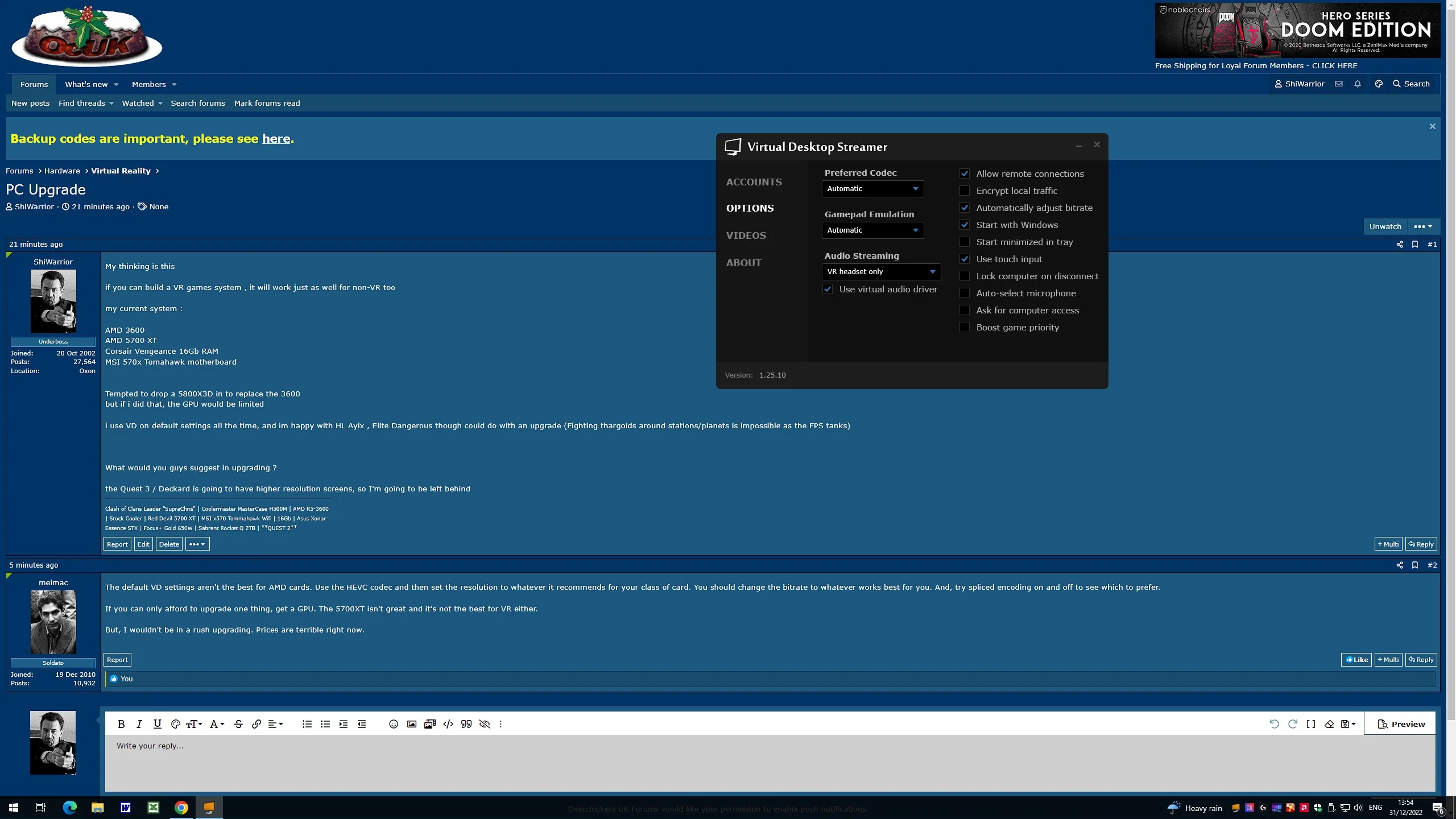

My thinking is this
if you can build a VR games system , it will work just as well for non-VR too
my current system :
AMD 3600
AMD 5700 XT
Corsair Vengeance 16Gb RAM
MSI 570x Tomahawk motherboard
Tempted to drop a 5800X3D in to replace the 3600
but if i did that, the GPU would be limited
i use VD on default settings all the time, and im happy with HL Aylx , Elite Dangerous though could do with an upgrade (Fighting thargoids around stations/planets is impossible as the FPS tanks)
What would you guys suggest in upgrading ?
the Quest 3 / Deckard is going to have higher resolution screens, so I'm going to be left behind
The default VD settings aren't the best for AMD cards. Use the HEVC codec and then set the resolution to whatever it recommends for your class of card. You should change the bitrate to whatever works best for you. And, try spliced encoding on and off to see which to prefer.
If you can only afford to upgrade one thing, get a GPU. The 5700XT isn't great and it's not the best for VR either.
But, I wouldn't be in a rush upgrading. Prices are terrible right now.
my VD PC Streamer settings :
Disable automatic bitrate and set the codec to HEVC on that screen.
That's only the streamer settings though. The other settings can only be changed when you start virtual desktop. So ?I would need to see your settings from inside virtual desktop.

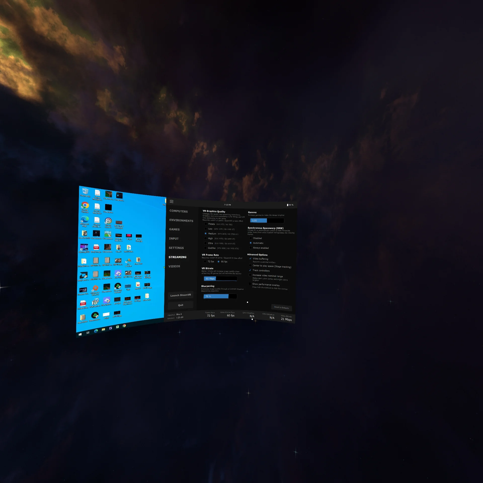

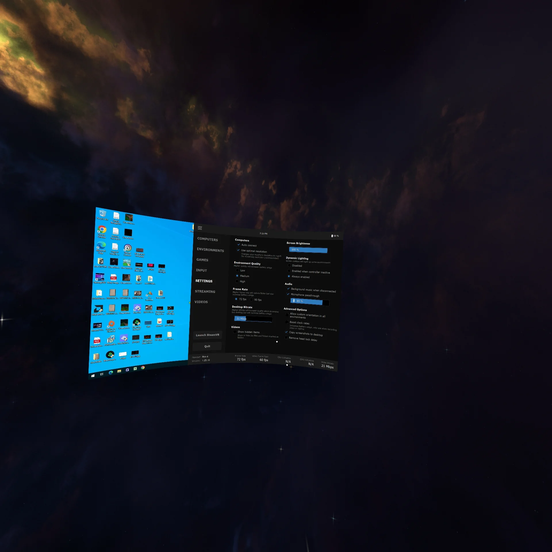

Your settings inside virtual desktop itself are ok. Would try and change the VR bitrate though to something higher. Try 100 and see what latency is like and work from there.
