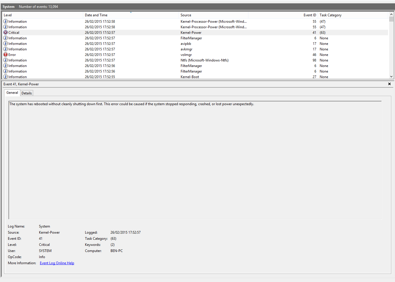

As the title says my PC keep on randomly shutting off and powering itself back on. It does not blue screen and literally just powers itself off, the only thing that i can see when it happens is a red LED comes on on the motherboard about .5 seconds before it shuts off. This has happened both under load and idle.
The event log only shows that the PC forcibly powered off. I have checked the following:

Ive had the event-id 41 before and I narrowed it down to an audio driver conflict. I disabled all of my drivers apart from the Realtek one and its been happy ever since.
