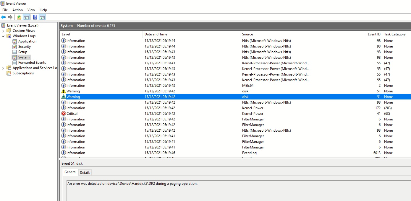

loose/faulty wire to SSD/HDD perhaps or a failing drive.
check windows event viewer for hardware events
like here's an example of one of my HDD that has been trying to die for a few years now
occasionally it disappears all together until I reboot, sometimes rebooting takes forever as the computer detects something but can't actually access it seemingly.
