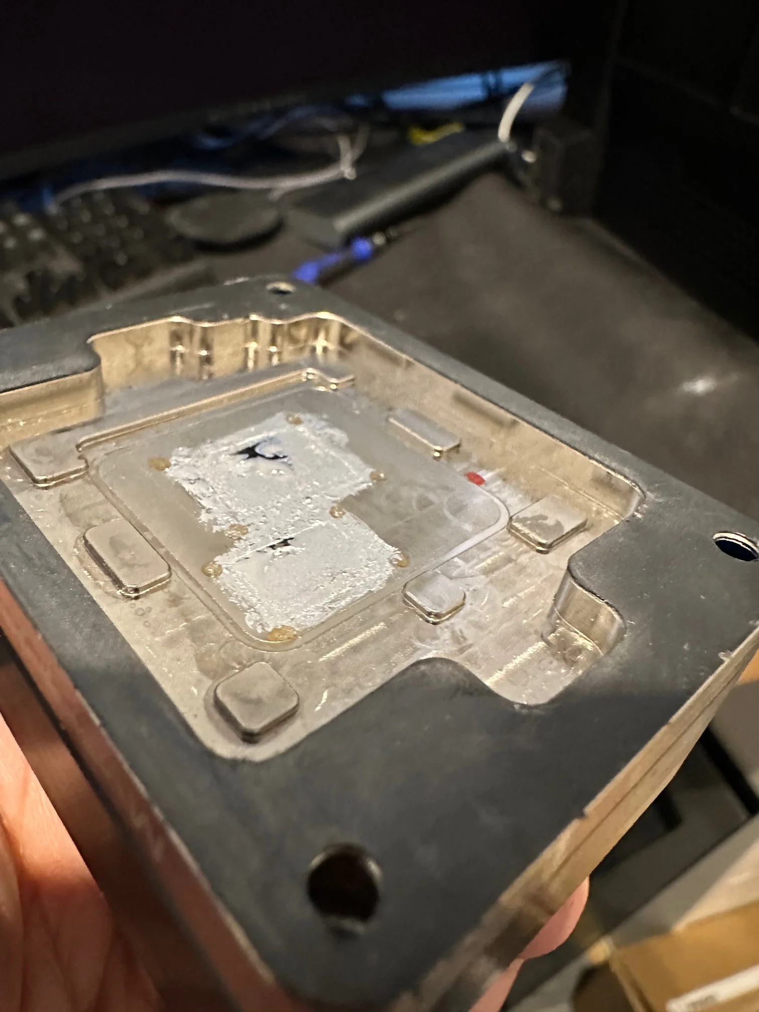

Do you have a picture of your die ? I suspect your block isn’t making contact.

No you either scrape off the solder or dissolve (if that’s the correct word) with LM.
No point polishing, I think you have a contact issue. Try more LM or use thermal paste to see how much contact your DD block is making.

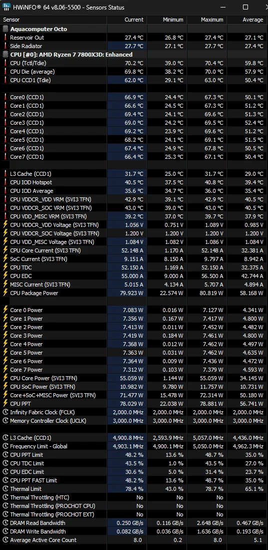

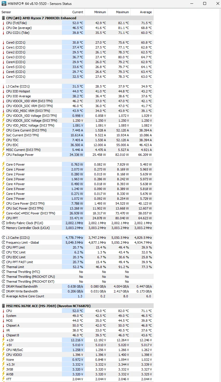

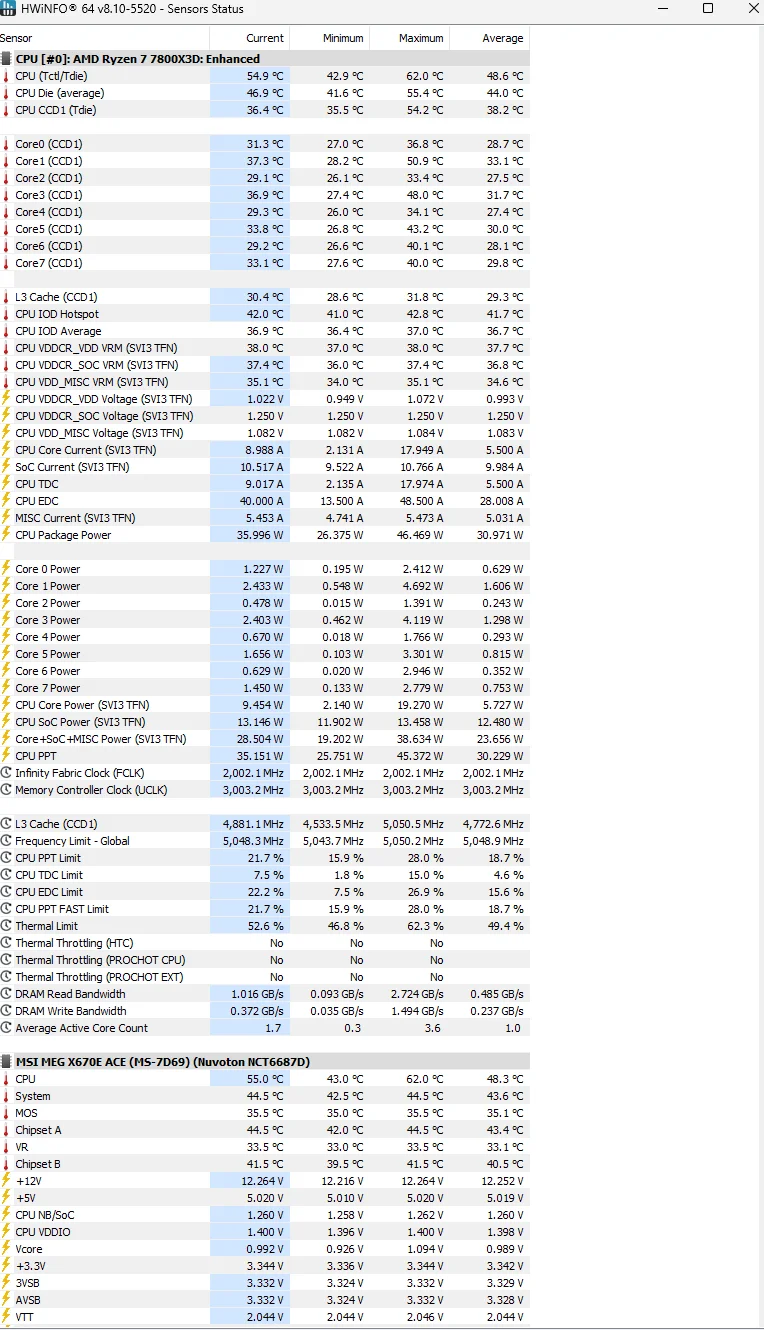

These are my idle temps before i did anything:

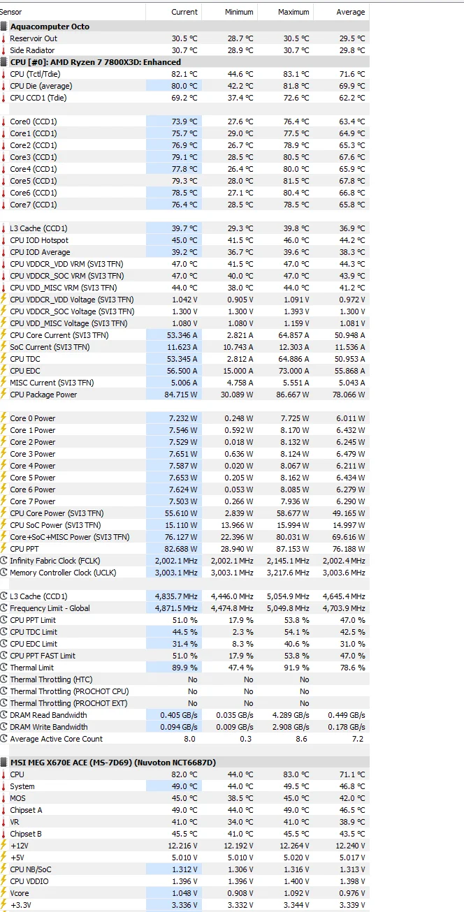

Temps after a CB 10min run: (see max temp)
Temps after CB 10min run after applying more LM:
temperatures were worse by about 2 degrees after loading default Bios and enabling EXPO. Even tried dropping from -30 to -25.. made no difference.

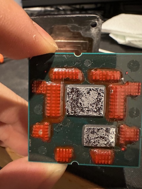

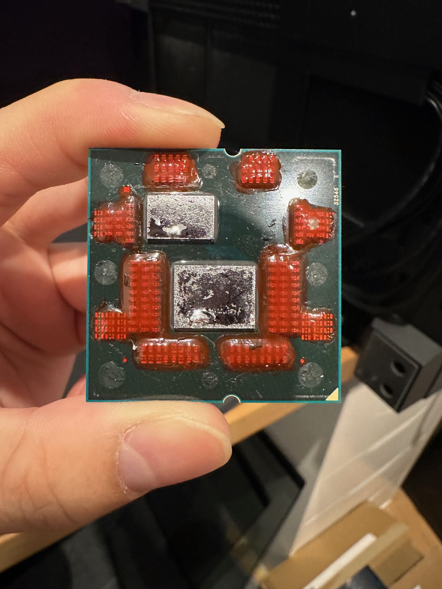

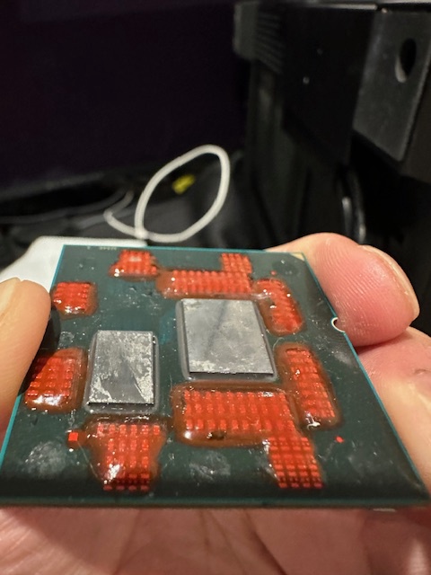

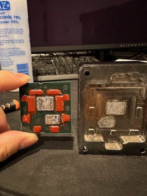

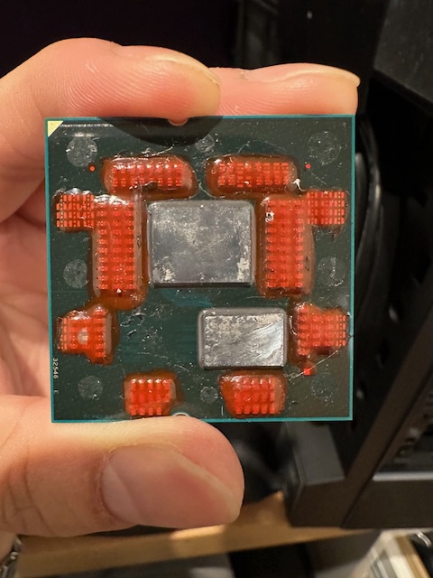

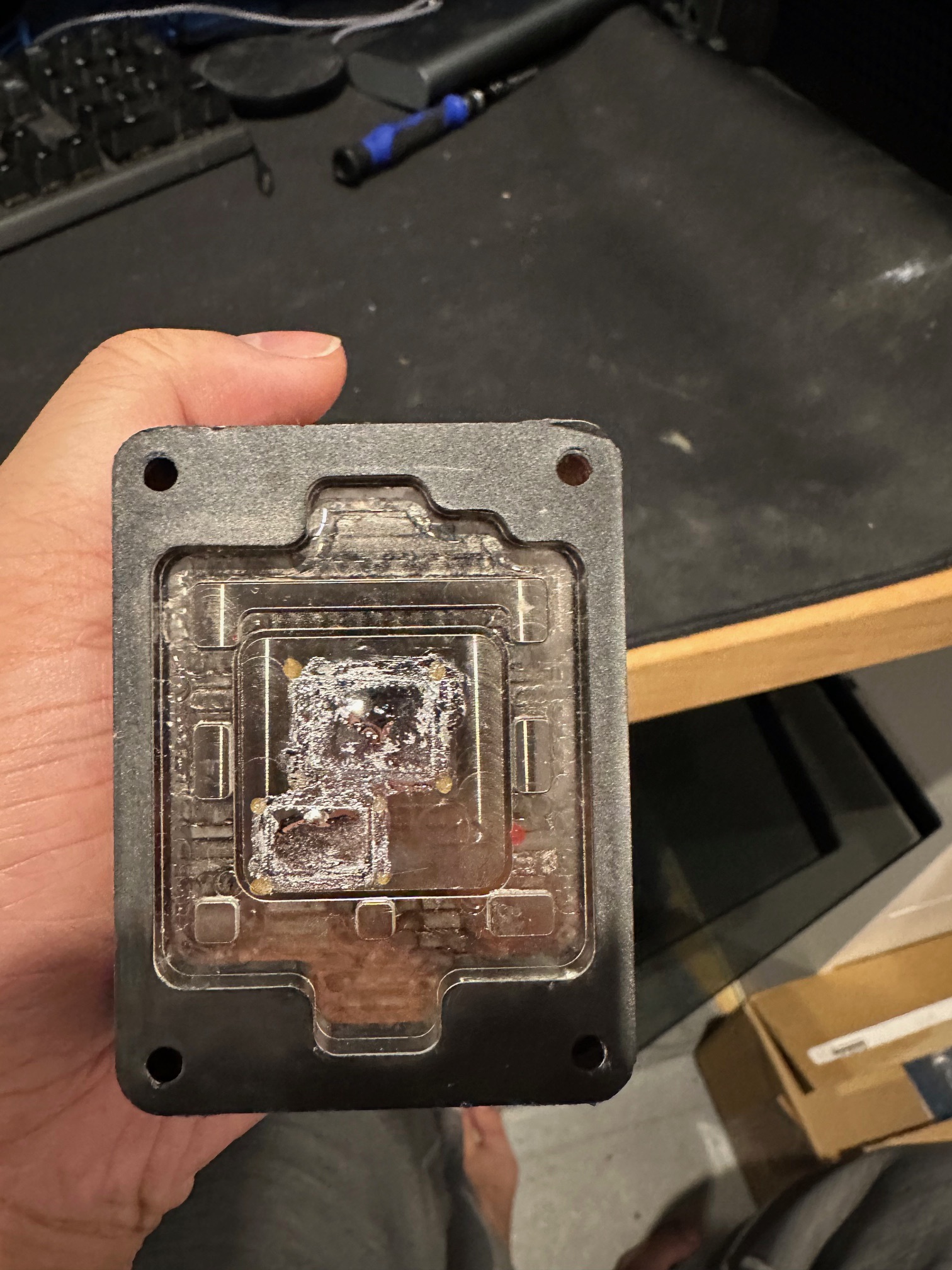

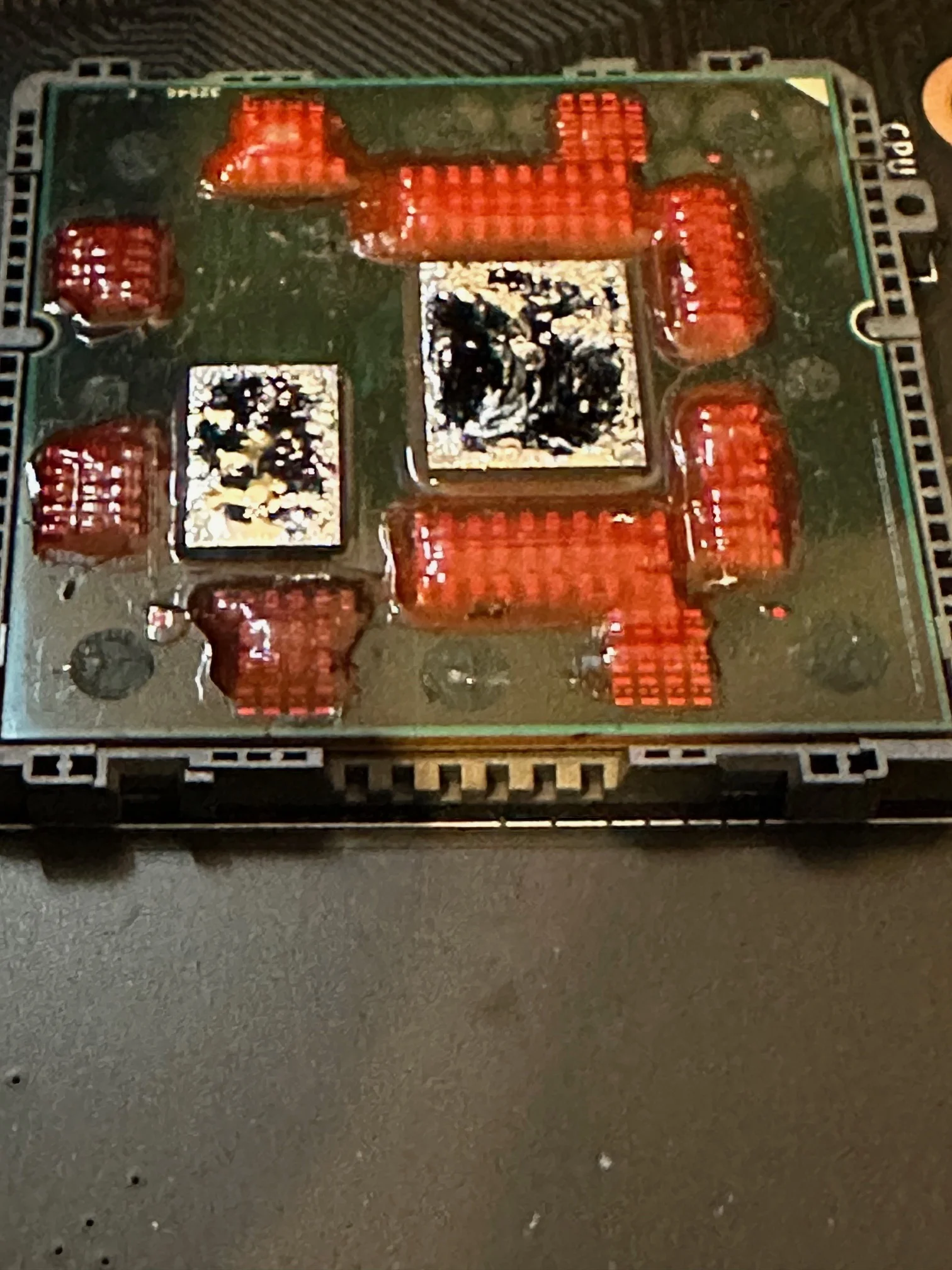

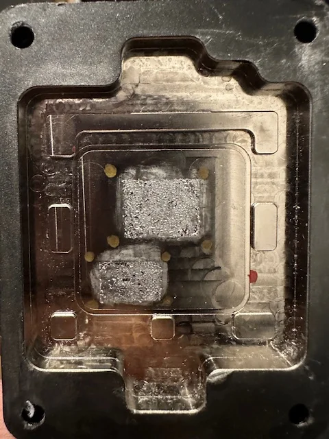

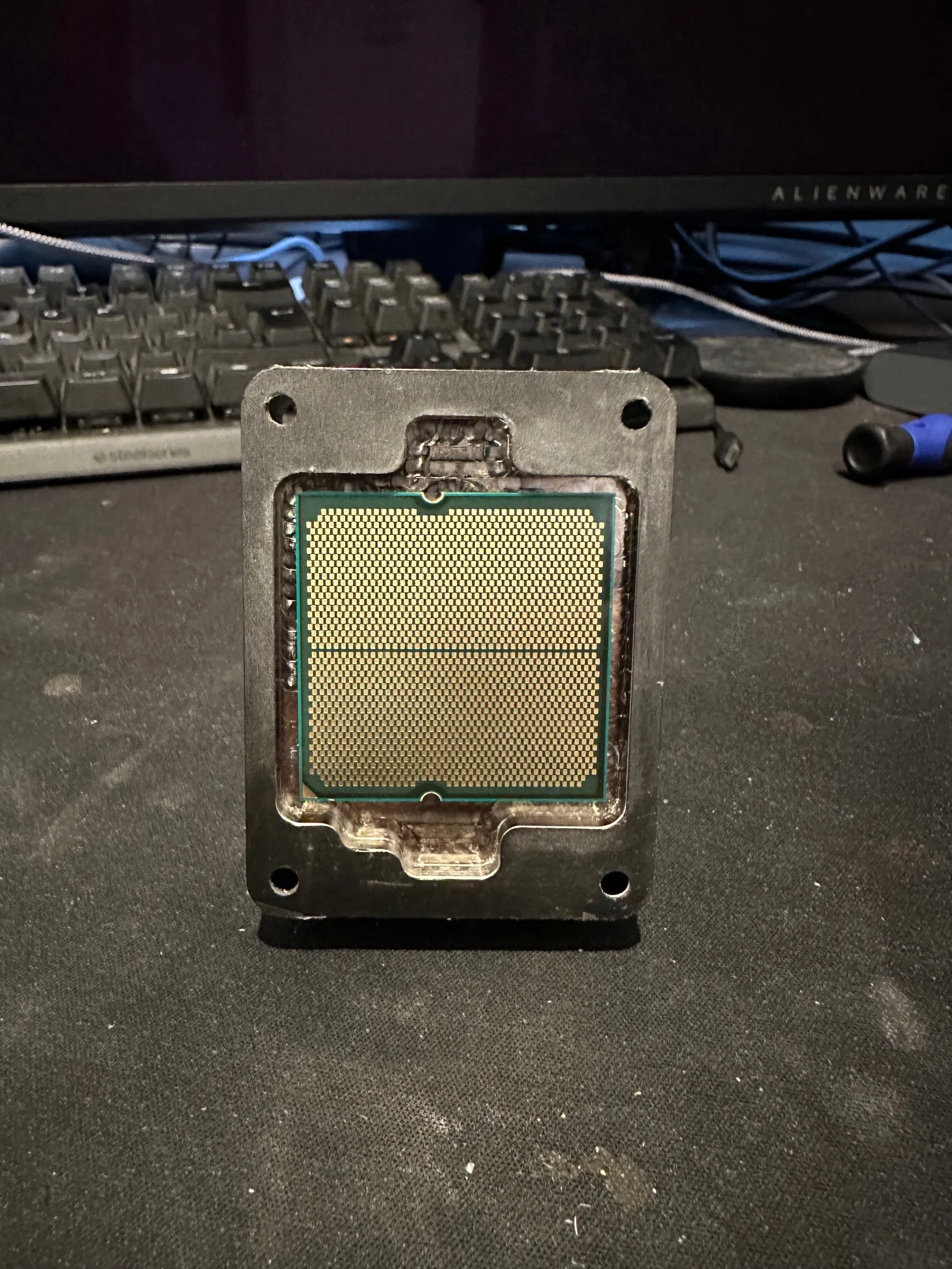

Pictures to determine contact: (LM on die only, clampted to socket, removed then checked DD for LM contact)

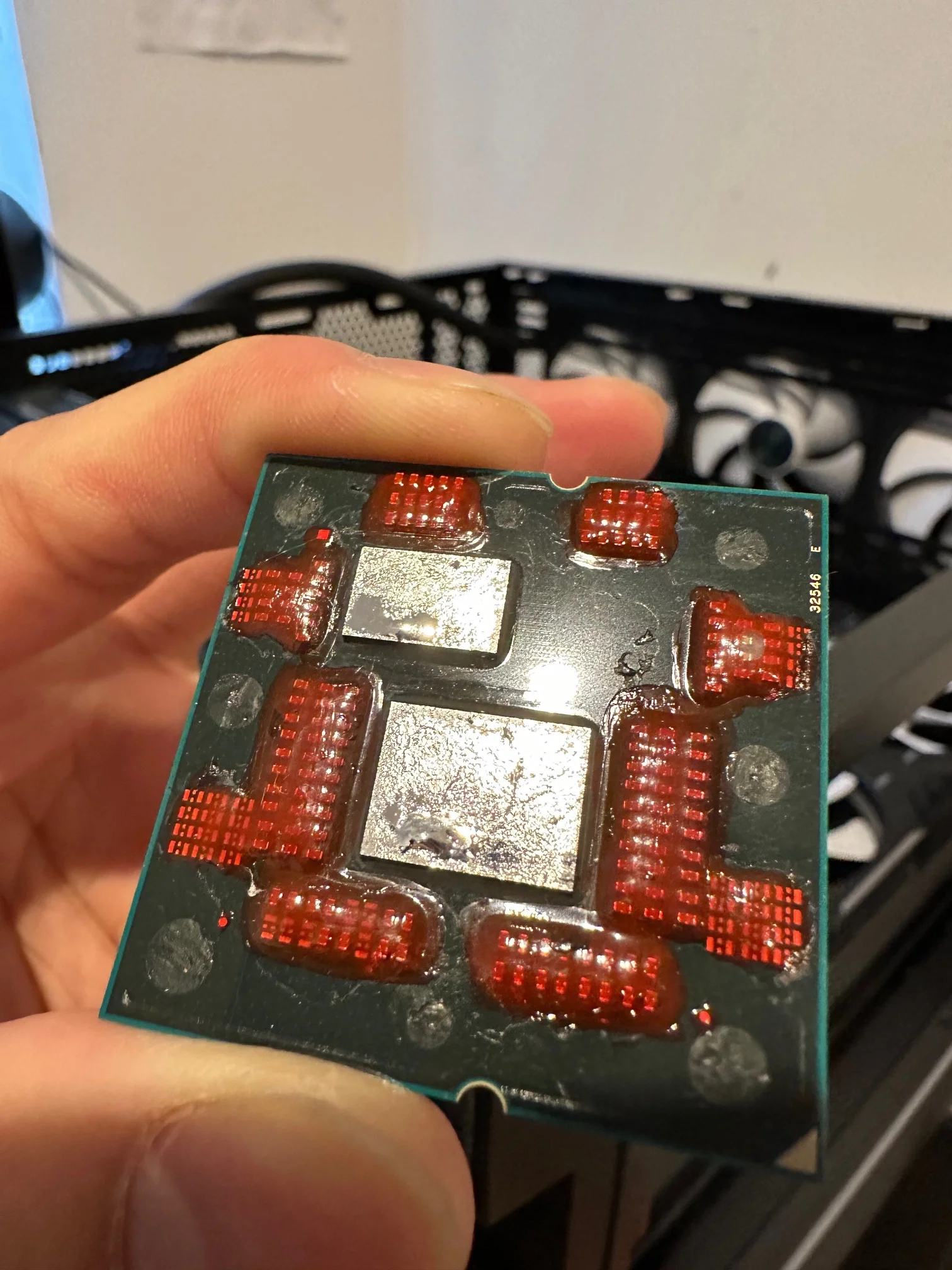

Naked die with LM removed
Since i'm getting these temps, and well the CPU is second hand anyways, i decided to polish the CPU and try again. I didn't go crazy with it since i'm not in the mood to sit there for hours rubbing away. I don't have pics of the polished CPU, but upon reapplying LM and tightening the block to the socket to the point i think the CPU wil nto break, my temps have improved slightly idling around 43c. Will give it a day or so to burn in and see how it goes

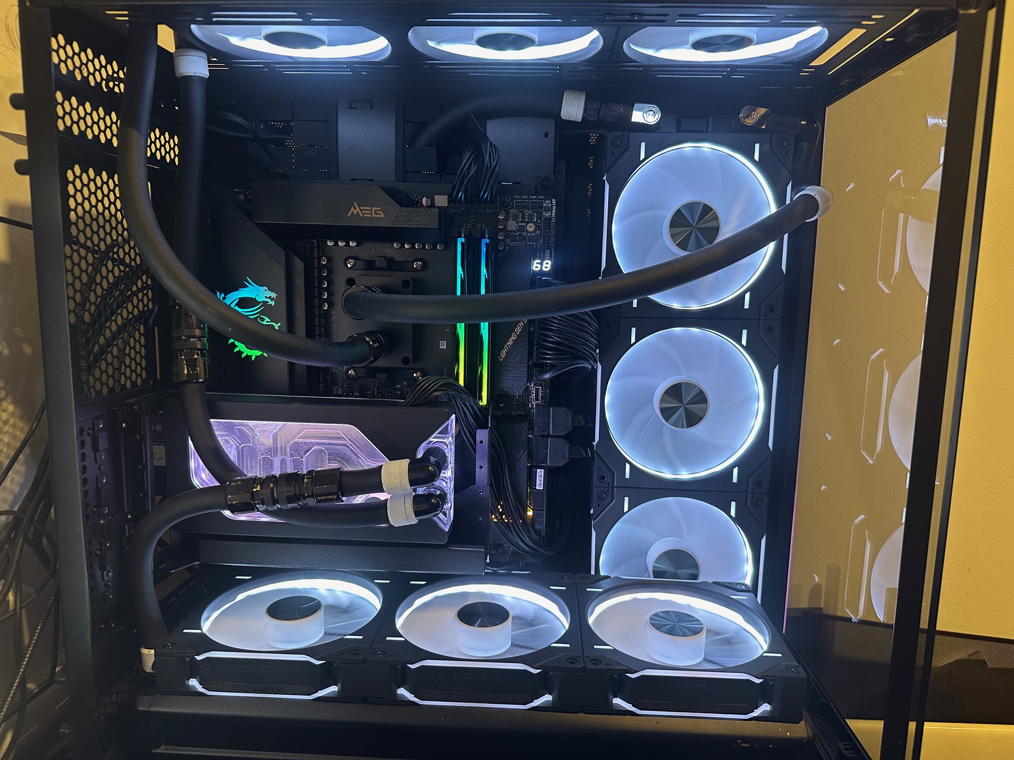

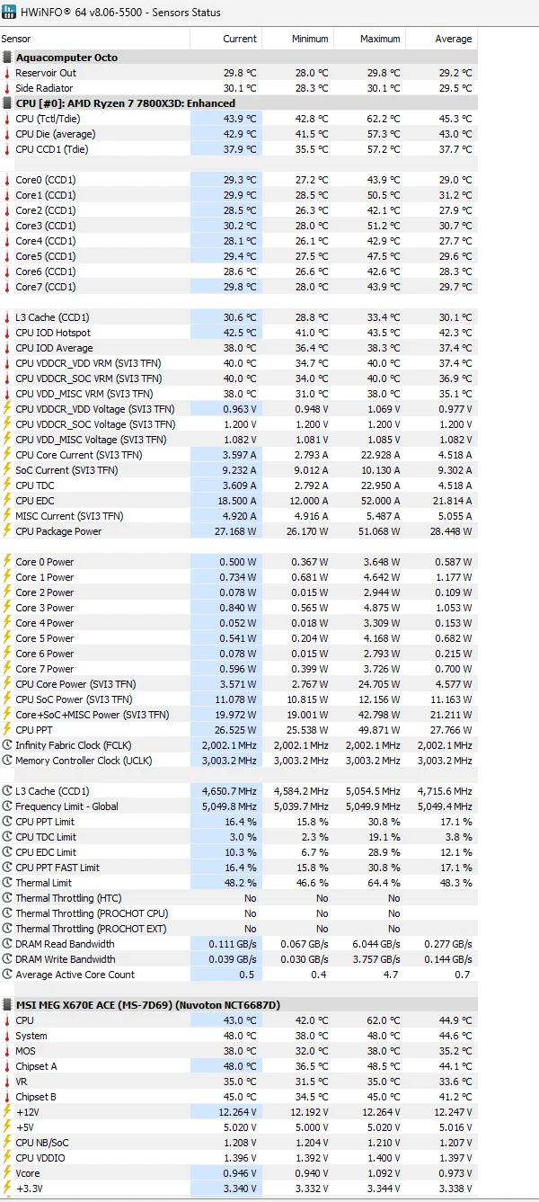

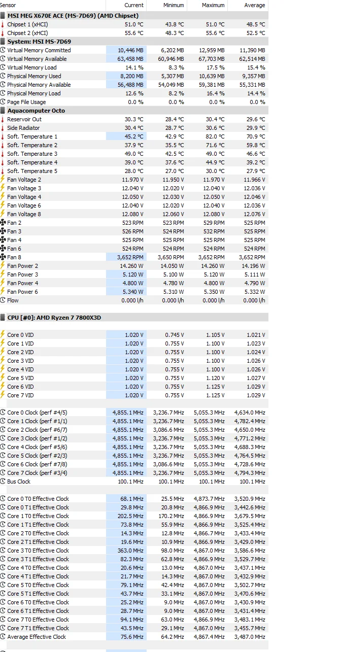

after receiving a block from Debauer, i installed it and reran CB23 for 10min.
Idle and load temps improved a lot compared to the old block, but i feel it could be improved more...
i feel the cause could either be the restriction of the loop with the many QD i'm using together with 10mm ID tubing and a low pump speed
re-lm'in the dies
and/or allowing the LM to temper with repeated heat cycles
Idle flickers between 36-41c
Load doesn't go beyong 71c
Using same settings as above but i updated to the latest bios and doesn't sit stable at -30, so had to drop it to -25

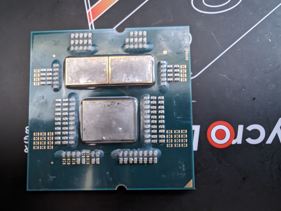

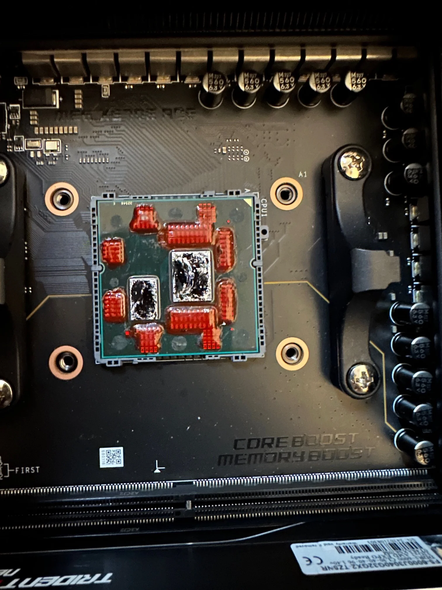

This was my 7900 non X, now sold you can see the glue they put over the SMD's in this picture, you can also see the residue you speak of on the die's, I never polished this one, next time I take out my 7900X3D, i'll take a pict of it, it has more glue over the SMD's and also I polished the cores on it.
