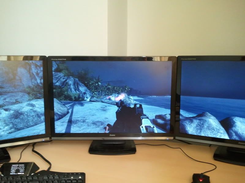

Nah mate, it's poor drivers. Just installed Crysis and ran it Eyefinity 5760x1200. I have an SB i7 2600 @ 4.2 standard - surely it cannot be CPU for me?
Piccies below. See the maximum GPU usage indicated through G19 and on screen using RadeonPro app
RadeonPro app gives visible indication of GPU usage
Position of cards is reason for high GPU1 temps
Crysis ran through ATI Xtension 1.4. FPS around 60 with High settings and 2x AA
