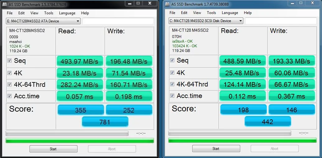

I just ran AS SSD Benchmark and compared it with the results from the sticky and my Seq. read/writes aren't far off but the other scores seem to a good bit lower.
The left image is from the sticky and the right image is mine.
Is this just age related performance drop or something else?

Pretty interesting as you are using the Intel drivers where as the sticky is using the ms drivers. Yours should be better... are your drivers up to date?

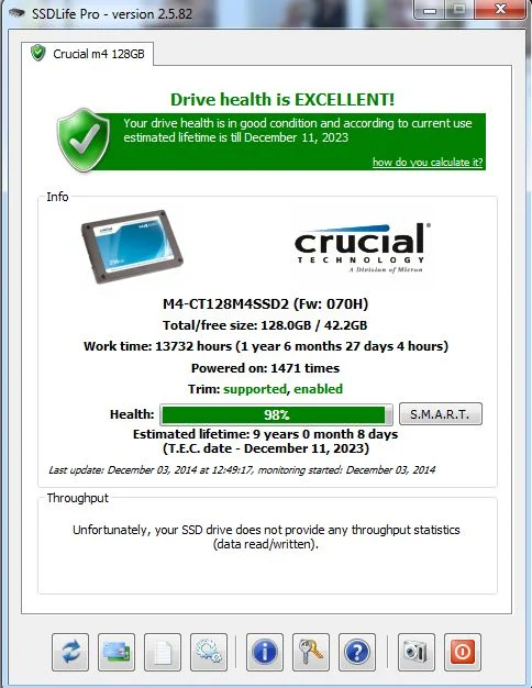

how full is the drive? speeds should be better than that

I didn't even know I had a choice :)

Still 40gb free and my mobo (see sig) BIOS is the latest.
