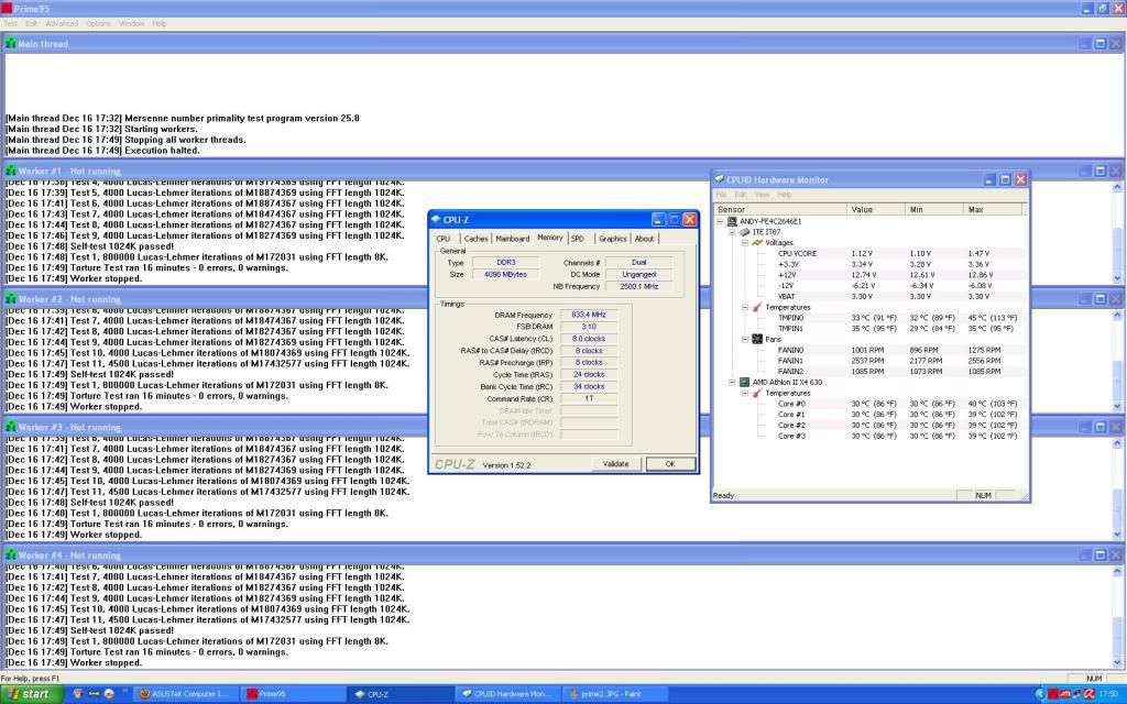

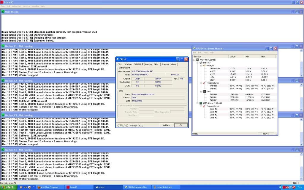

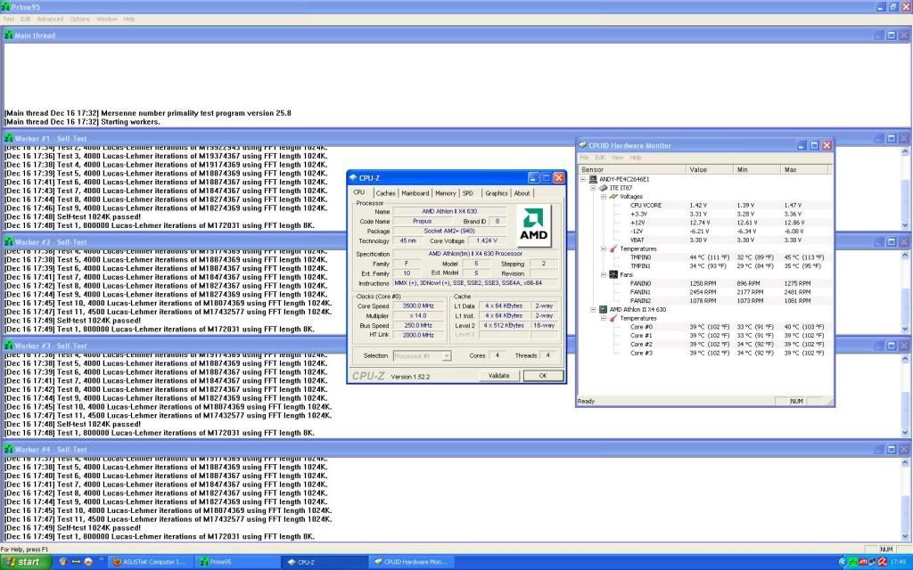

so wheres our CPU-z screenies! :)

Will do some more screenies tonight, cheers for your help fella!
