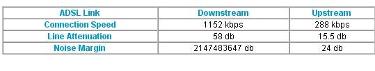

xb8browney said:This morning BT were changing my SNR and i got
Noise Margin 2147483647 db
WWS|Griff said:That's simply what shows when it's defaulted due to an error.
Phemo said:Not always. I had the same thing show on my router just after my connection had dropped.
WWS|Griff said:Exactly.. Connection dropped, router couldn't obtain SNR correctly and defaults to error.
