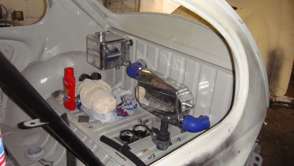

Is that intercooler going to be ok there? :confused:
it's a chargecooler, doesn't rely on air flow for cooling so it can go pretty much anywhere you like (for instance I've seen a bug with one located inside the car - see below), inside it there is a matrix with cold water runing through it, air travelling through that cools it, there is an external rad in this case a normal heater matrix and a res and pump to circutate cooled water.

Ahh i see :rolleyes: :D
