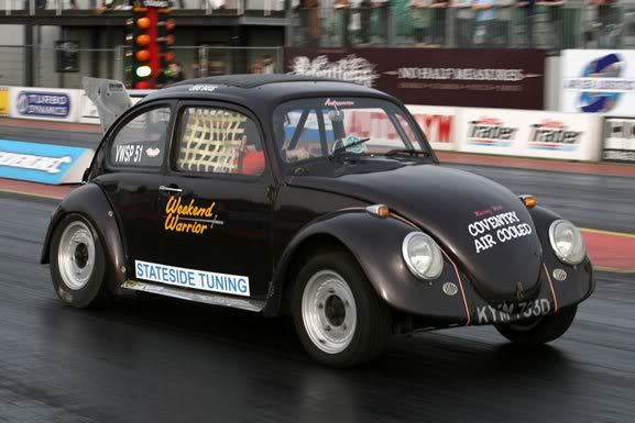

I'm racing at the summer nationals end of this month, gearbox is fixed and now has a weddle chro-mo mainshaft & 1st gear so shouldn't break again.
I've made up a brace between the rear frame horns and the roll cage to stiffen it up, I've also made solid gearbox mounts f/r/& intermediate. oh yeah I've seem welded the r/frame horns too.

Lets see, so I ended my first year of VWDRC in PRO and with a PB of 13.07 or something very close to a real pro time, and having had the most excellent time - I can't recommend the VWDRC enough!
But unfortunately with a broken gearbox - I'd stripped 1st on launch.
So I sent the box to a vzi gearbox wizzard and he sorted it I decided to go with a weddle chro-mo main & 1st.
I had kinda ruled out ETB (round 1) due to thinking the weather would be pants - but it turned out to be a scorcher!
But I'd just set up my own business so funds were going to that, so I wasn't going to do a full year anyway, I did a VWDRC round at the summer nats PB of 13.009 or something ridiculous! (sooo close to a proper pro time!!), but then I split a barrel which judgie kindly sourced for me and started to fix it, I had a bi into the semis as I was no.1 qualifier but late at night putting the engine back together, on the final leg, one of the push rod tubes split.....game over / gutted.
Anyway got that fixed with a set of new adjustable ones from stateside the following week.
I did bug jam came runner up in pro, so was over the moon with that, and with a PB of 12.7, so quite well into pro times, I hadn't expected that much I thought it'd do 12.9/maybe late 8 so 12.7 I was chuffed with!
I got the car MOT'd the morning of vw action and drove it there just in time for night race sign on, and pulled a 12.3 out of the hat :D - just amazed at that really - VERY happy!
I also did rwyb at gti fest in sept, running consistant 12.7's, but then on the last run, split a barrel again - same one, so thinking the injector could be dickie on that one - haven't sorted it yet, but some B&p's are souced, just waiting for them to be available to me, and v.soon I'll get the injectors tested & cleaned at northampton motorsport.
