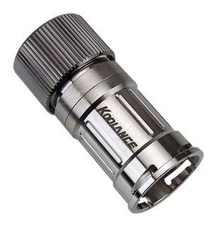

After a MM request - I'm now in possession of 3 additional heatpipes (more to follow)
with a X-Fi Extreme music and two sets of Koolance VL4’s on route.
The Koolance quick connectors are the new ‘Extreme Flow’ versions seen below.
The second image is the older High flow ones for a comparison. The Zalman quick connectors
that come with the Res2 have been replaced with plastic barbs as they where the
most restrictive part of the loop. But the ability to de-gas the RES and split the loop when
wall mounted is a must. Money well spent imho but I’ll take some glossy shots when they arrive.
As with the GUP I’ve been meaning to get these for a while now, as the CPC and Eheim QC’s
no longer have the flow advantage and don’t look anyway near as nice :)
