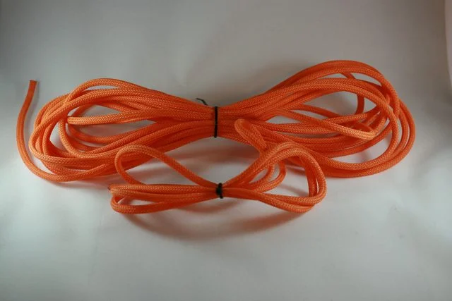

So, this is half of the sleeving i was sent from E22.Biz i have more white too... i want this orange though..

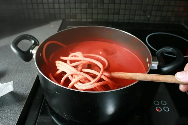

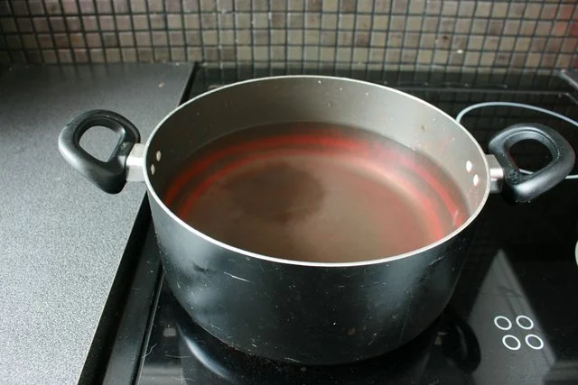

So, i got a pan of hot water and put it on the hob (notice the stains, this wasnt my first attempt lol)

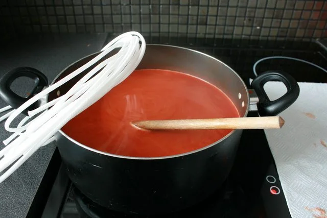

Then added around half of the 25g bag of dye.

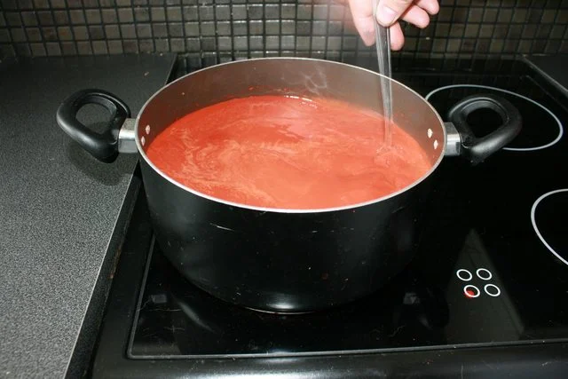

I gave it a stir (do you think i could be a hand model?) (Parvum, valkia, anderp.... no taking the mick -.- )

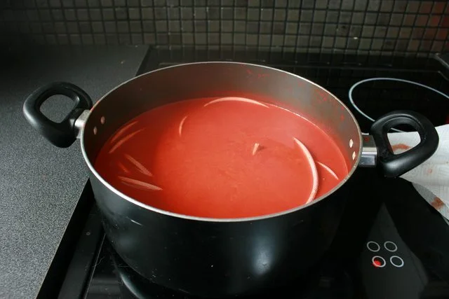

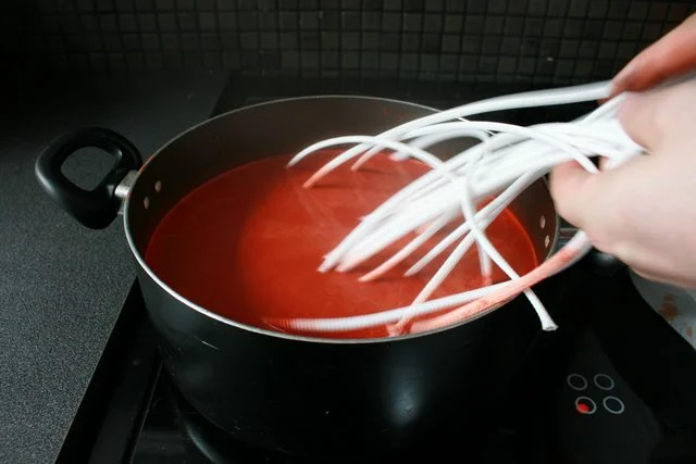

Grabbed the sleeving and started to put it in!
Try and get all the sleeving underwater, make sure you stir often and also turn it over as much as you can

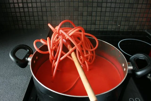

after around 10 minutes
after around 20 minutes
after around 30 minutes

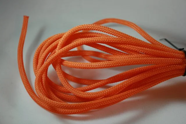

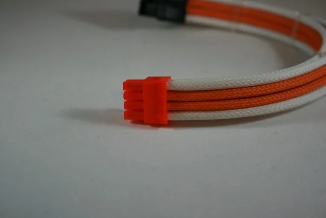

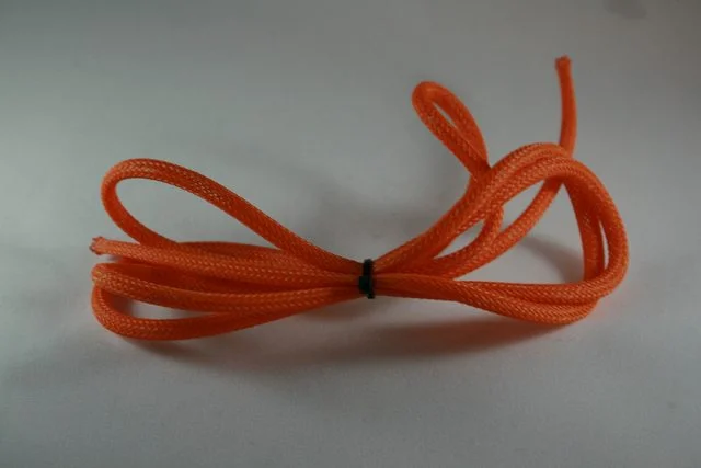

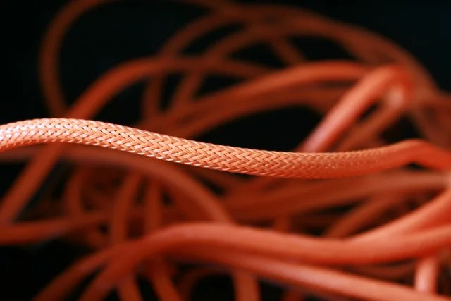

the colour the sleeveing is in the pan isnt the same as what you will get in the end, you MUST wash off the dye, this does take a lot of colour away from the sleeving, this is what i got in the end:

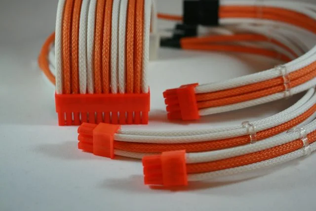

Some nicer shots:

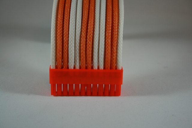

So, once id done this i thought i best actually sleeve something...
24 pin:
8 pin:

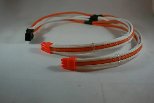

6 pin pci-e to 2 6 pin pci-e
Group photo:
I have got 2 more of the pci-e sets obviously for my other 2 cards, but i didnt want to over crowd the photos lol.

Well I never ! Wow dying the sleeve, never seen that before, its turned out great. Did you have to heat it up to simmer and maintain a certain heat? It looks like the liquid level dropped so was it boiling?
You'll need to put that on as a guide to the sticky. ;)
Yeah, put the dye in when it was around 60 degrees, bought it to a simmer and left it to simmer really. the water level did drop quite a bit, it would have been ok to top it up i reckon, but i wanted to see if the more i left it to drop, maybe the darker the colour went?

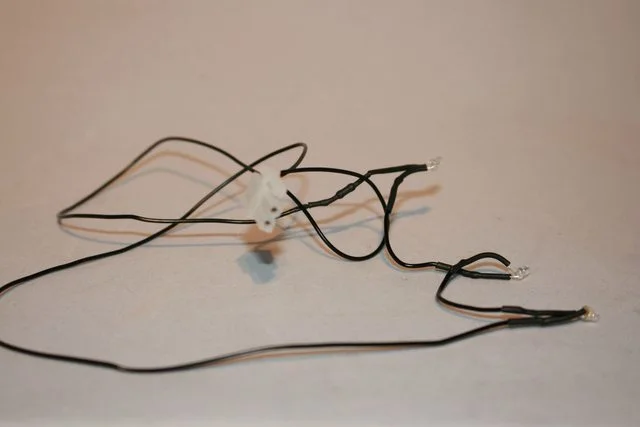

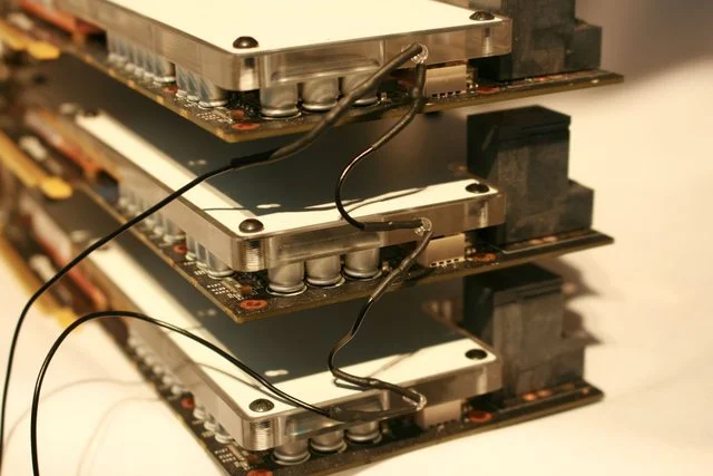

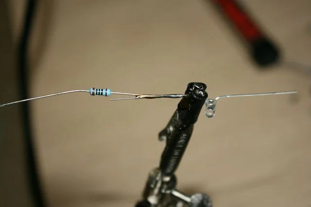

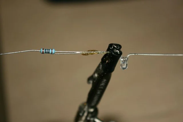

so, I got an LED and a resistor (the resistor im using is a ltitle lower than i need as i want it to be as bright as possible without actually blowing the LEDs, i will be adding 3 or 4 leds to this array. so this should be fine... hopefully.
im not the best solderer in the world, but this is how i do it: hold the LED and Resistor together with the croc clips, add a little bit of flux.
tin both the resistor and the LED (i couldnt really get a good photo of this as my hands were full lol, i tried to get some timed shots but my arms were in the way... BOOOO!
after, hold the solder iron with and solder next to the two tinned wires and just tap the the 2 wires and solder to form the completed joint.
after doing as many as i needed, i made sure all exposed wire was hidden under some small heatshrink. crimped the wires with some ATX pins and then put them in a 2 pin connector to make sure everything is as safe as possible.

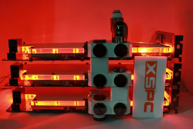

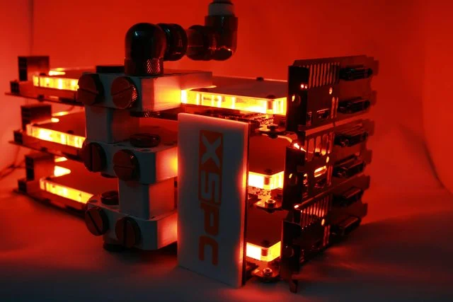

I then put these into the XSPC blocks, the XSPC blocks have holes for 3mm LEDs, they can sometimes be a bit loose, so i will be using a dab of glue from my trustee glue gun to make sure these stay in place when in transit (i go to LANS etc, usually you wont really need to make sure they are so secure!)
Then i turned them on :
Im really happy with these!!!
