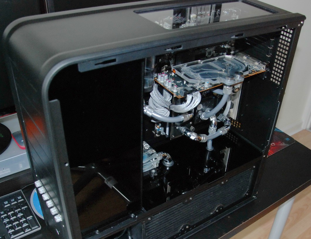

Took it apart about one week ago, did some of the cuts that I wanted and ordered some additional stuff like grey tubing to match the colour scheme I have chosen (Grey/Nickel + Black).

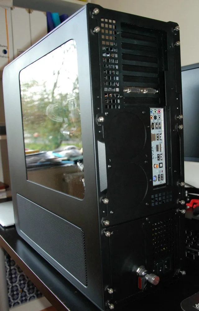

I cut a window into the side-panel as it ended up being an inverted version.
Pictures to come soon as I have them spread over iphone, compact camera and my dslr :-)
Currently I am applying the second and 3rd very thin coats of primer on the outside (only 2 thin coats for interior) and painting all other smaller bits.
I will return tomorrow with pics, ideas on how to finish this system in terms of some of the placements for HDD, etc and how to use the plexi (should I paint it as well or use it as is, IE: glossy black? )

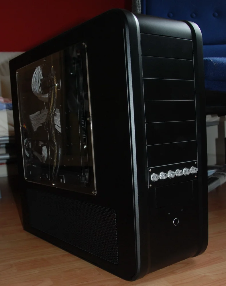

and months an months later I am back, with some pictures after painting the case after taking it all apart.
I have tons of pictures from the process, but I find it so hard to find time to select the right ones and post here so I will just post now what I have on my pc
I know it is far from what others do here in terms of attention to detail, but I think I did ok for my first WC and on a budget :-)
