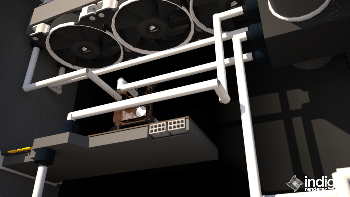

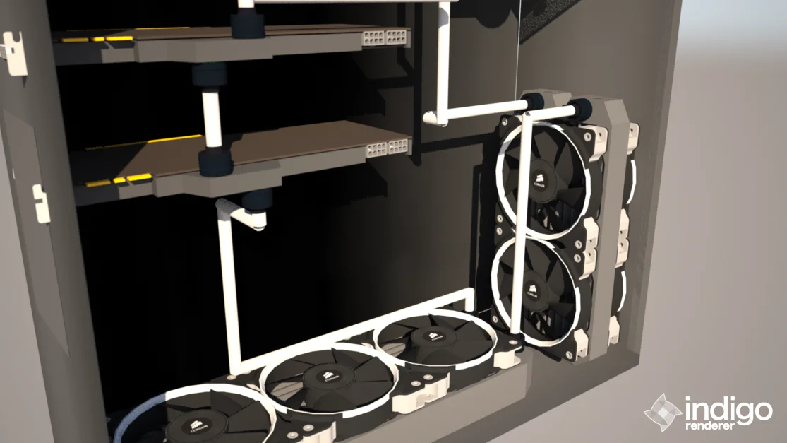

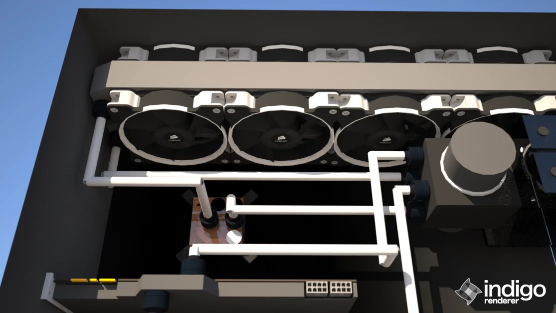

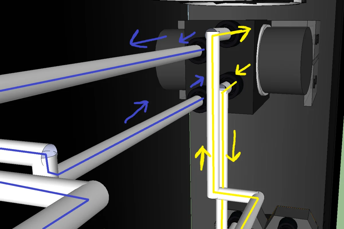

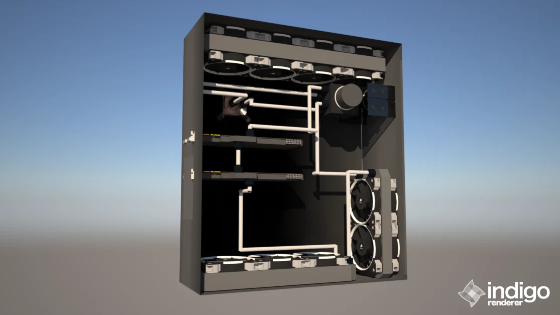

Here are some designs i mocked up for the water cooling, with white acrylic tubing as well as some fittings:

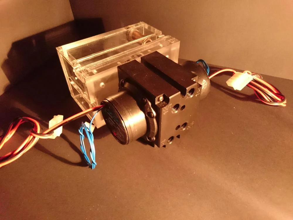

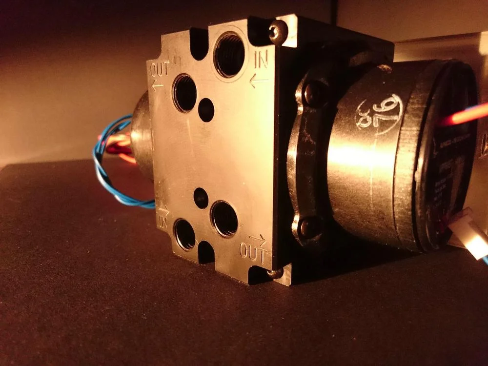

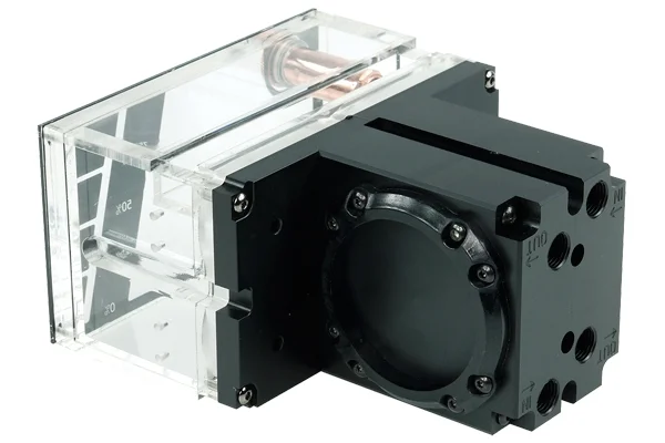

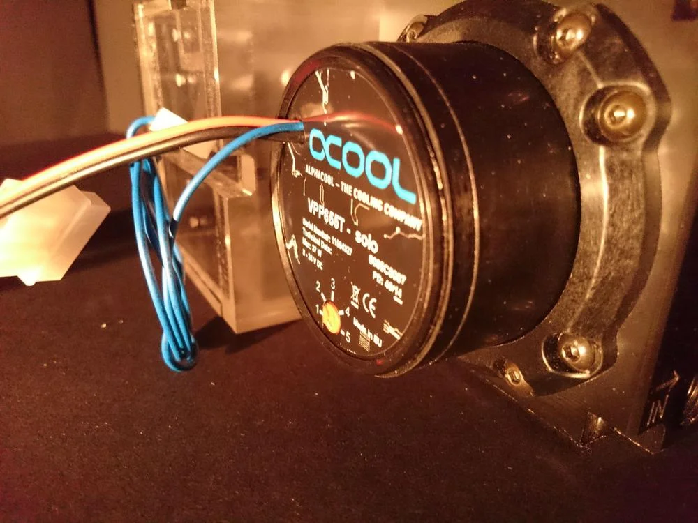

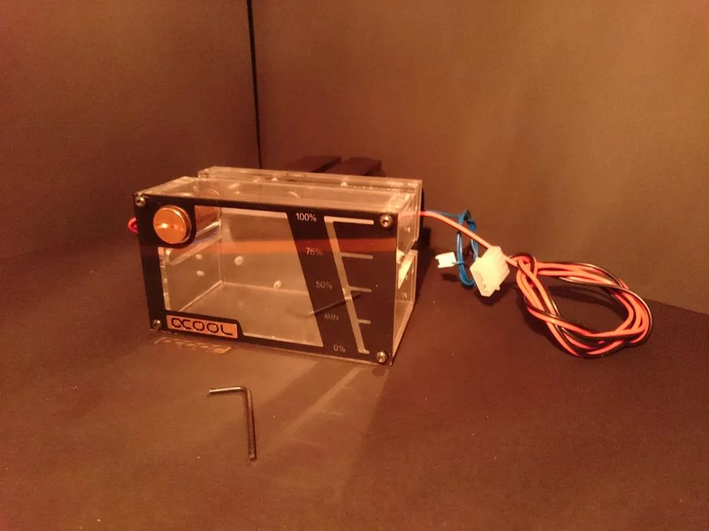

Quick diagram to show the flow, for those who dont know, the alphacool repack pump / res has 4 ports, two in and two out, here is a image to help:
Then here is how the flow should be within the case:

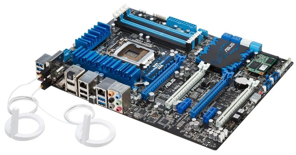

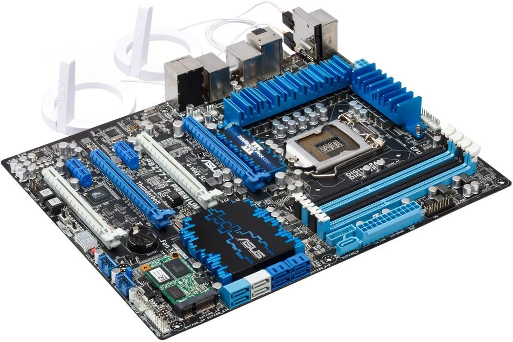

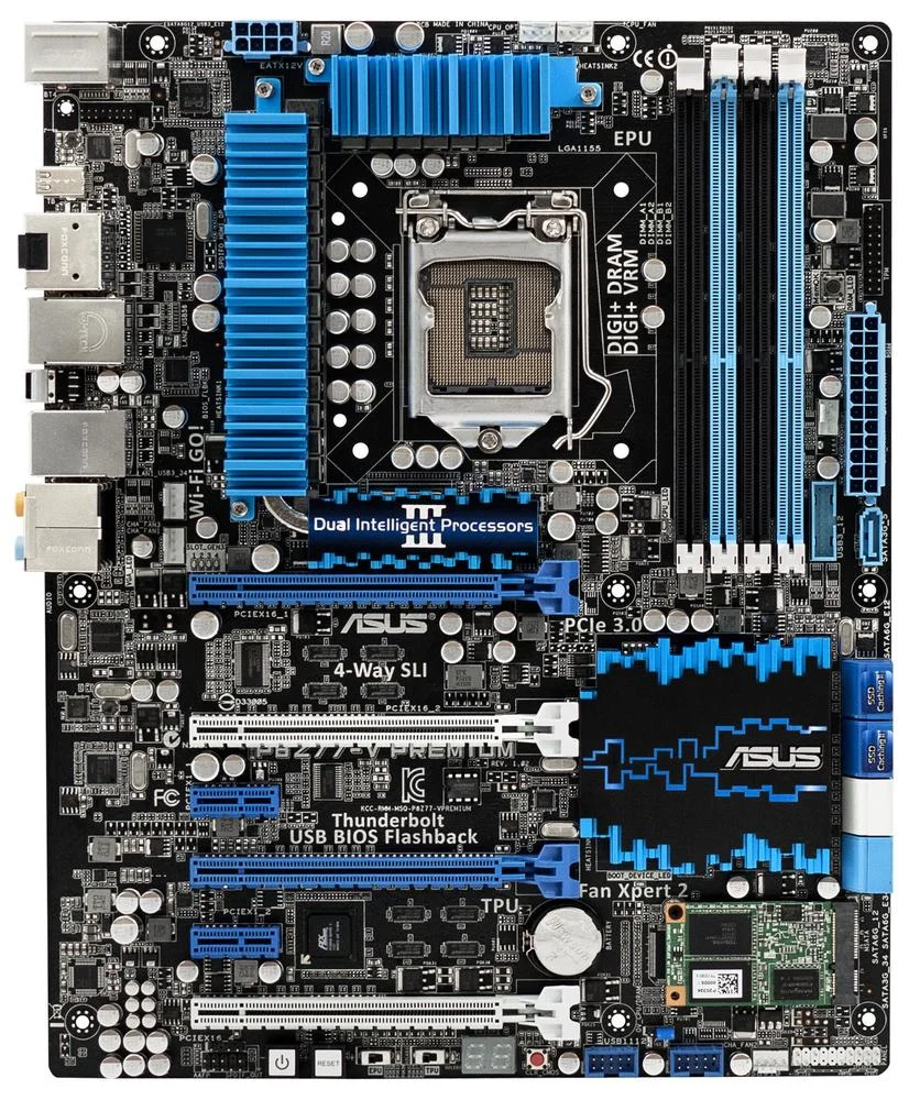

Afternoon :D so i know i said i wouldn't be upgrading any of the main hardware.... well i lied :D just purchased the Asus P8Z77-V Premium motherboard, that will be delivered this Saturday :D
The Enthoo Primo case will be ordered very soon :D as well as some other water cooling parts :D
Just some images of the motherboard :D very tempted with the idea of quadfire at the moment :D 4 x R9 290x? Means i will have to purchase a new power supply however :D that would have to be the new 2000W 8-Pack unit :D

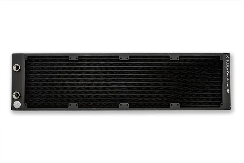

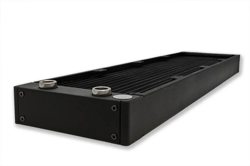

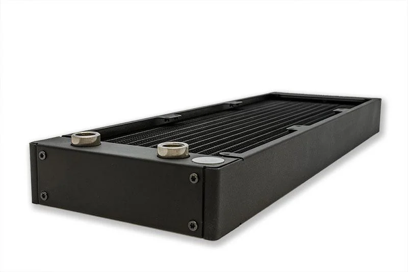

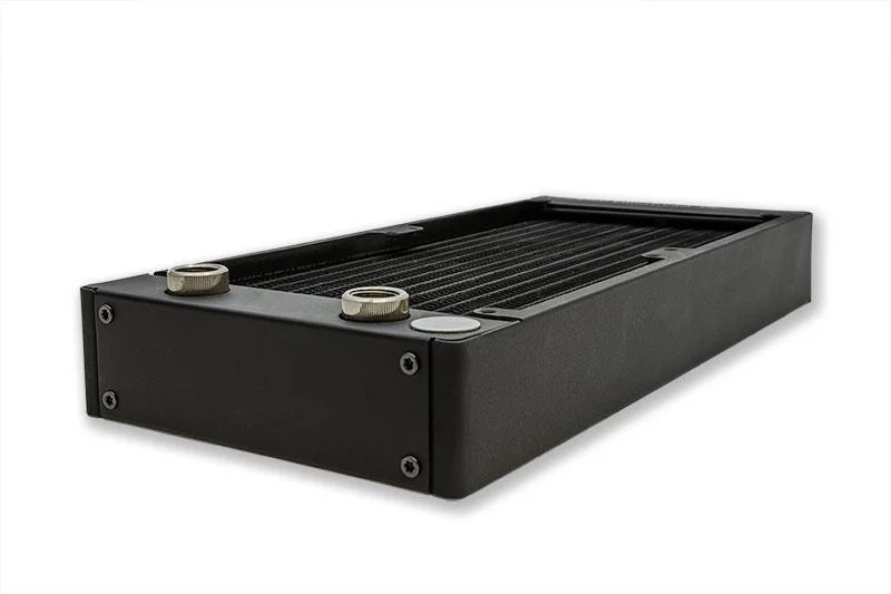

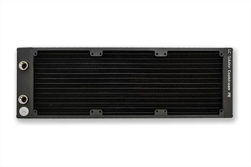

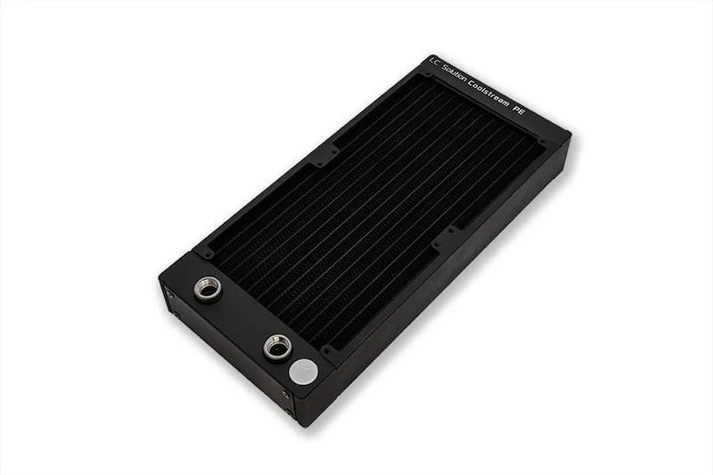

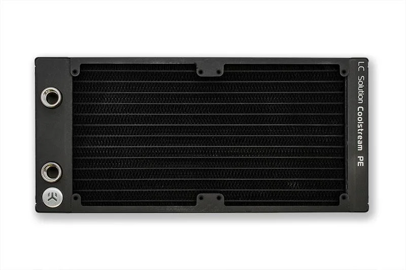

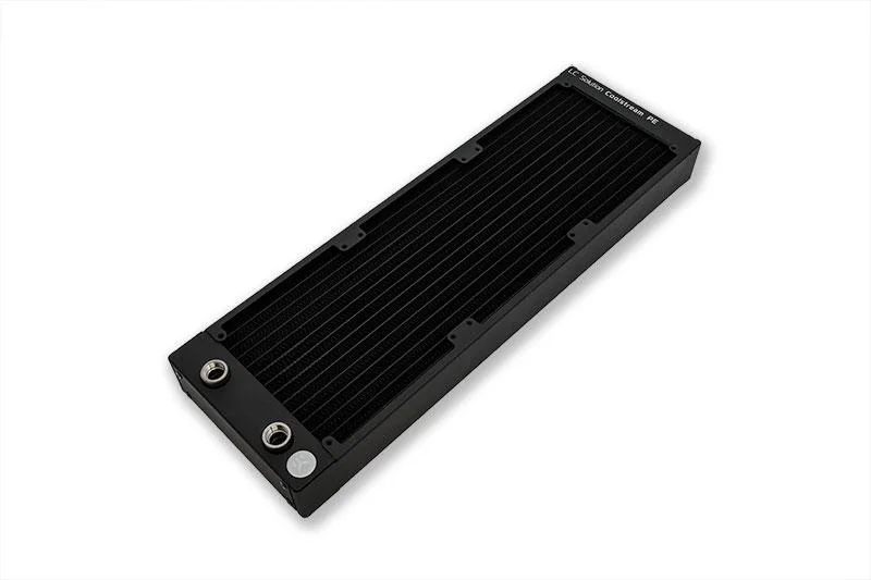

Evening all :cool: another little update, i was annoyed to see that overclockers had no longer got the EK coolstream radiators in stock, just ordered the very same radiators elsewhere.... for the water cooling side of the build, should be here Tuesday the latest :D
I truly love the design of the Coolstream PE series, how its sharp 90' bends as well as military looking :D love it
Some images of what they will look like:

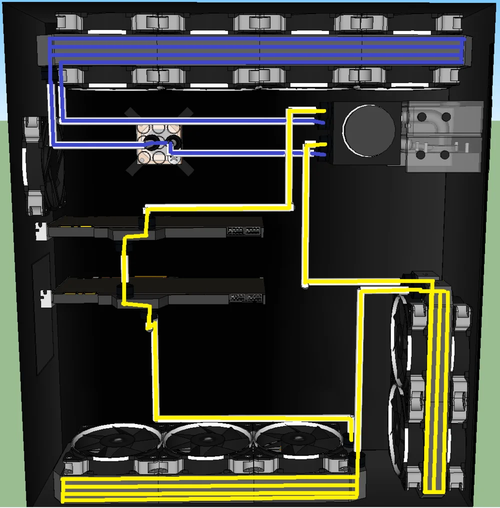

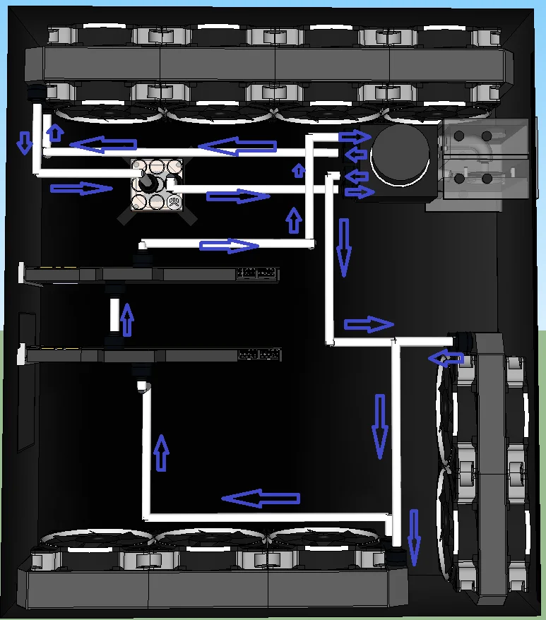

I don't understand this design choice; can you explain your logic?
You appear to have your four fan rad before the CPU, so I assume to keep the water temp low before hitting the CPU ensuring it is adequately cooled.
Then as it passes to the lower section of the loop (is it all one loop, or two?) it passes through two further RADs before hitting the first GPU to remove any heat from the CPU, but the second GPU has to make do with whatever its fed, after the first GPU has been cooled.
With three heat sources and three RADs I'd of through you would go heat source > rad > heat source > rad > heat source > rad (although clearly more awkward if at all possible with tube runs and dual GPU).
Its been a while since I've done any watercooling (Danger Den TDX & Peltier days) so interested to see how this pans out.
Hi ecksmen, ok so to break it down, there are technically two loops in my system that share the same reservoir (that being the Alphacool Repack).
From the left hand side of the reservoir, one D5 pump will flow liquid to the 480 at the top, then from the 480 to the CPU and from the CPU back to the reservoir.
The second loop on the left hand side will flow coolant from the second D5 to the 240 radiator at the front, then from the 240 to the 360 radiator on the bottom, from the 360 radiator to the second GPU and then from the second GPU to the first GPU, finally flowing back to the reservoir.
Another more simplified diagram to show you the two different loops:
BLUE = CPU
YELLOW = GPU
More to follow :D
Another example just to make it REALLY simple :P

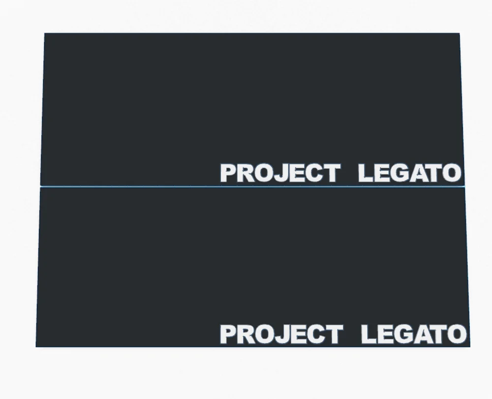

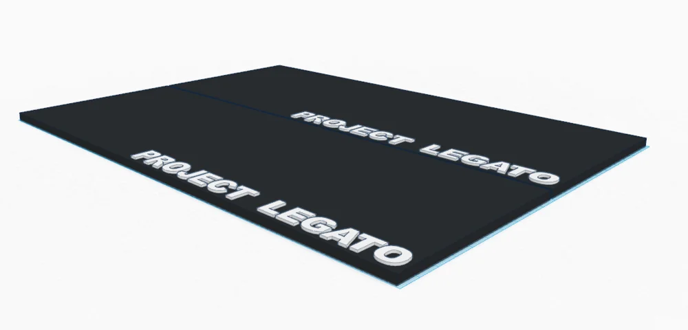

On the other hand however, i have been designing some backplates to cover both of the R9 290x cards :D
simplistic design with an elegant show for what the computer is called :D
What do people think?
The material used will be plastic, i will custom paint "Project Legato" white, then i will custom drill the holes for placement, both covers will rest on the head of the screws :D

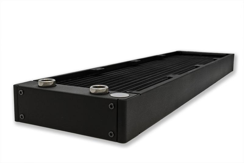

Update 6
Something good for a change........ :p

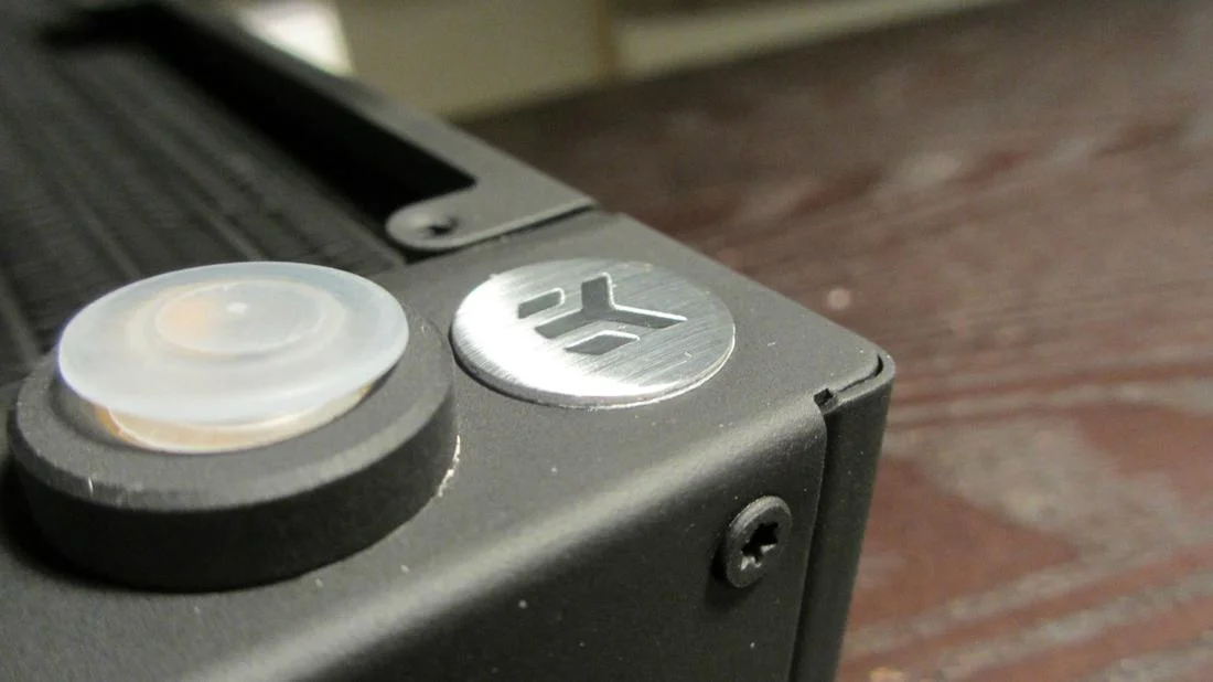

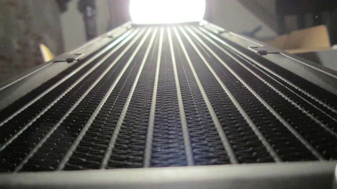

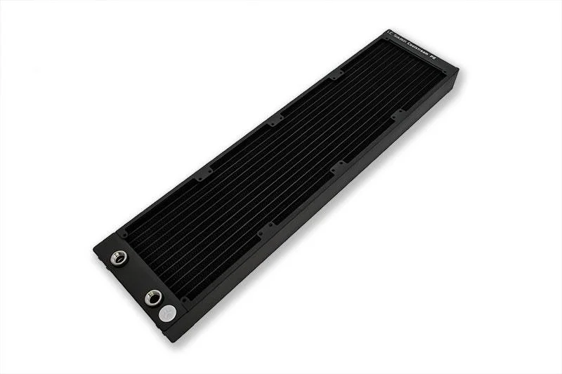

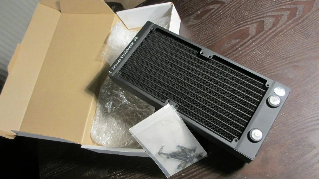

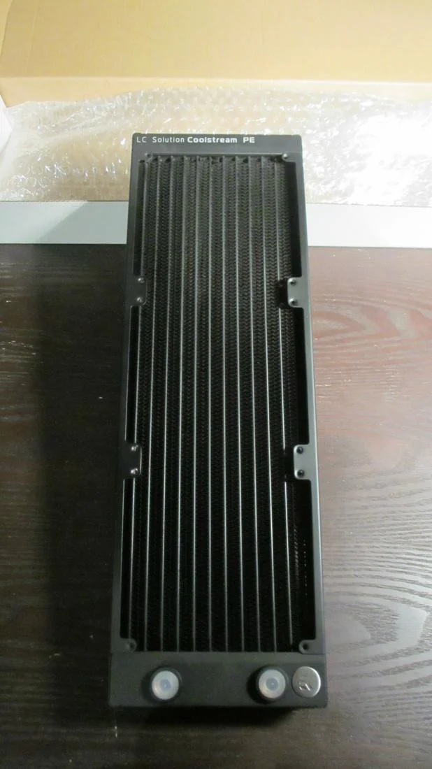

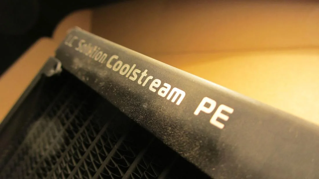

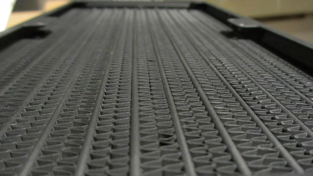

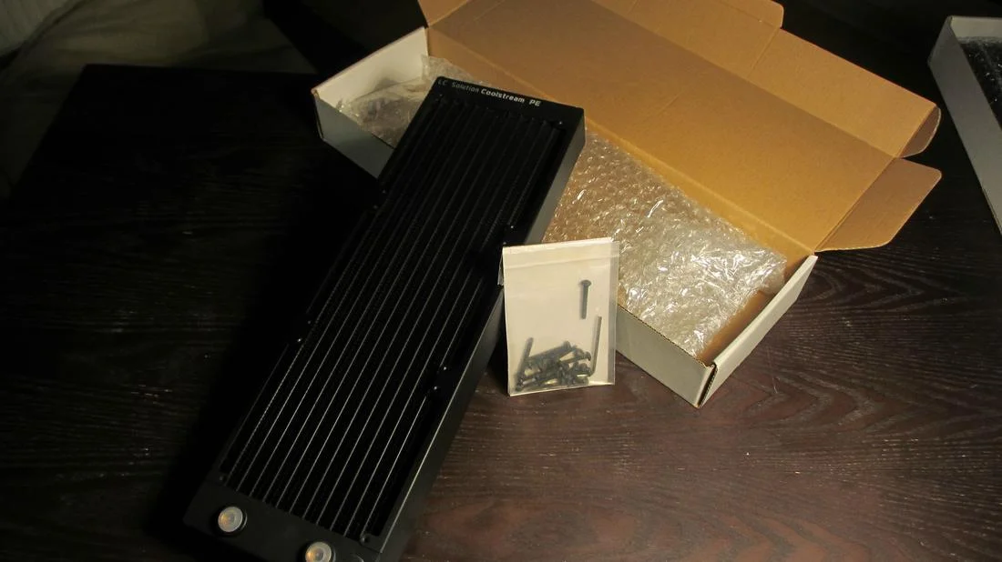

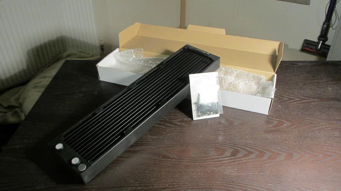

Got the radiators, so took some photos :) seriously impressed with the quality of the finish :D
Cannot wait to see them within the build :D
Fins upon fins leading to radiator heaven :D
More to come :D :D :D
