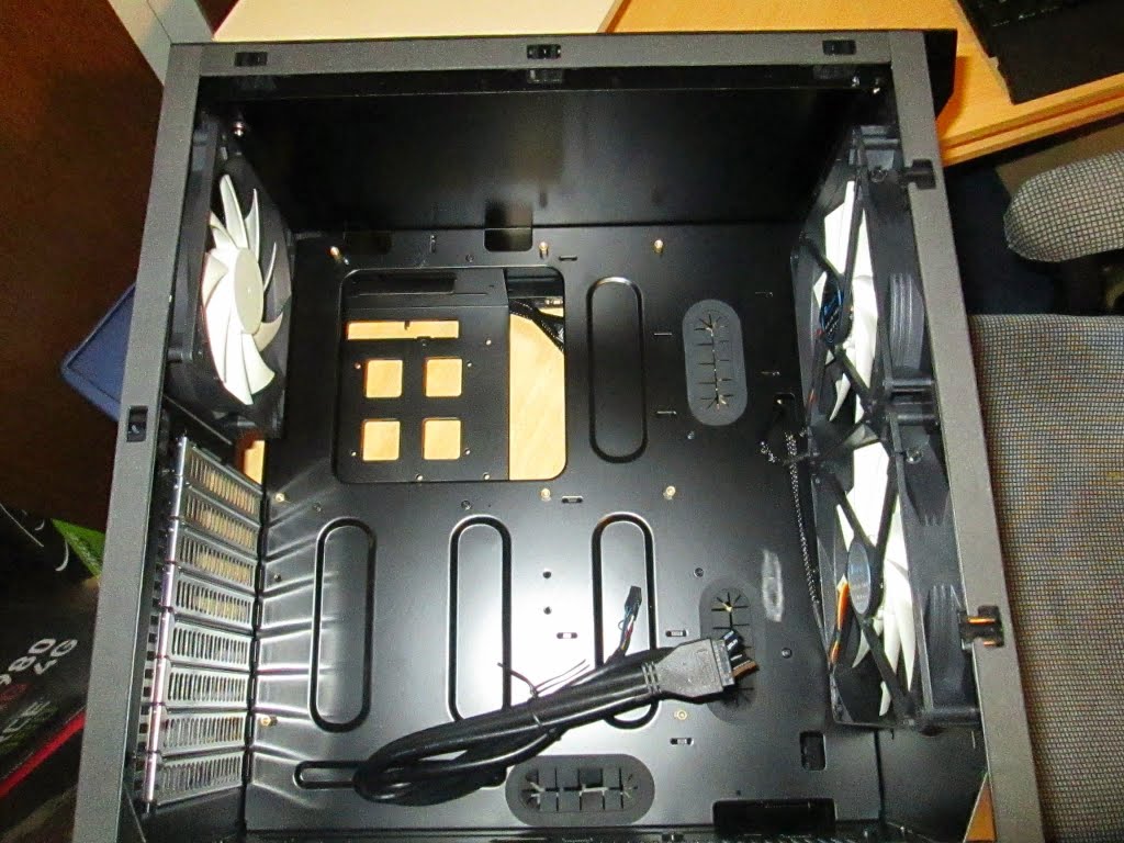

Inside of the left side of the case. Looks unbelievably tiny! I think this is actually the smallest case I have ever owned.

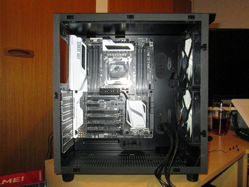

The motherboard installed... only I had to remove it again because I had to install the heatsink first, d'oh!
And this is the heatsink, rather unconventional that it's sideways rather than the tower like heatsinks, but it is what I knew would fit in the case.
And here is the heatsink installed... now the snag here is that when the fans are installed then the graphics card doesn't fit in the first slot! This means that I will need to turn the heatsink around a full 180.

The RAM, heatsink and fans are in place.
The bottom fan is offset slightly due to the heatsink's pipes on the other side. You can see that the CPU power cord hidden to the right is required to be connected before the bottom fan is installed, it made the build rather awkward because of it. Also the RAM slots are full covered meaning that the bottom fan will also need to be removed when I need to install more RAM.
The left side of the case with everything installed before wiring.
The finished wiring in the main area. It's not brilliant though for my first attempt I think it's OK. having separate braided wires instead of being clumped together would've looked much nicer and easier to work with.

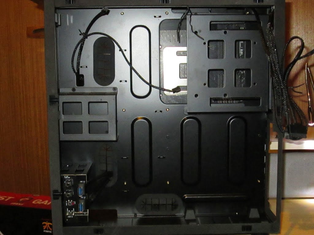

The right side of the case before anything goes in there.
The SSD, HDD, and the PSU is installed with the CPU cable installed.
The finished wiring in the hidden area.

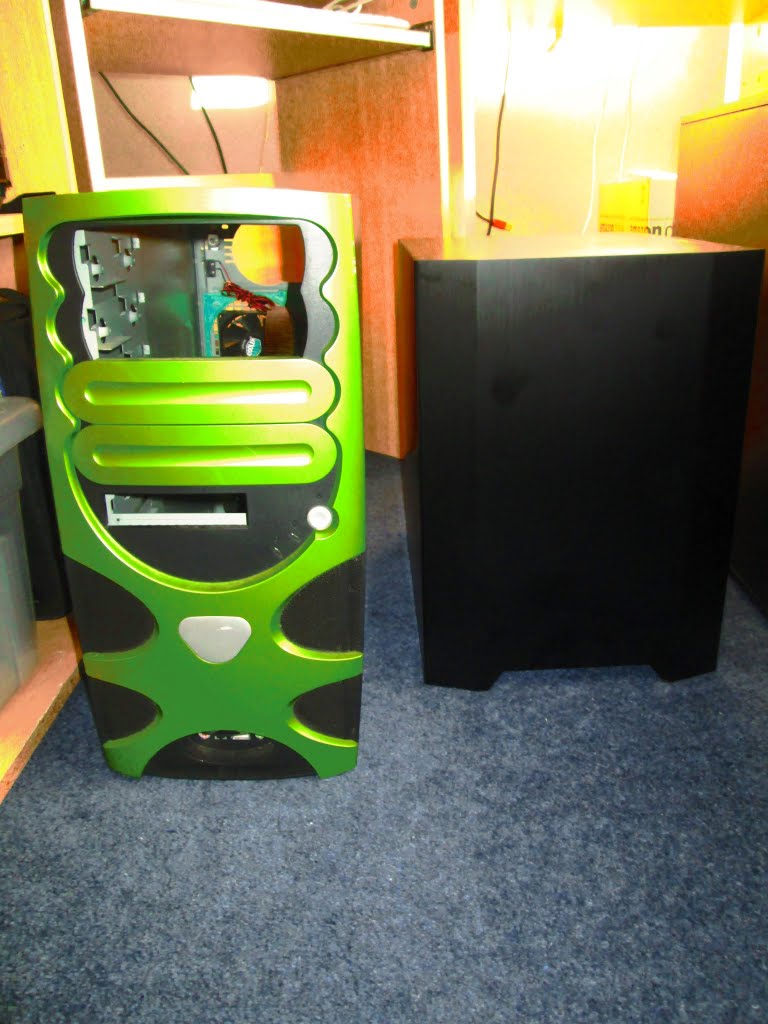

Size comparison of my old PC (top) and this new PC (bottom). It is so short.
A height comparison of the two, This case makes the Antec P280 look absolutely massive! While it is big it's certainly no where close to a full sized case as it's only a mid-tower.
And a width comparison, the only part of the case that is actually wider, but not by much.
I decided to compare the size to my old Chenbro Gaming Bomb that I picked up back in 1998, that case at the time was an amazing case but it was so small and certainly high end, but for what's in it (of lack there of) it weighs more than everything that's in the new case! The Chenbro was a steel case mind and it had lots of sharp edges. :D
And a height/width comparison. This Cooltek case makes this already small Chenbro look huge too.
