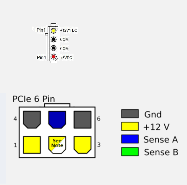

I need to power my pump off the psu, but it currently uses a molex connection with a molex to pcie adapter. Is there a way to mod the pump cable to go directly to the psu?

It's not my fortay but I have wired stuff up before so surely you just copy the layout from the extender but using the actual cable (Sorry if it sounds confusing) :)
Edit: This diagram might help
