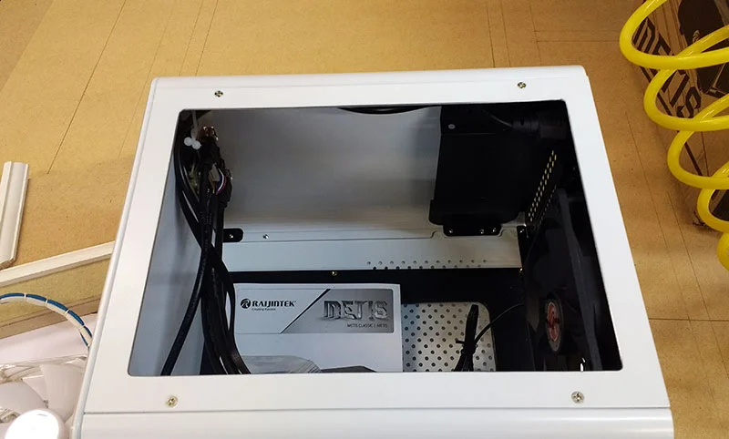

This is how its all starting.
I've ordered a few parts already and I'll update this thread with the modifications as I go.
Wish me luck!

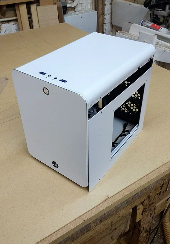

I had a little time to work on the case last night.
One of the first mods is to make the acrylic window on the side of the case bigger.
This can be done by cutting a sheet of acrylic to the same size as the panel, drilling a few holes and its done.
I would have done it this way but the only thing that puts me off is you can see the inner frame through the acrylic.
Instead I decided to leave a small parameter of the panel in place then later I can fix the acrylic to it. This should leave me with a nice large viewing window and all the fixings and inner frame are still hidden.

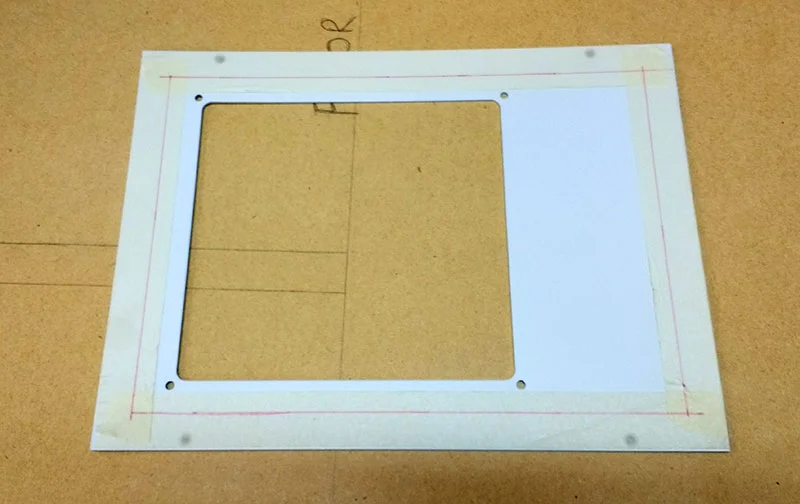

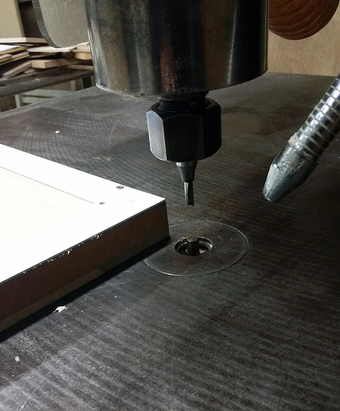

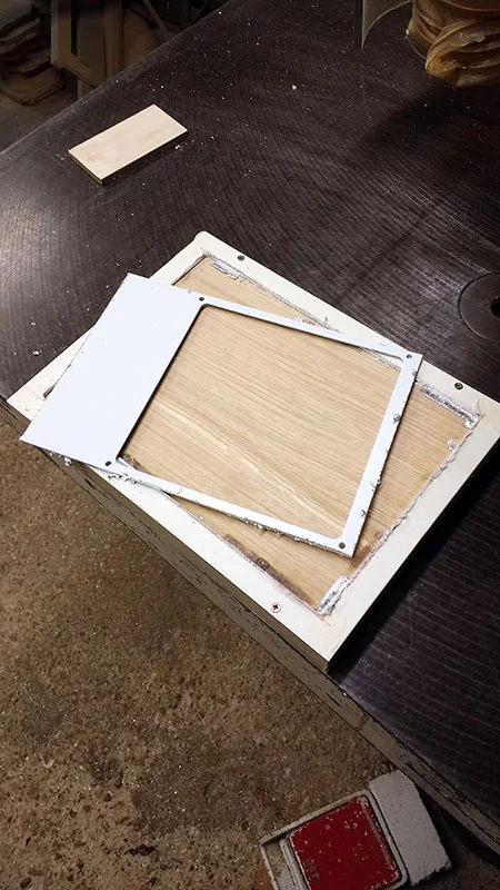

I started by marking out.

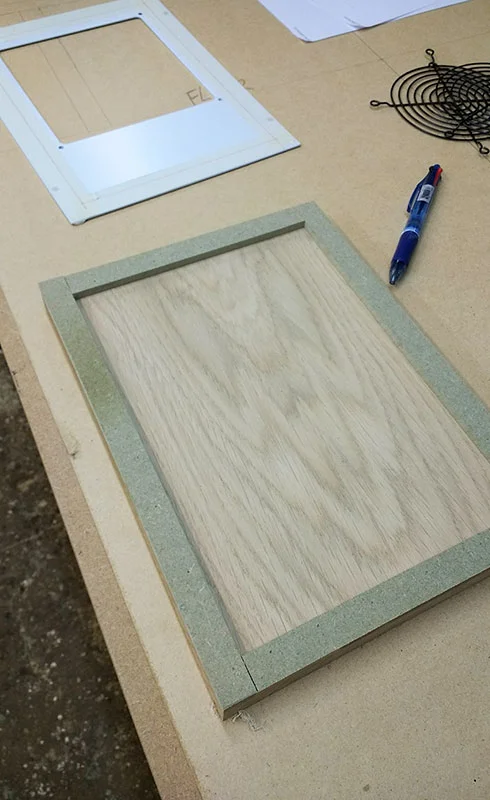

Next I made an exact template of the panel from MDF with the required margin pinned around the side.

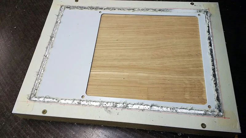

Using an over head router with a following pin the same size as the cutter I can use the template to make an exact cut onto the panel.
After the first pass. the ragged edges is the masking tape being torn to bits. The cut into the aluminium is clean and sharp.
After another couple of passes the cut is complete.
This cut could have been easily made on a CNC but I don't have access to one of those so I have to do it the old fashioned way ;)
Here I'm filing away the sharp edges being careful not to catch the paint.
And with the panel fixed back onto the case. Its a perfect cut no need for any sanding.

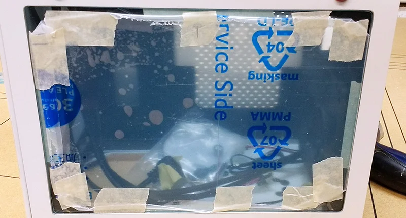

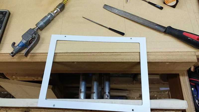

The acrylic came yesterday so tonight I finished off the side panel.

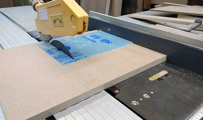

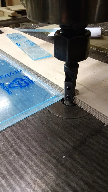

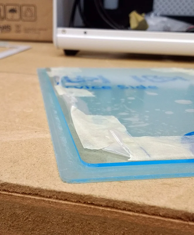

I started by cutting the acrylic to size on the dimension saw.

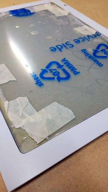

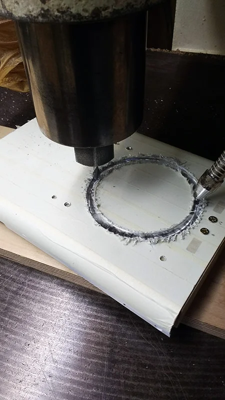

Then went to the over head router again to machine the rebate into the acrylic but I ran into a little snag.
I've machine acrylic before and all went as expected however this time the cutter started to melt the acrylic.
I'm not sure if its because this is a different type of acrylic or that its just thinner than want I've used before?
Luckily I tried it on a test piece first so no damage was done.
I got round it by focusing the air blower directly at the cutter and took shallower passes.
Thankfully it came out ok.

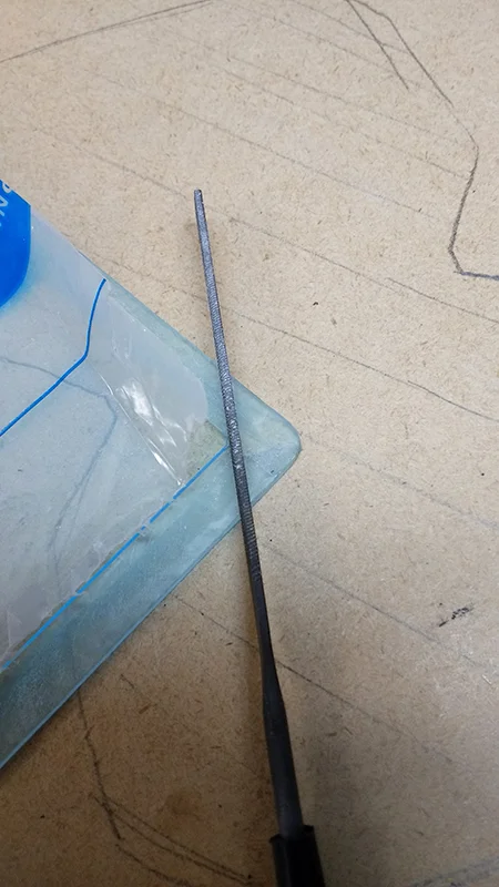

I found a needle file was the easiest way to round the edges.
Here it is fitted to the panel.
and a closer look at the rebate.
I think it looks nicer as the acrylic is flush with the panel. The original acrylic panel is fitted in front of the case panel and held in place by bolts.
I think this is a cleaner look. I'm just going to use strong double sided tape to secure it into position later.

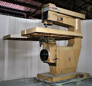

Routers are awesome pieces of kit for doing stuff like that
Very versatile machines though this ones a bit of a brute! Similar to this one

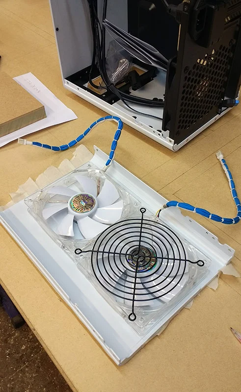

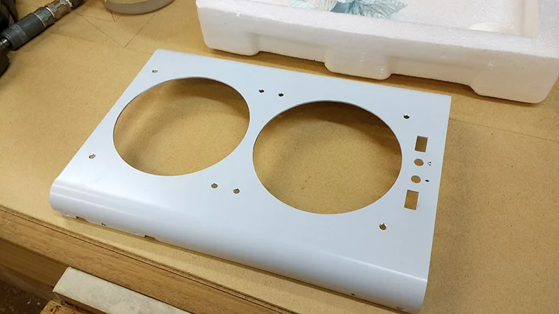

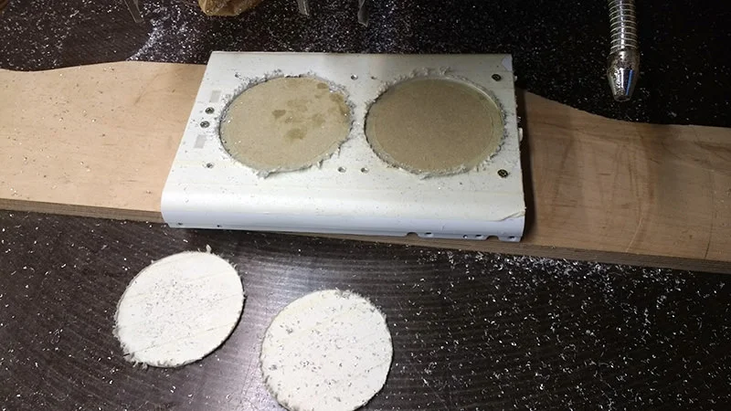

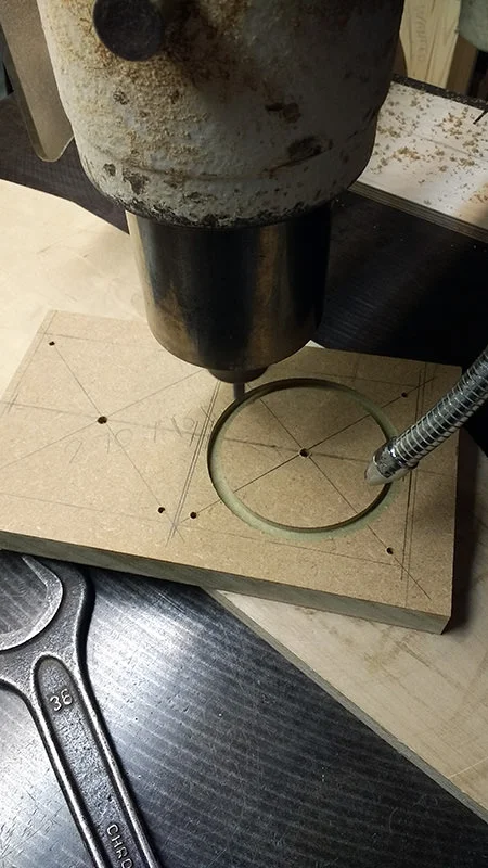

As I'm hoping to put a gtx1070 into this case I needed better air flow.
One of the main reasons I went for the original metis case rather than V2 is because I want two fans at the top of the case.
The V2 metis has a square filter with a fan already fitted at the top. I could have added another square filter however I prefer the look of round filters and guards so I set about cutting my own.

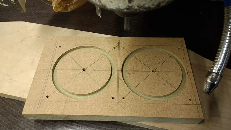

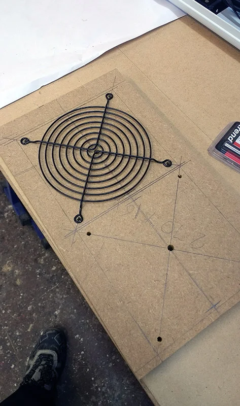

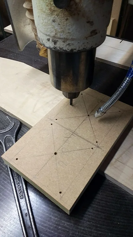

I started by making out where the fans will go. As you can see it's going to be a tight fit!
Next I relayed those marks onto a piece of MDF.
From there it was back to the OHR with a spinning jig to make sure the position of the holes where correct.
The router cuts a perfect circle and much cleaner than a hole saw. The first hole looks right.
Thankfully the second hole looked good to so no adjustments where needed.

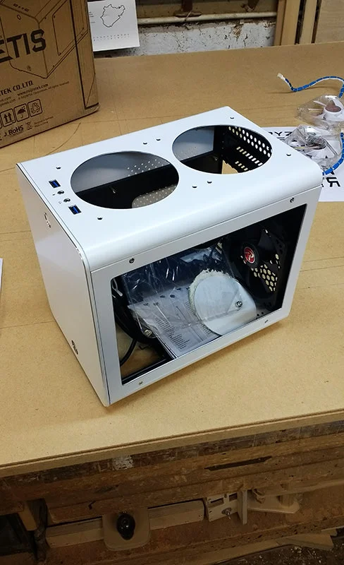

From there I fixed the case top to the MDF and cut the holes.
Both holes cut.
All thats needed is a light sand to take the arris edge off.
And with the top fixed back onto the case.
I still need to mount the fans but I've more to do yet ;)
