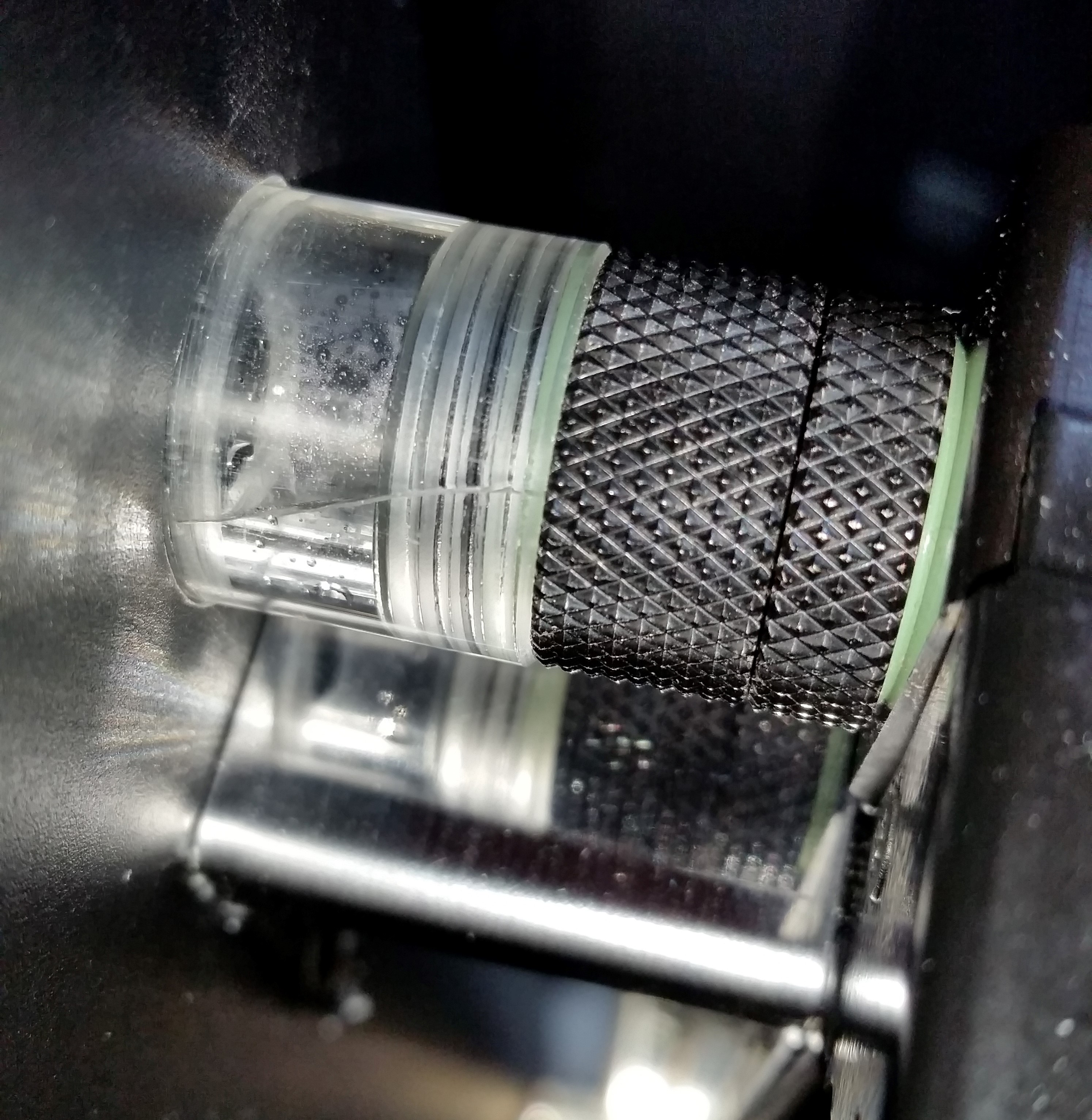

Had played a bit of State of Decay and then was dealing with some email. Odd gurgling noise. Had a look and the res was just about empty! Turns out the only pieces of cast acrylic left (other than the blocks) had failed. I'd seen crazing on the Barrow filter and the Barrow 60mm link tube previously used as a riser to the GPU. They pressure tested ok but given that you could feel the fractures with your fingernail I replaced them anyway. The only ones left are the links to the rad and they'd looked fine...Nope!
Top one has split end to end but on the bottom surface where you couldn't see it. Didn't need to bother putting in a drain after all! :rolleyes:

Took me a little while to work out where it had leaked from too! In that pic, the tube has been rotated but normally that split was pointing straight down so you couldn't see anything - even though it's clear.

So, where are we now? Well, parts should turn up on Wednesday to replace the acrylic links to the rad. Good job I had a play around as just straight replacing 20mm tube with 20mm worth of extenders didn't fit!
For now, I've cobbled it together with a variety of spare parts: a Barrow 10.5mm F-F extender, an EK 8mm M-F extender and a Barrow 15mm M-M rotary. Spurs were suitably sharpened before assembly *jingle* ;) The lower link is still as it was....and that doesn't make me at all nervous *cough* Still, I need to get some gaming in at times over the weekend.
