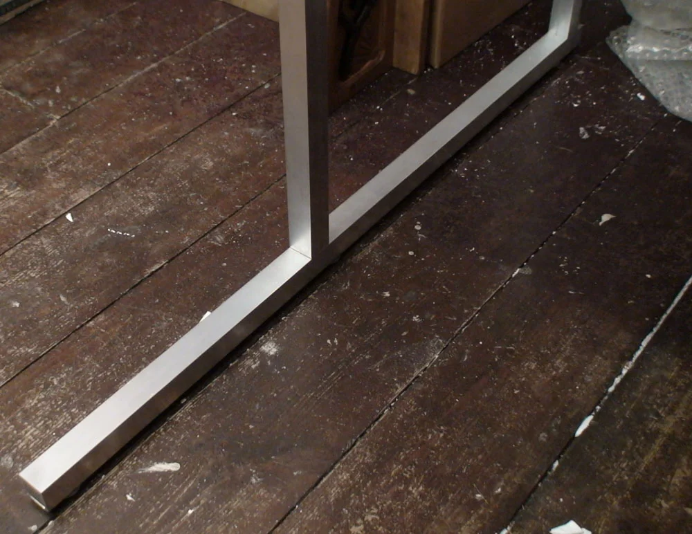

Here's where we left off, I was about half way through the leg pieces, they had incomplete uprights and no end caps.

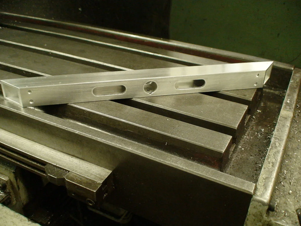

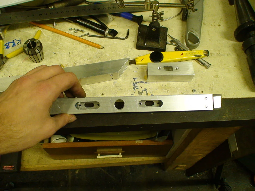

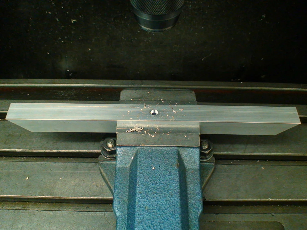

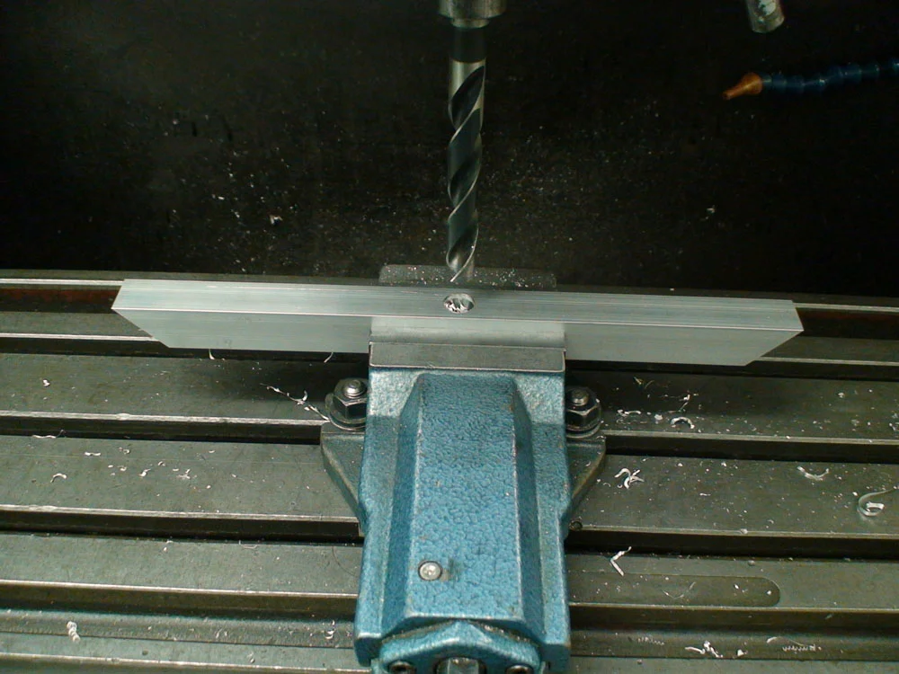

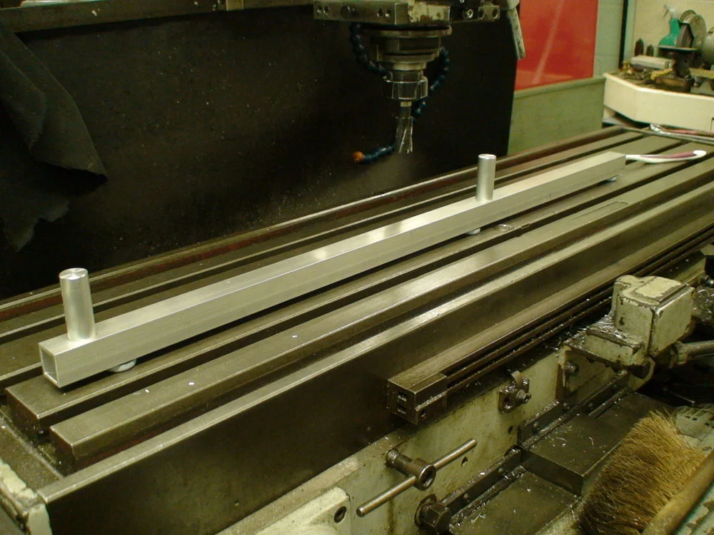

Finishing up the leg attachment bars

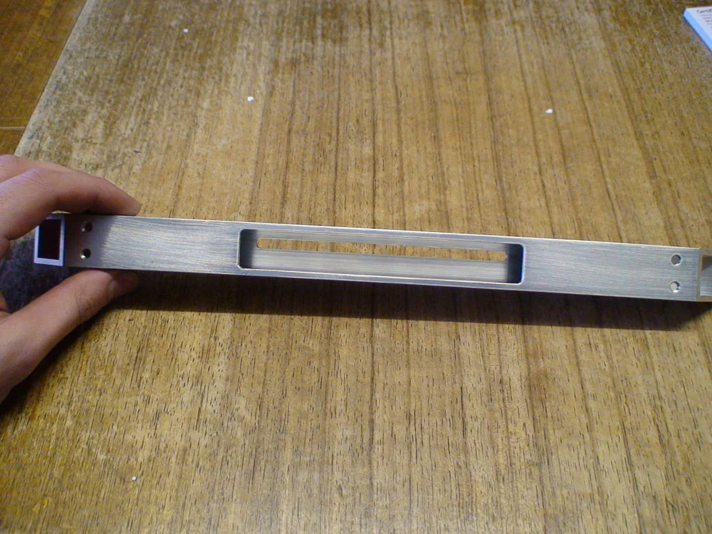

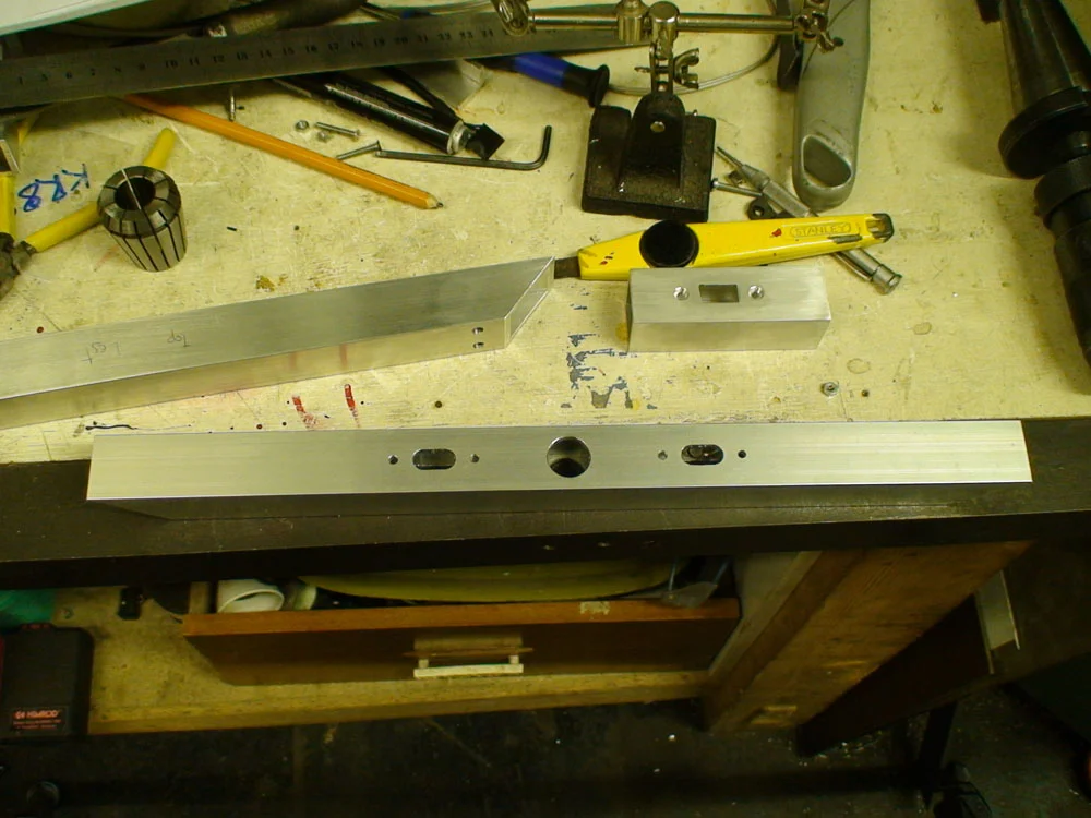

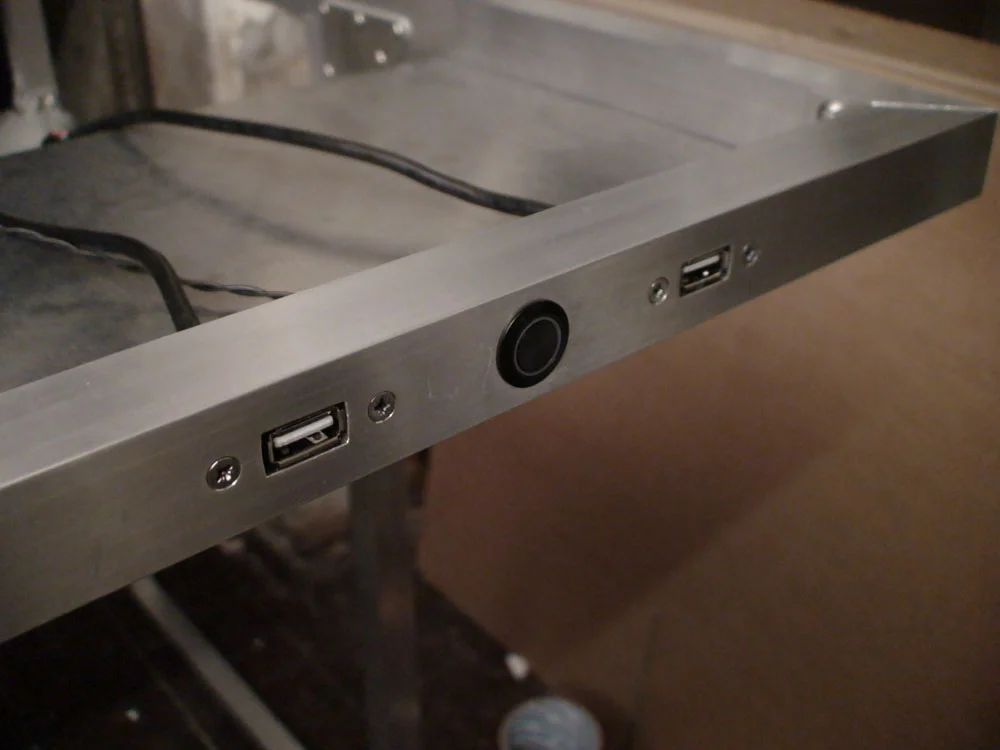

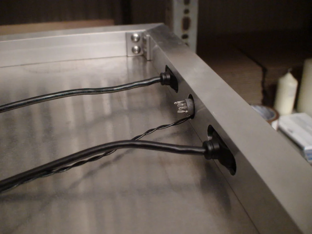

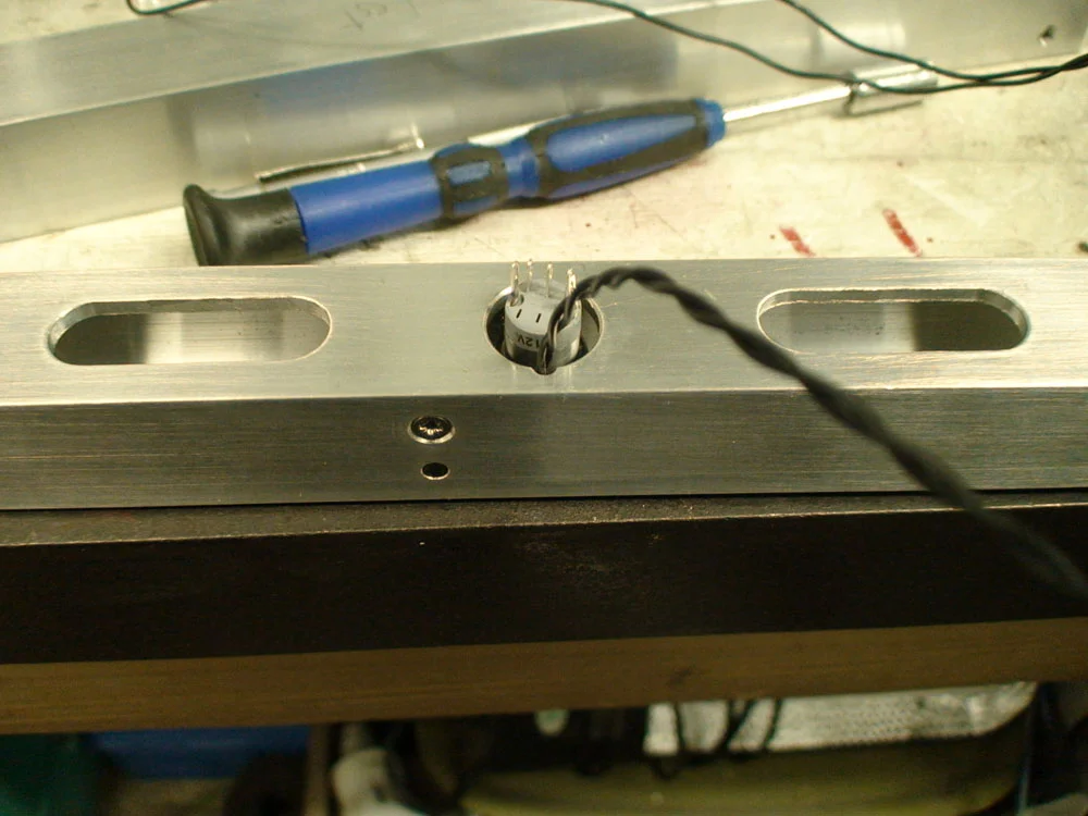

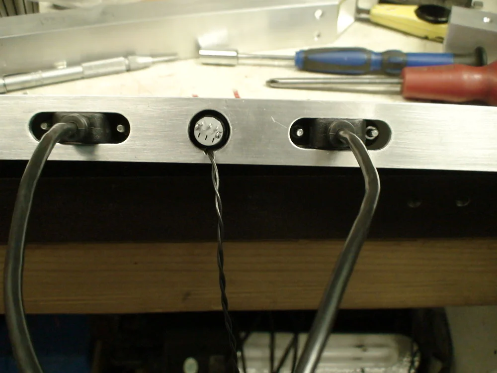

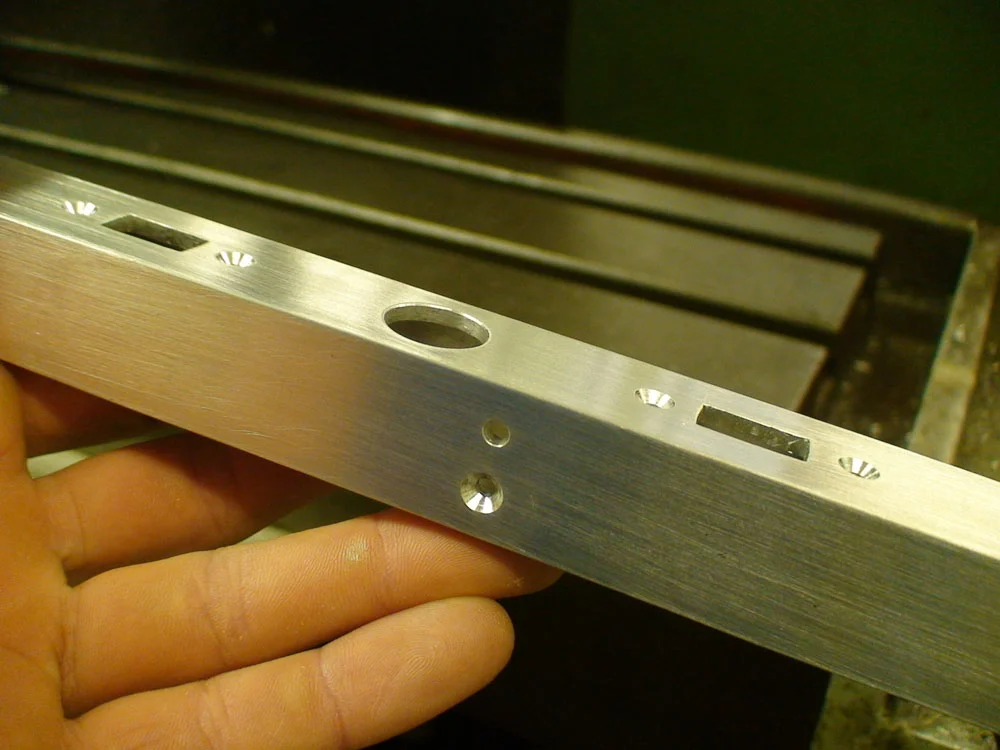

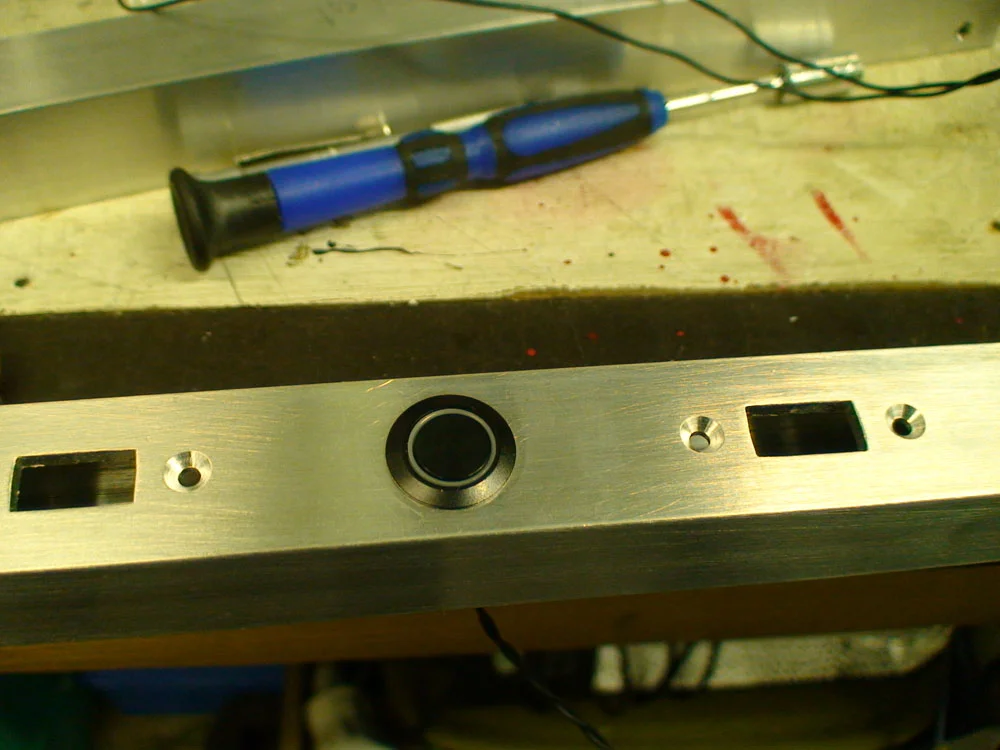

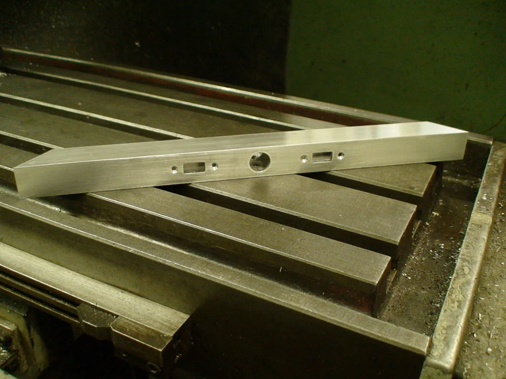

Making space for the power switch and usbs

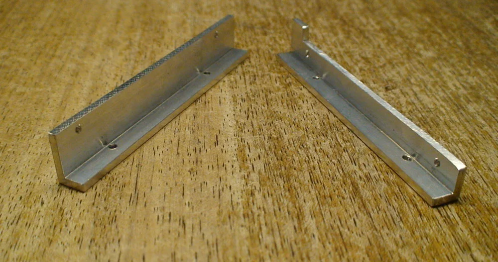

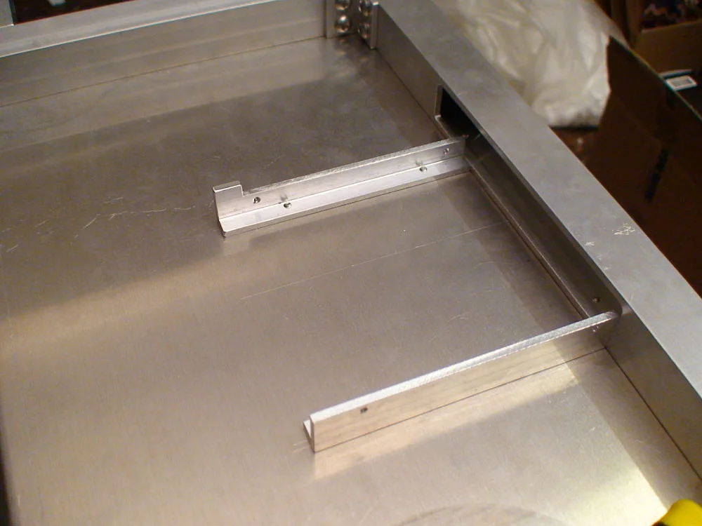

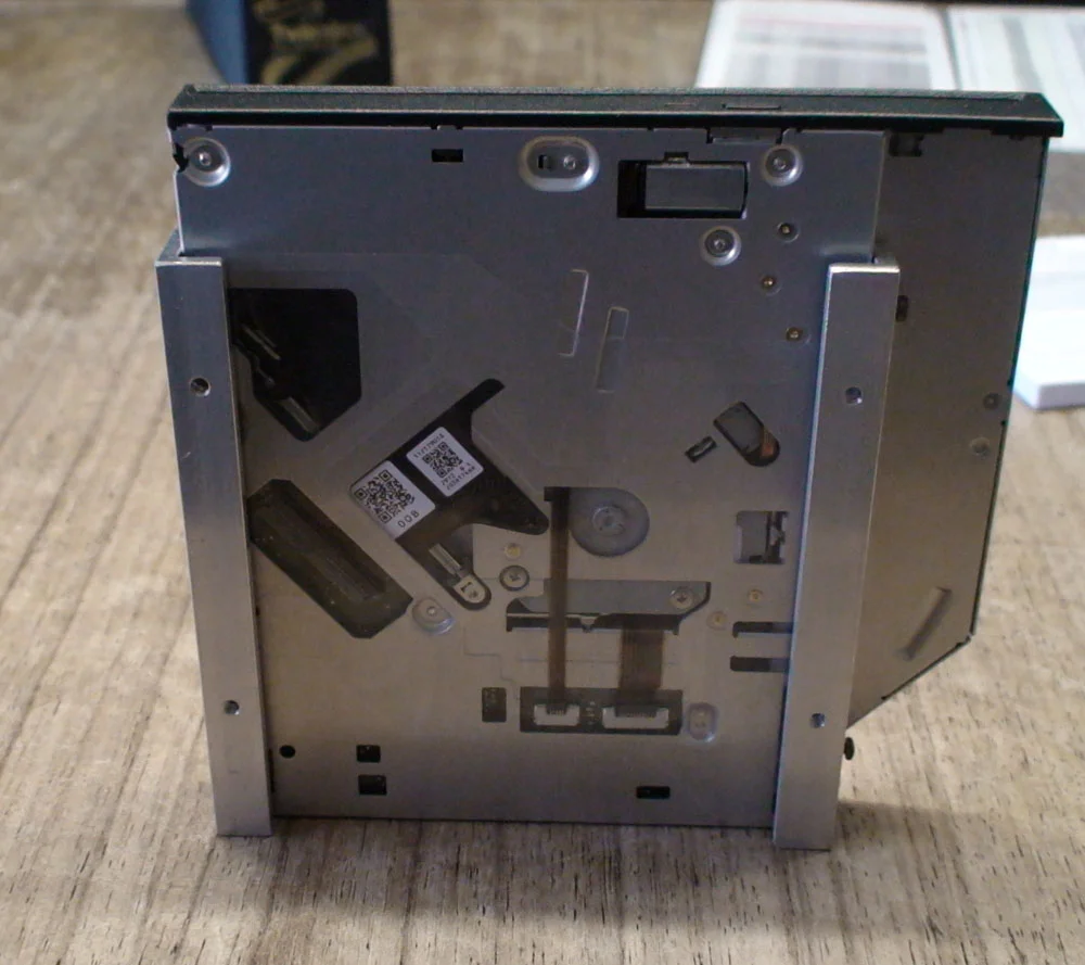

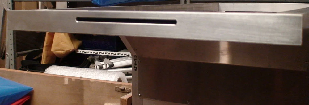

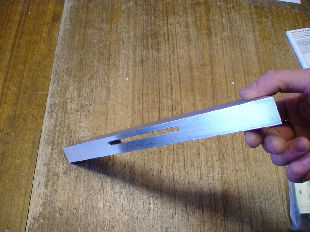

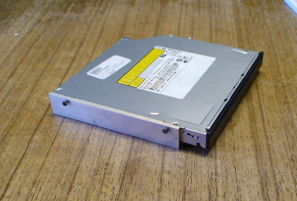

Milled the slot for the DVD drive

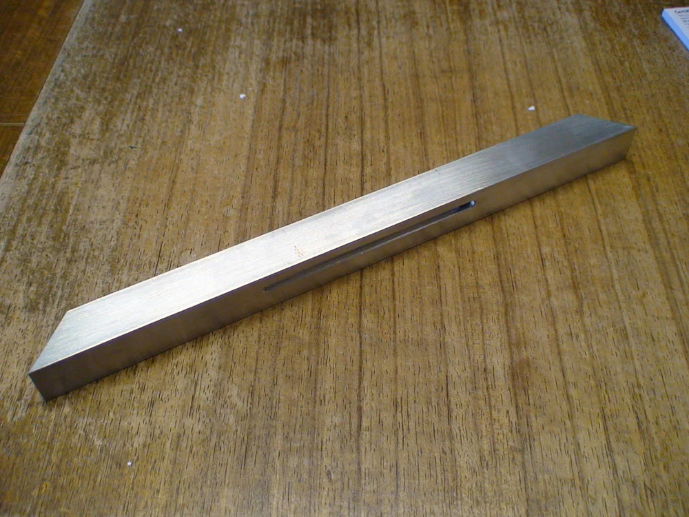

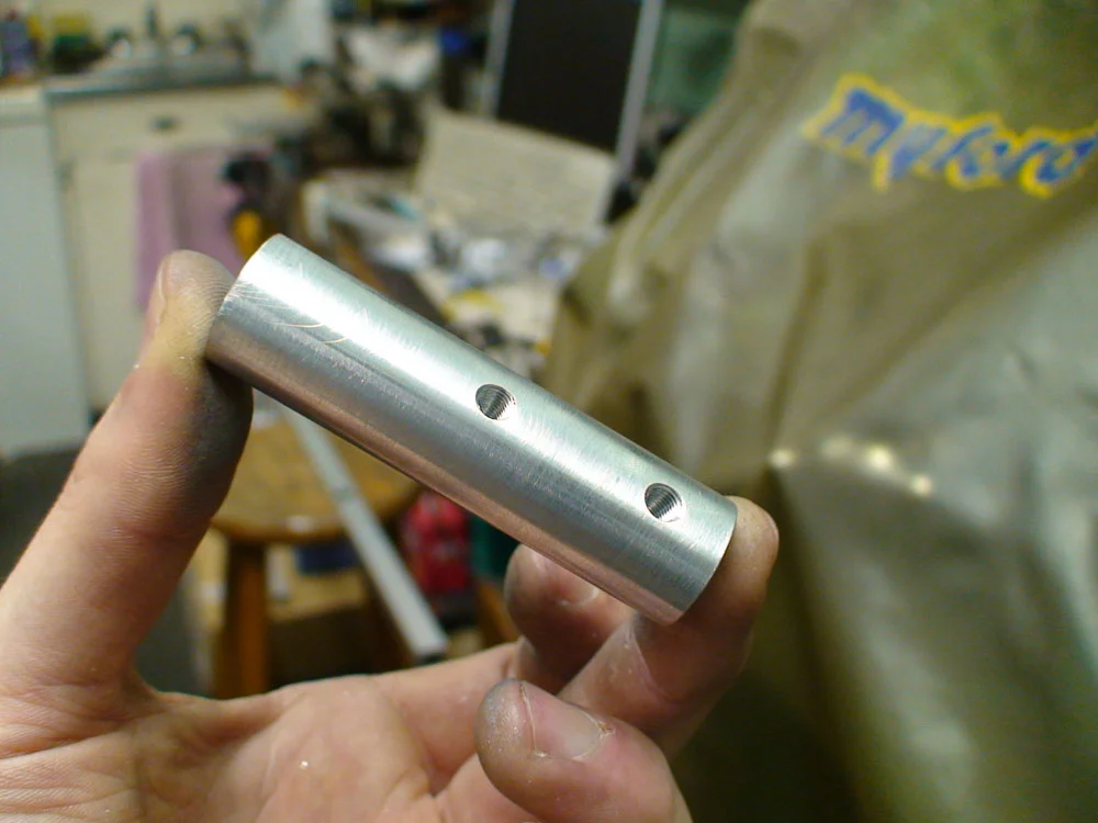

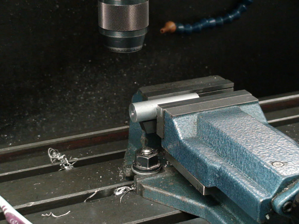

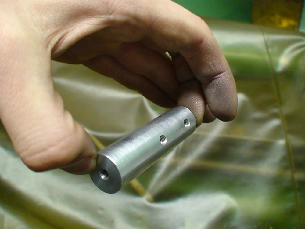

These were a bit of a pain in the arse to make... but the came up nice in the end :)

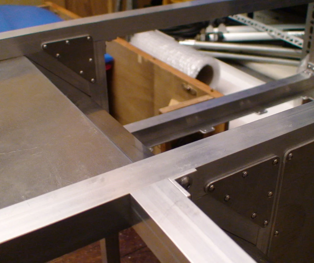

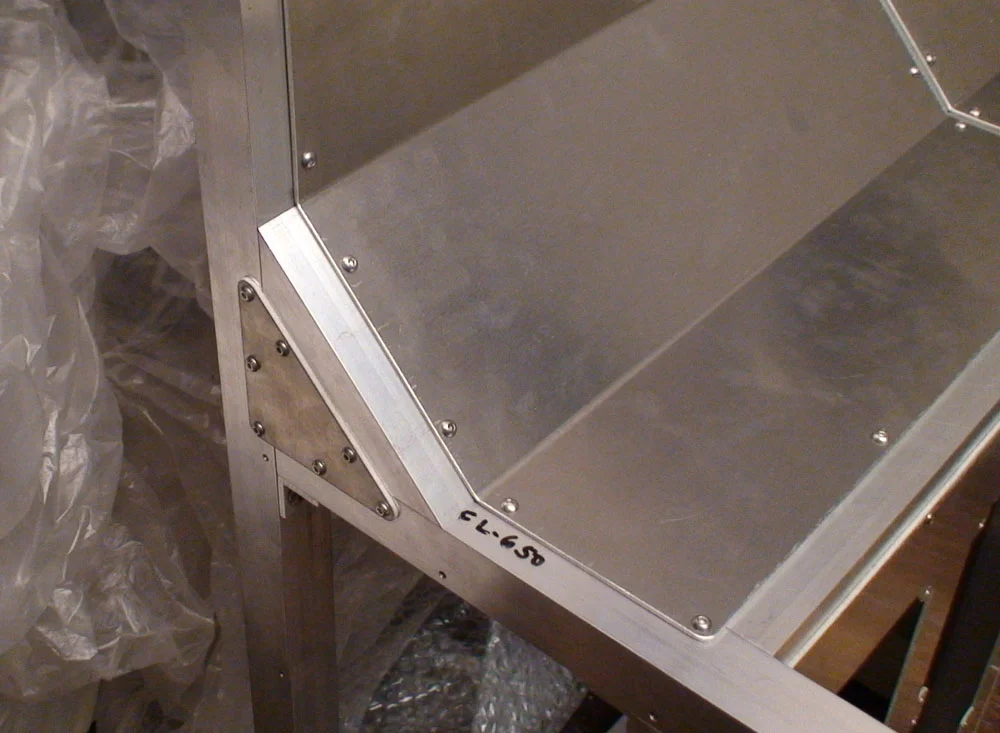

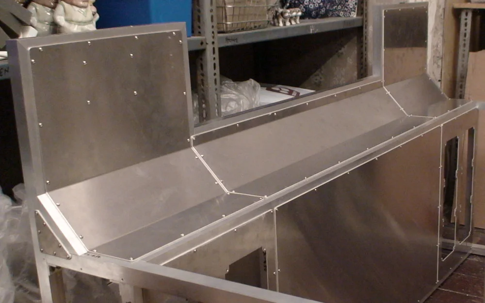

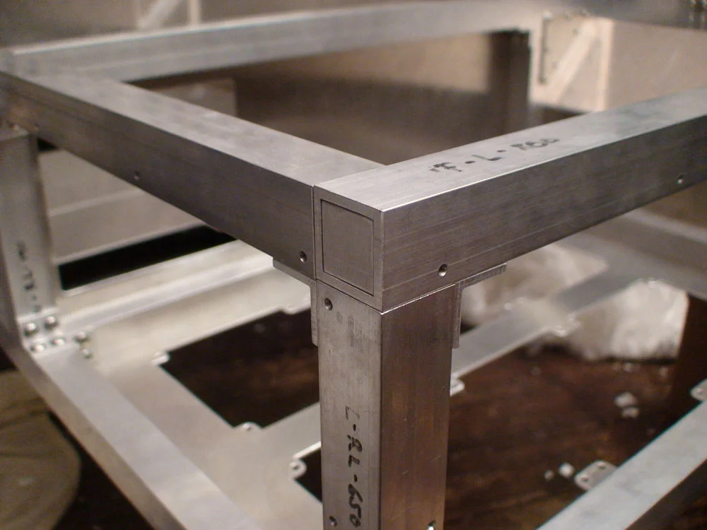

Right, back to the frame finished up the small angled sections so I could mount the panels to them...
and an attached leg...

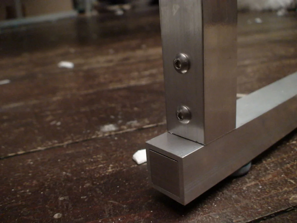

The end caps came out well too :)

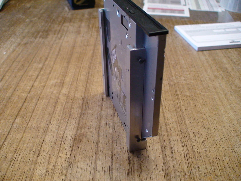

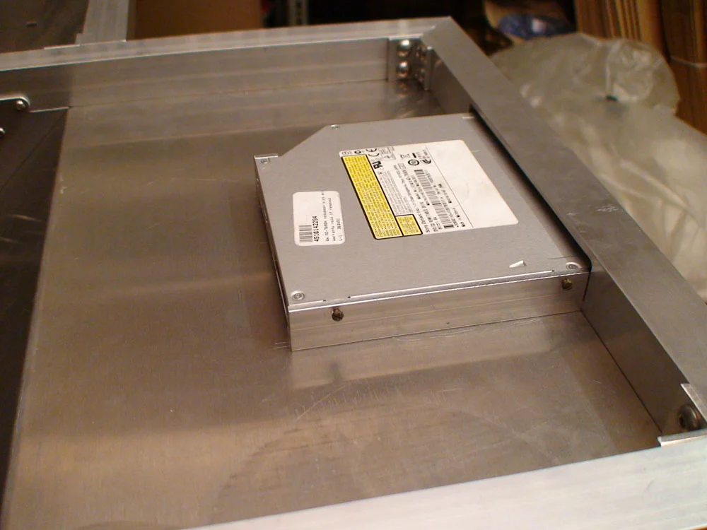

And back to the dvd drive...
That's all for now as far as the desk goes :) The screws holding the usbs and DVD drive are just ones I found that fit, I'm waiting on the new ones that match the rest of the desk :)
