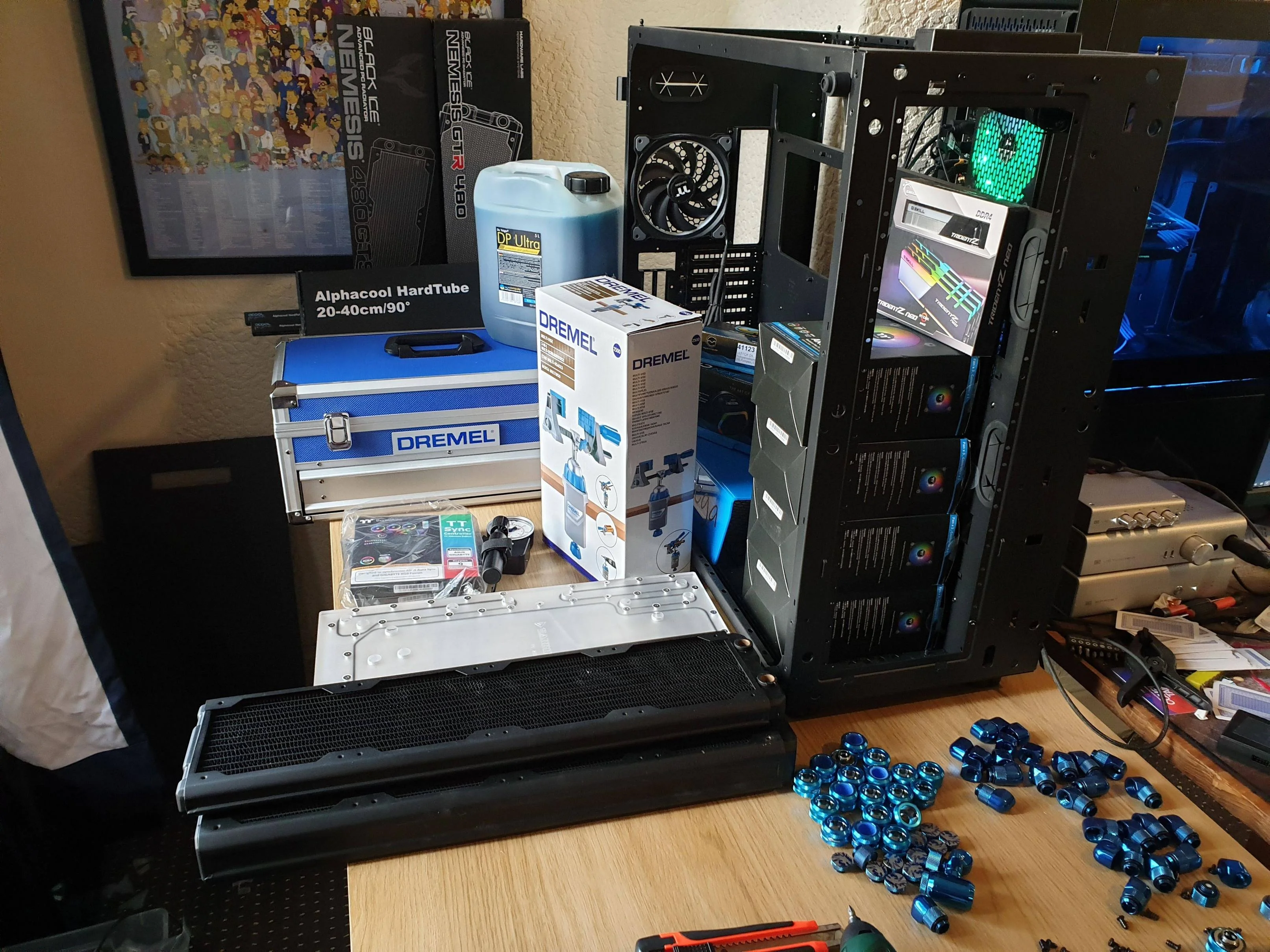

  • Case: Thermaltake View 91 . I fell in love with this the look of the case as ive not had tempered glass before and this case has everything I need in terms of space and hard drive capacity behind the tray. It can also take a distro plate and 2 480 rads with vertical GPU mount. Only downside to the case is a distro plate from Barrow/Bykski has never been made.
  • Cooling. This was by far the most expensive part not just for parts used in cooling but tools in order to make some parts.

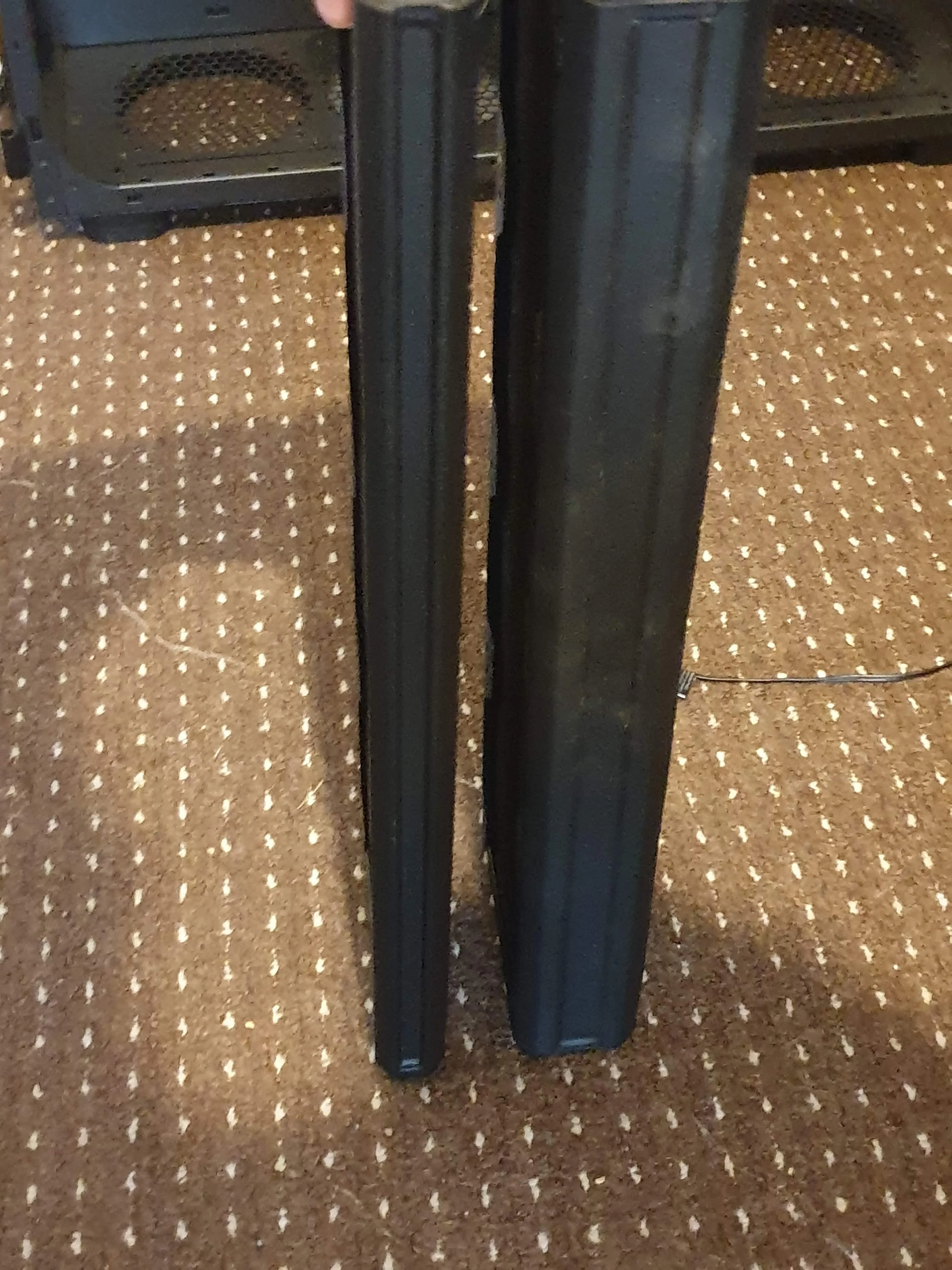

  1. Radiators: Hardware Labs GTR 480 in push pull as top rad and 480 GTS in front rad in push. Problem came out of how much space the distroplate needed to the side so had to buy a thin rad and I ended up mis-measuring it due to measuring it from the bracket holes to the front forgetting the plate is wider. Still fits though JUST!
  2. Tubing. Alphacool Hardline Glass. This is my greatest fear as ive never done a custom loop let alone a hardline one. I wasnt about to use soft tubing as it still needs cutting to length to look good in my opinion. Glass looks the best to me but jesus wept its expensive and costly to setup. I ordered a Dremel 4000 with a vice and a diamond cutting tool

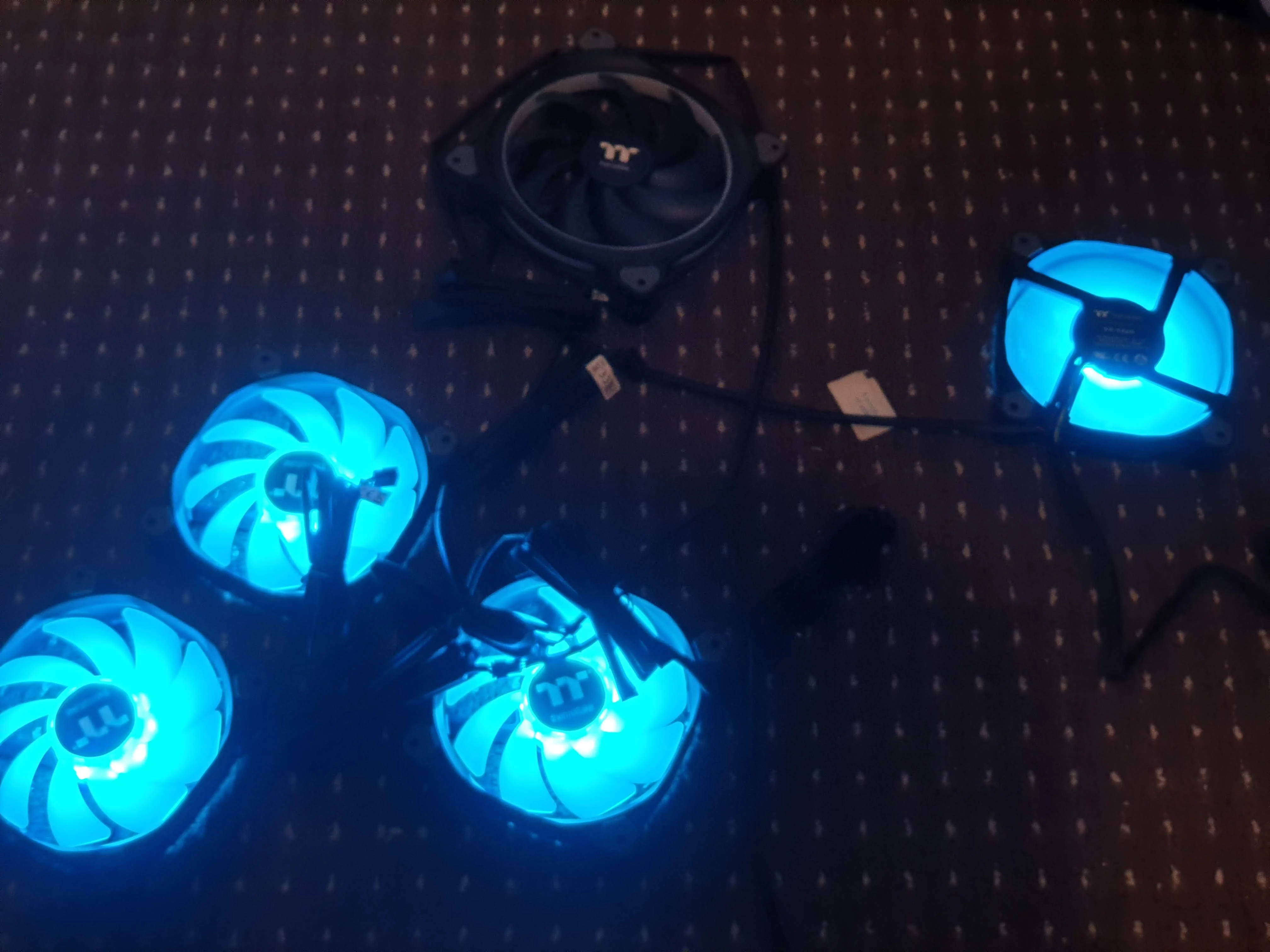

  3. Fans. Thermaltake Pure 12 ARGB x12. I was looking for a nice A/RGB fan and just came across these newly released fans and thought I'd keep to the same brand as the case for aesthetic purposes. The RPM is a little low for sheer quick heat extraction in Benchmark mode but Im hoping the sheer number of fans will make up for that

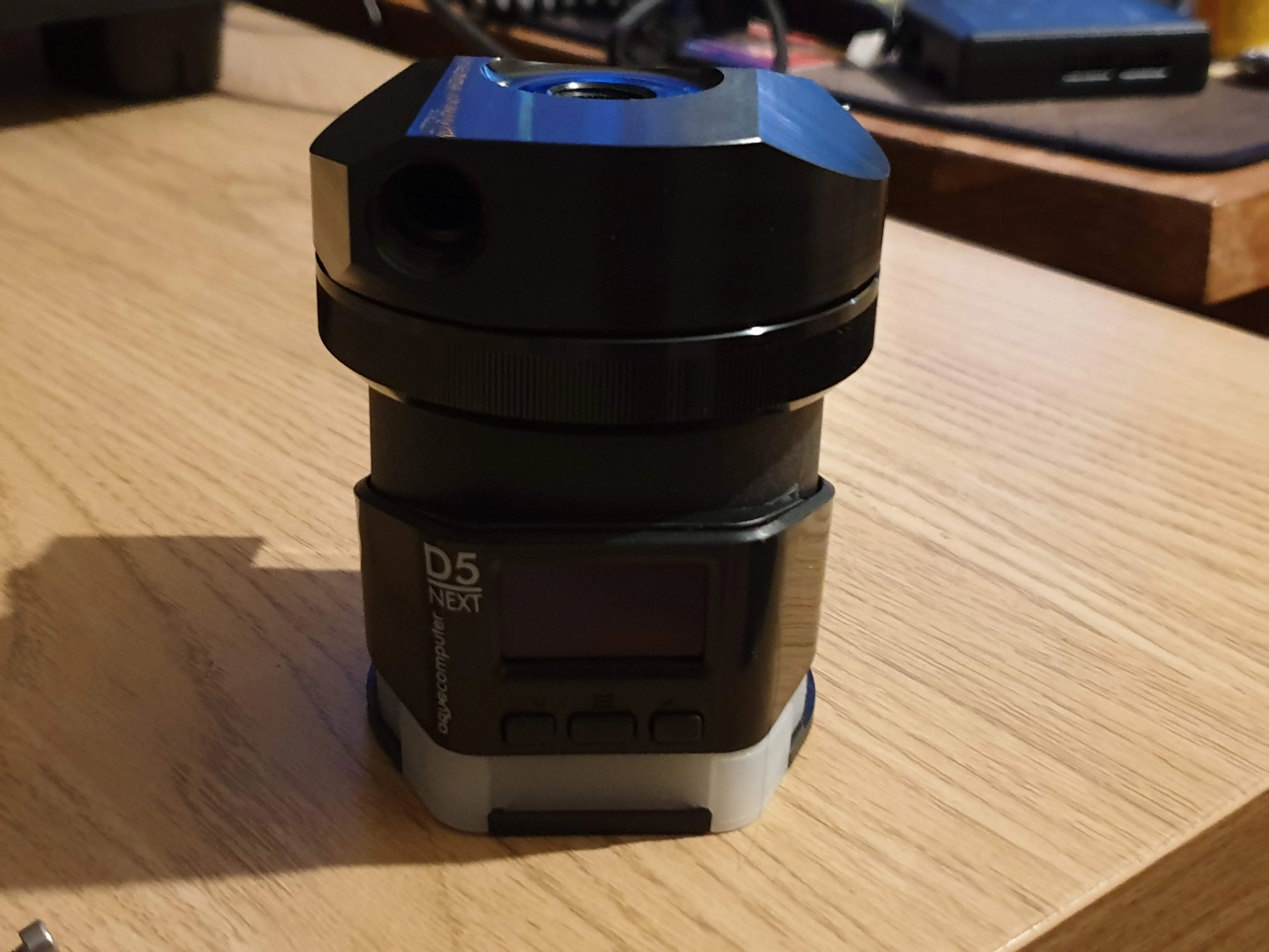

  4. Pump. Aquacomputer D5 Next RGB + Ultilitop. Saw this in a Alphacool build at computex and love the options its provides and information.

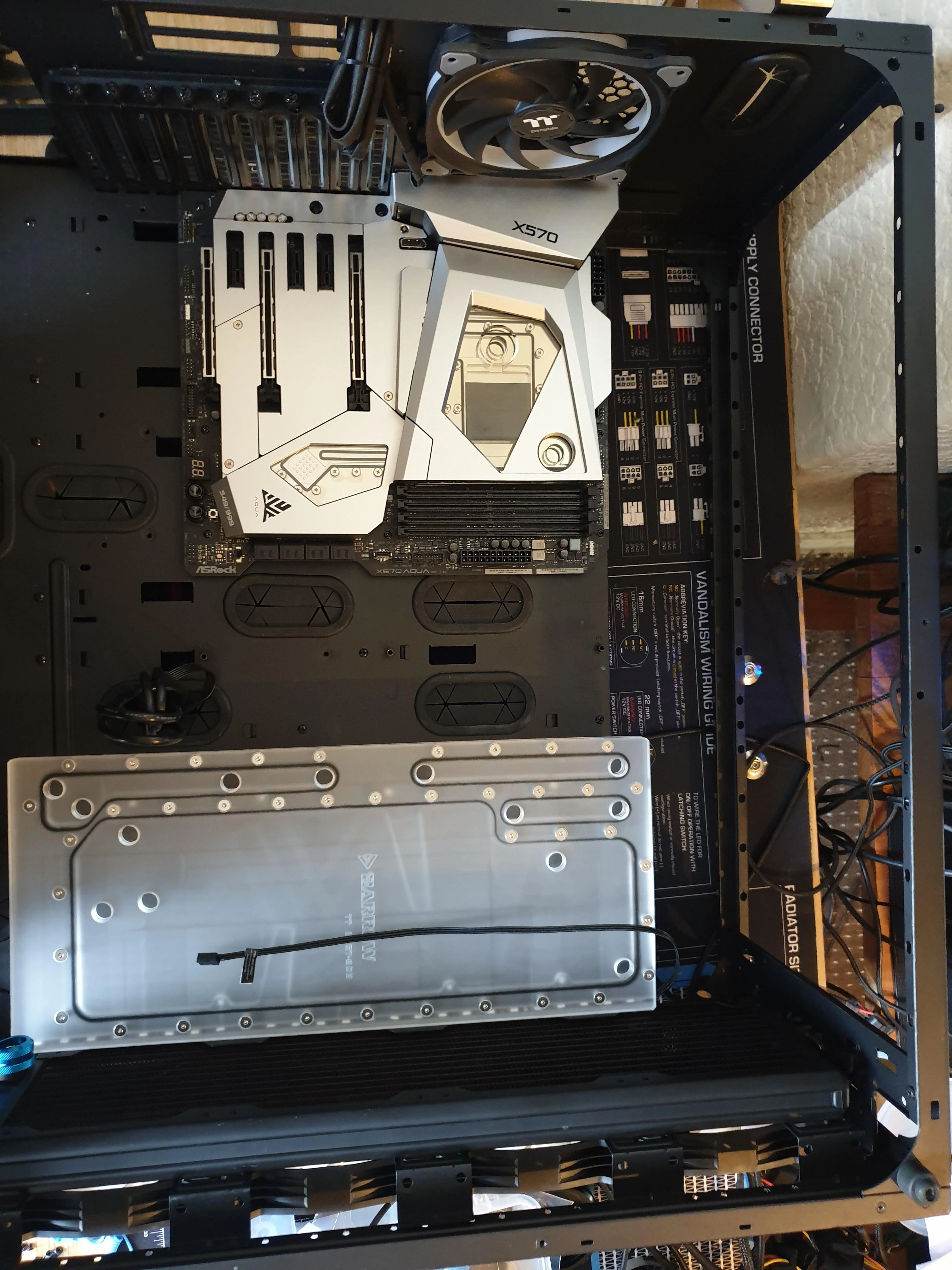

  5. Distroplate. This ended up being a problem as they do not make one for this case. I ended up going with a Thermaltake Level20 GT Distroplate made by Barrow as Bykski distroplates only run on their own DDC pumps and look bad with the thing sticking out of it.
  6. Coolant. Aquacomputer DP Ultra blue. A nice colour. I tried dyes with distilled water and couldnt get it looking quite right so happy to just have a spare 5 Litres of premix.

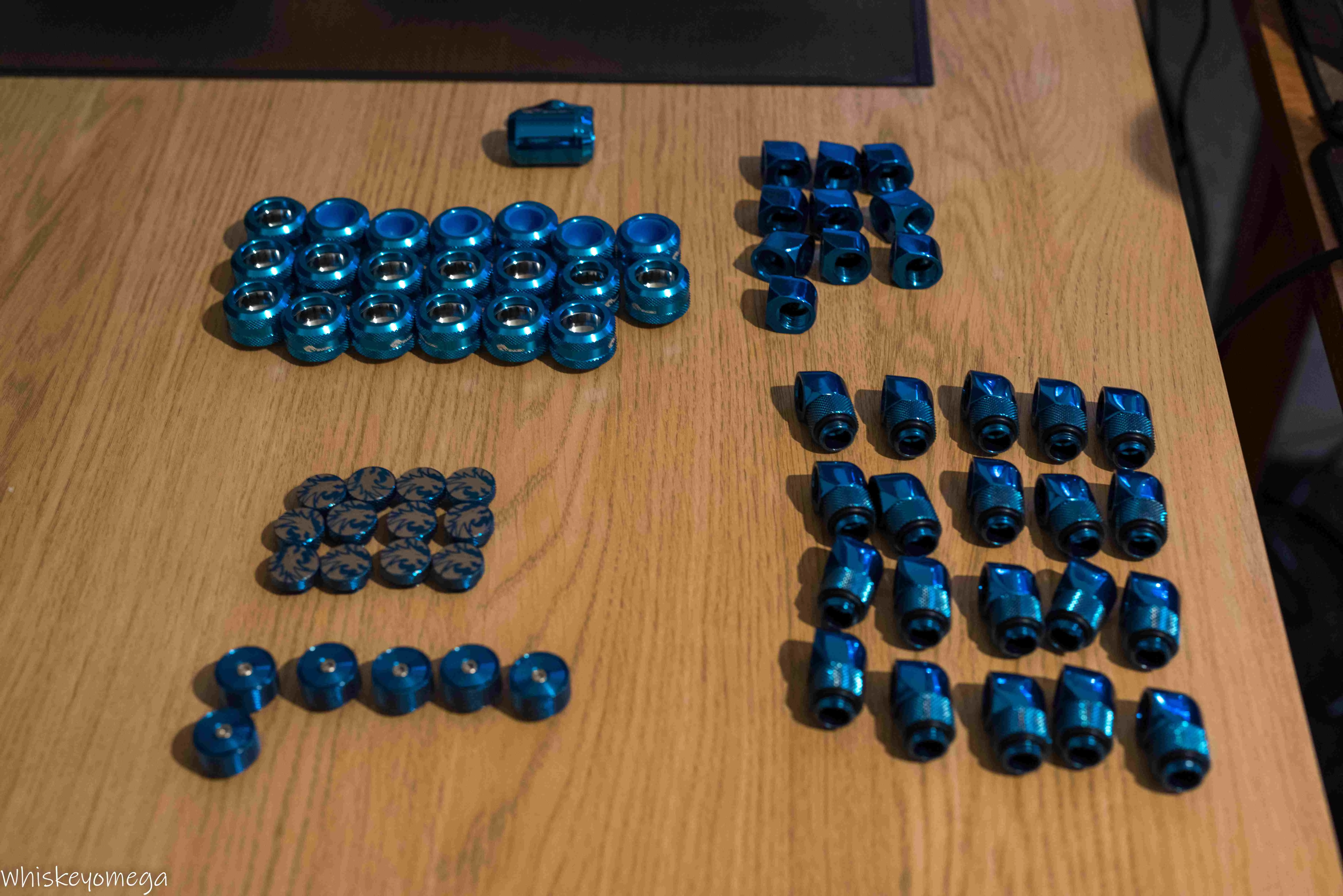

  7. Fittings. Bykski blue. Whilst at computex I was introduced to Bykski as Id never heard of them and they had an amazing array to show off .

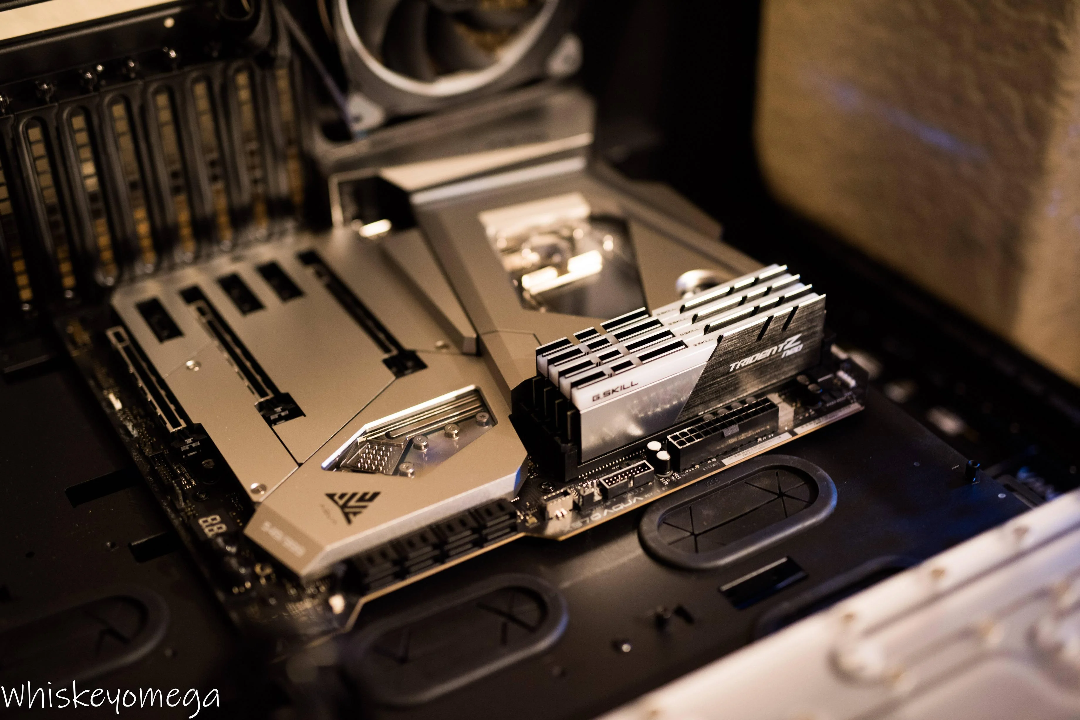

  • RAM Gskill Trident Z Neo 64GB 4x16 3600Mhz CL16. I Had to Import this from the US as no where in the UK is selling ram even cheaply or do they even have any AMD ram in stock.
Ill continue to update with pictures as I go along but ive bought so much already its tough to keep track of everything.

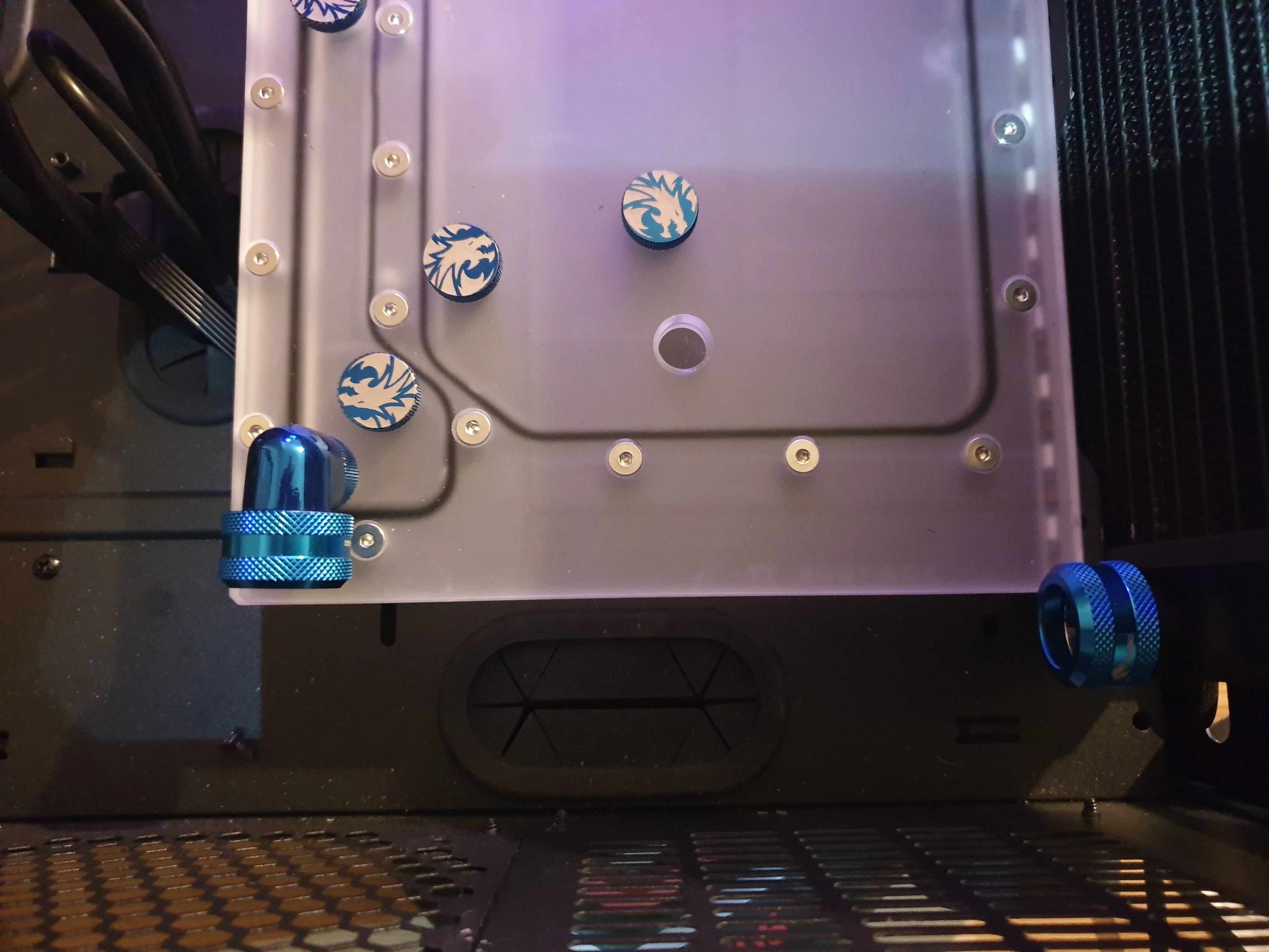

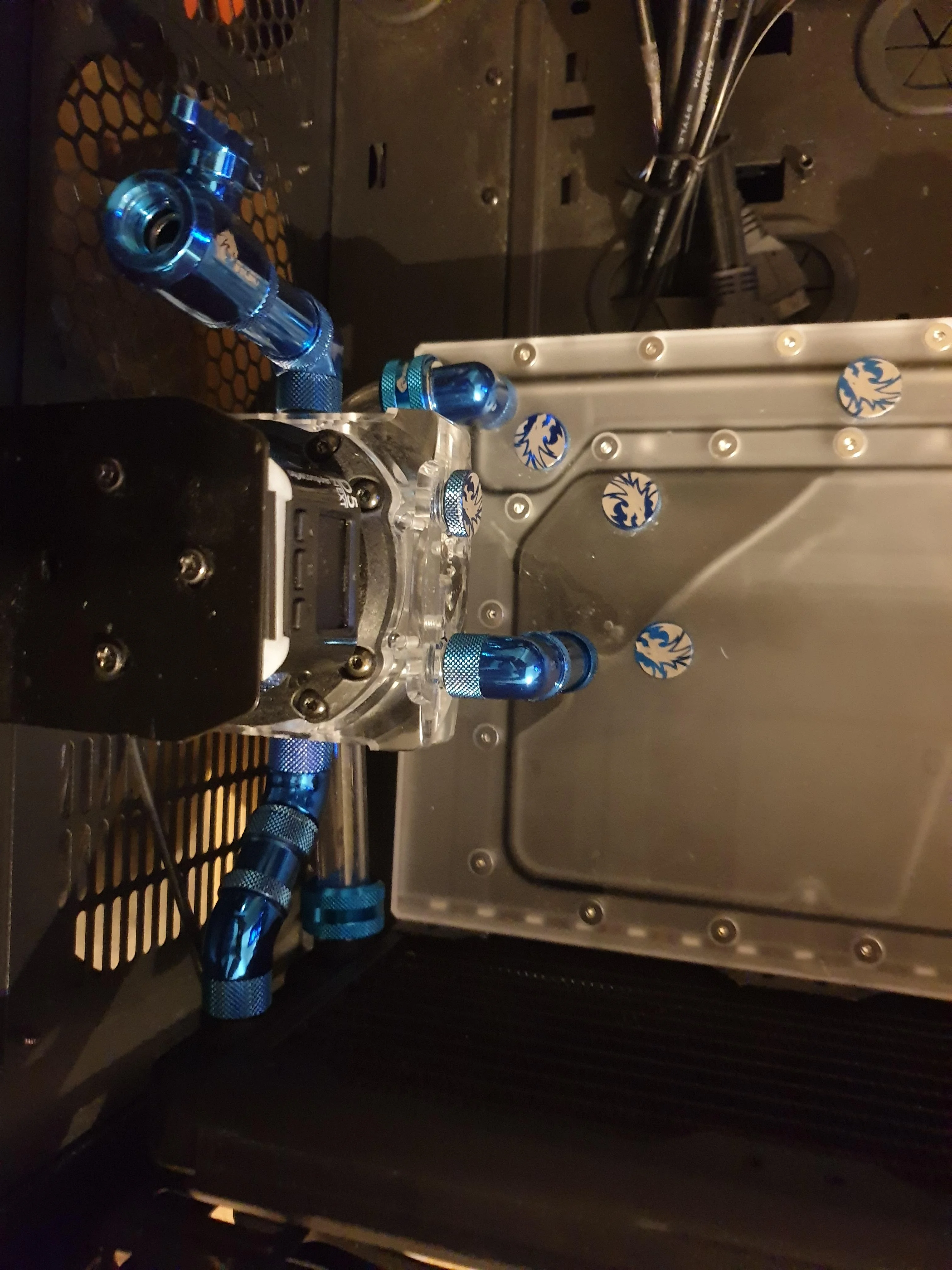

Got my bykski fitting extensions from aliexpress today and amazingly the top of the pump with a 90deg fitting in fits perfectly with it. OCUK really needs to supply bykski as they are very few and far between out side china. I know somewhere else nearby claims to be a stockist but they dont actually carry that much from the brand. Im actually going to buy the Alphacool Eisdecke D5 Top for my pump since it has more inputs and outputs and would give me options on the build as the bottom right is going to be messy for tubing and fittings.
Only noticed the last picture seems to have got weird in uploading this forum so ill upload it again here since its to do with the bykski fittings.

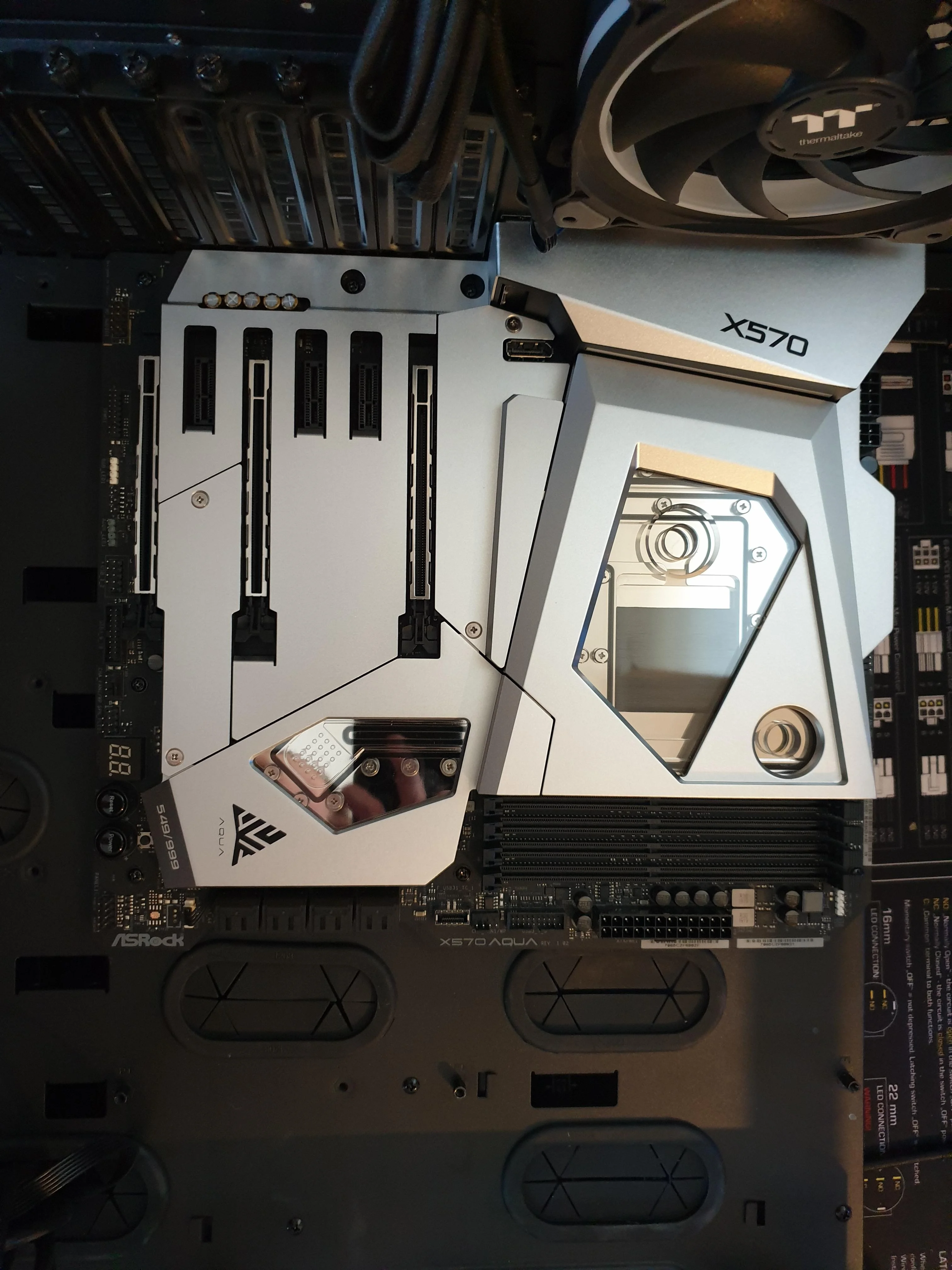

But yea the motherboard is fantastic. Im surprised there is nothing like this for X399

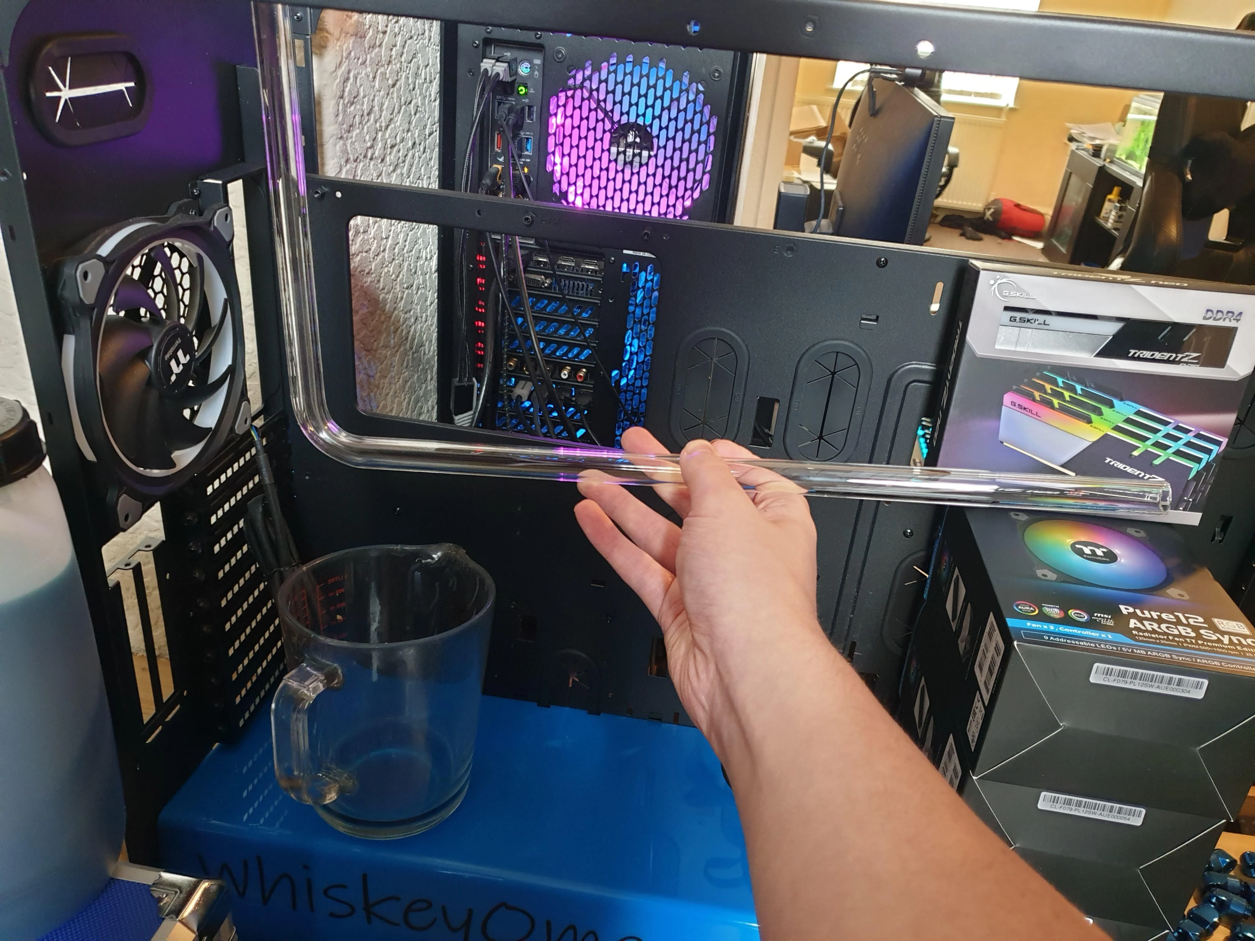

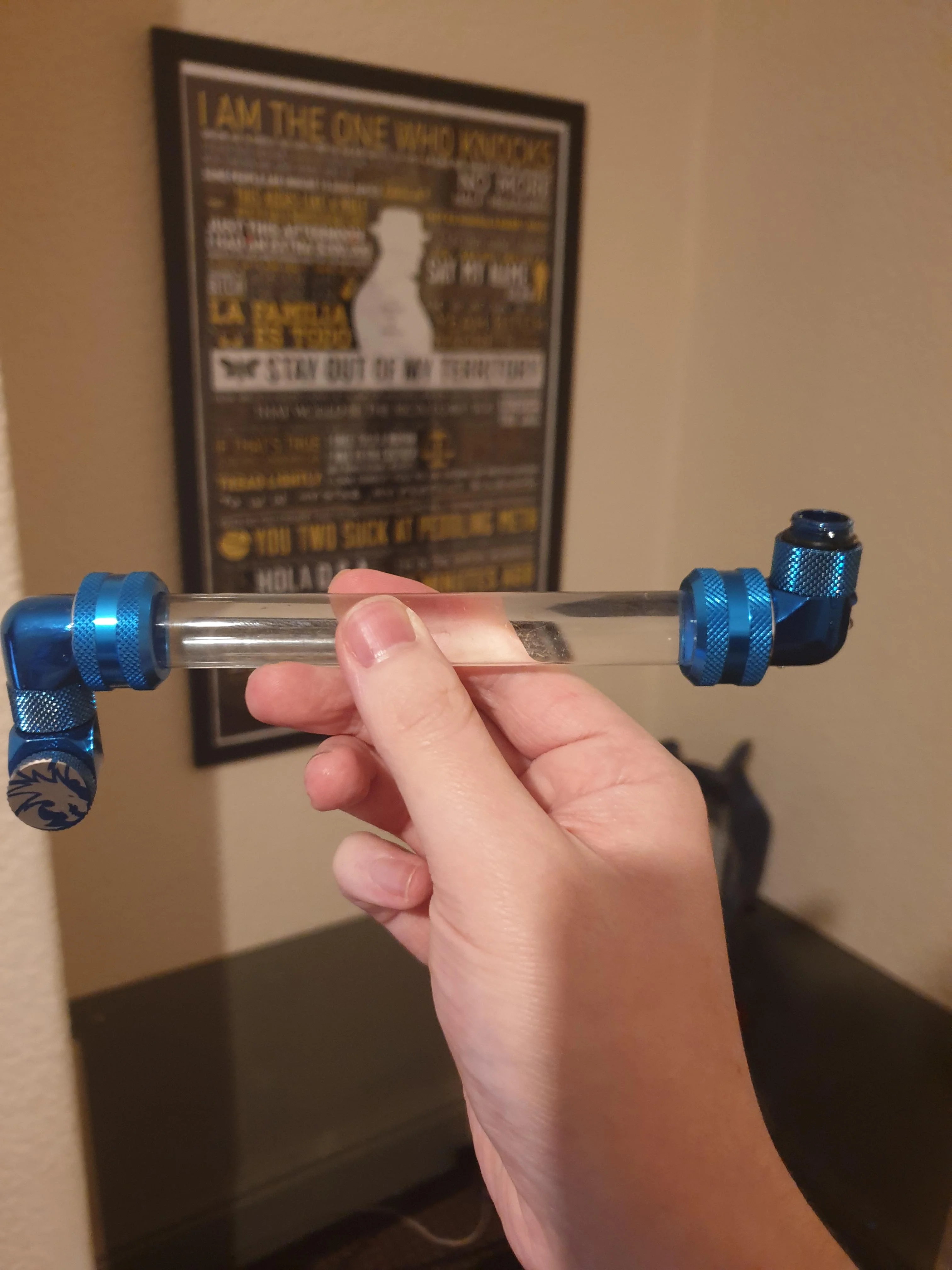

First Tube with compression fittings testing . There is water in there and its not leaking so i must be doing something right.
Think you need to pressurize it tbh to really test it out properly. I would blow into the open end as hard as you can to see it will come out from the fittings.
Tested it with the Dr Drop but yea. took that one apart for now to clean it. Still have to bend it for the temporary bridge on the distro plate.

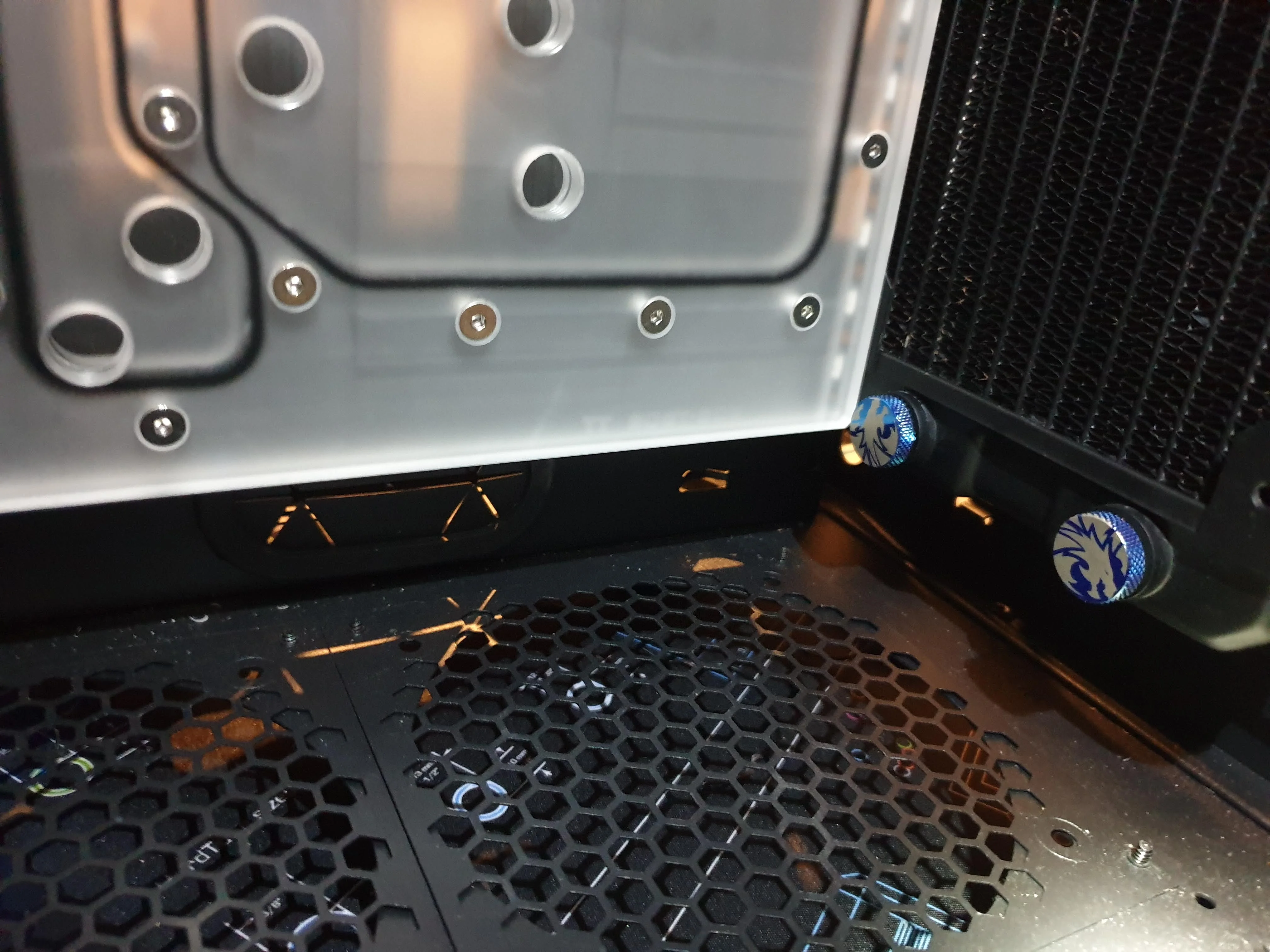

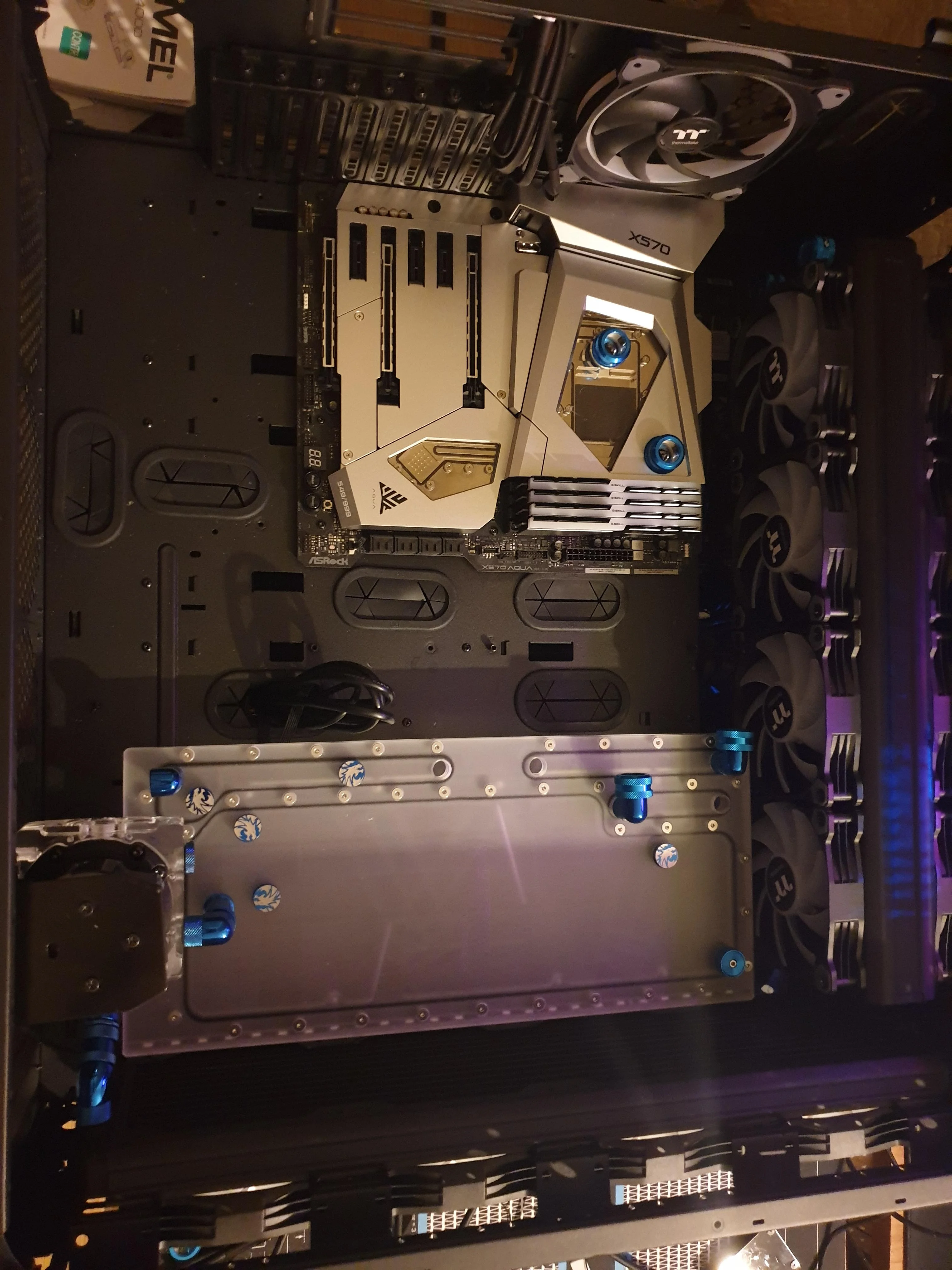

At the moment I am trying to figure out a bit of a puzzle that is the pumps in and out. Lowered the radiator and I think everything will fit with the pump on its side. It will also provide enough room for a run from the out of the front rad to the distro plate

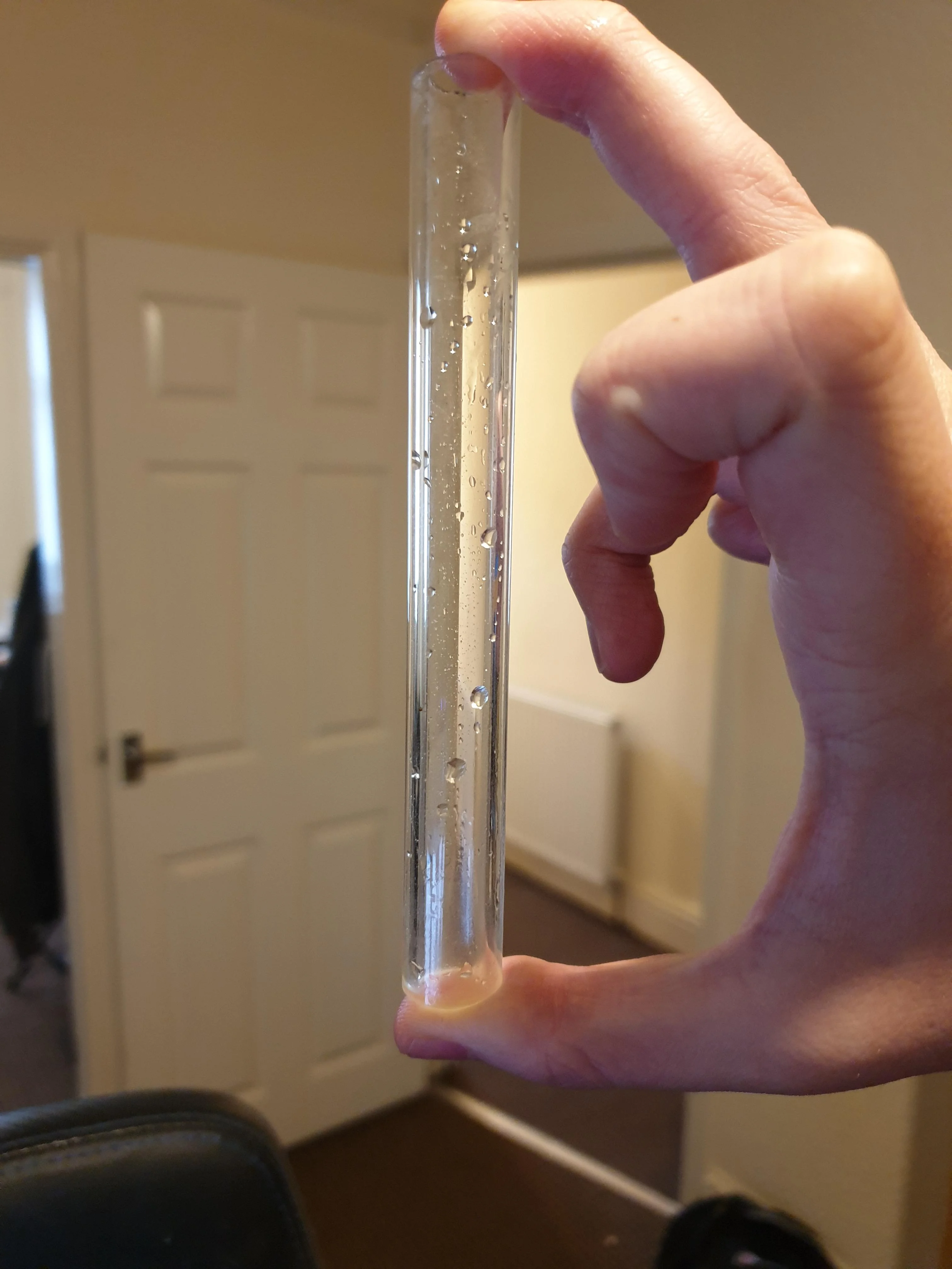

I think ive found the level of clean im looking for on these tubes now ive left this one in a pint of water/rubbing alcohol for a day or so after I managed to get some of the wondergrip gloves burnt on it.
