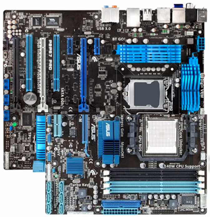

heres a comparison picture of the motherboard i think the guy has (asus P8P67 pro) against my one:
(i resized the individual pictures to make sure the RAM slots and PCIe x16 slots were the same length in both)
pretty big difference, but i should be fine.

You're absolutely right that the motherboard is P8P67 Pro - the thread I linked is of my current PC, was just being lazy and couldn't be bothered to re-post the pictures. :)
Looking at mine straight on, the Zalman covers three out of the six fins on the blue heatsink between the CPU socket and the nearest edge, so the gap is 3 heatsink fins and the "Digi+ VRM" writing. From your composit picture (nice job, by the way) you should definitely not overhang the edge of your motherboard, and so clear your PSU.
lol, i didnt even notice it was your PC.
thanks for the extra info, that puts my mind at rest, and also thanks for the compliment at the picture :)
